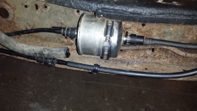

The fuel system for the truck starting at the tank is a warblo 225 lph pump. I had to modify the fuel pick up a little to get it to fit. Then while i was in there i had to cut the line for the factory in take fuel pressure regulator. If you don't do this your fuel pressure will be stuck at 70 psi. (ask me how i found out)
Moving forward out of the tank I used the two factory lines that would connect to the duel in, single out factory filter that comes on the pickups. I removed that filter and replaced it with a factory filter, that came on the older style trucks that had a return style fuel system. From there it got a little interesting. I used a combination of factory lines and fitting ends to get me to where i have the an lines. Looking back on it i think it would have been easier to just run the an lines at least back to the filter. O well live and learn.
The an lines carry the fuel up into the engine bay where the connect to a Aeromotive 13129 fuel pressure regulator. Then from there it goes into the factory 4.6 mustang fuel rail.

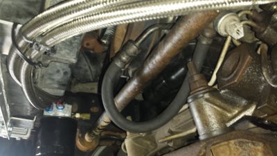

Next on the list was power steering lines. I used a 98 Lincoln mark 8 pump. No real particular reason. It appears that all or most of the 4.6 and 5.4 pumps are the same. But instead of a pressed in rear suction hose this mark 8 fitting was adjustable.
I used both of the ranger stock power steering hoses. The both hooked right up to the mark 8 pump. I also used a power steering reservoir off of a explorer... I think. I cant remember what i pulled it off of. But it has both the suction and return line on the bottom of the reservoir.
I used a relocation kit for the oil filter. I used the on 3 performance kit. It is used on their 2v turbo kits. I didn't like the barbed fittings and replaced them with some braided stainless steel lines from summit.
http://www.on3performance.com/shop/on-3-performance-2v-3v-4v-billet-oil-relocation-kit/
I also hooked the stock ranger oil pressure gauge into the relocation block. So now my factory gauge works.
This kit also moves the lower radiator hose closer to the factory location for the 05 up mustangs. I tried a 03 crown vic lower neck and the mark 8 lower neck but both of those ran into the upper control arm mount.
I then mounted the factory ranger temp sender/switch in left hand side of the 4.6 block. I removed the the factory screw in plug. And Threaded the factory ranger sender right in.

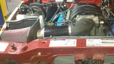

Then i went on to mount the computer. I built a braket out of aluminium and used the factory holes that mount the air box on the stock ranger set up to hold it in place.
I then decided to build a cold air intake box for my JLT 110 set up. This intake on a mustang would turn to the drivers side. But because of the way the intake is built it can be easily flipped. So now it turns to the passenger side. This is because the battery is in the way on the ranger. And so now i needed to make a intake box for it to help keep that air cool. Other wise whats the point of a cold air intake.
So it started with a plastic tool box that i cut into pieces. Then put a big hole in the one end to fit the tube in and then put some rubber weatherstrip on the edges that seal up against the hood and on the inner edges of the box. There is also a stamping in the ranger inner structure that i cut along the edges to help it pull more air in from the fender area.
