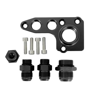

What route do you plan on taking with the steering box?
This is the clearance dlibson had without the ps pump and water neck/oil filter mount bolted to the block. There might not even be room for the aftermarket piece BigBlockRanger posted.
My 4.6 swap starts
This might help.
My 4.6 swap starts
What is this piece everyone keeps posting? looks like something that would go on the water neck
Edit: nevermind found pics of it online, looks like this might be the route I have to go
Here is how it works for those who don't know, like me about 5 minutes ago. This one is from livernoismotorsports.com
My 4.6 swap starts
I don't know if dlibson's engine is centered in the frame or offset to one side. I would offset the engine to the pass side a smooch and use the Moroso one. It would probably be easier to fit than the livernois one. Crap, if you can fab worth a darn, just make one that has the outlet pointing straight down. Wouldn't be too hard at all.

Yea, my motor is going as far over as possible and up as far as possible (heater box should be fun), I dont care if I have to make a 2" cowl hood for clearance. I really dont wanna run a nissan box and fubar the steering linkage up more than it already is. The only way I would run a nissan box is if I was doing a SAS with a EB d44, but I want to keep the d35. and yes I would run the moroso one, I might just make one, I have a mill and tig at my disposal. :icon_welder:. I need to find out how to fool the DPFE and maybe EGR to get more clearance, maybe have the PCM burned to remove the auto trans functions, dpfe, and egr tables? anyone have any info about that?

Hey all, haven't posted up in a while, progress has been made in the ranger, motor, transmission, and t-case all fit and are mounted up, I got past the steering box issue with this:
My 4.6 swap starts
its a -16 o-ring 90 with a 45* -16 on it, clears the box by a full inch, just got the radiator the other day, along with the centerforce pressureplate, luk disc, new slave, pilot, throwout, flywheel, more pictures tomorrow. :beer:
