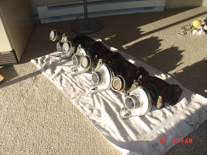

Yeah i would actually like moving up to a T3 with a .63 turbine housing. It will be less restrictive at higher boost levels and rpms. I know all about the Te04h 13cs they don't use the same housings they have have tiny .38 ar housings. The scrolls are half the size of a chrysler T3. Im using 4 Te04hs on my 4.6L project. And you can clock the the mitsubishi turbos you just grind off the dowel pins.

So time to upgrade a little as you ca nsee Im adding another turbo to the hotside. Im keeping it simple all Im doing is boring a hole and adding a second t3 to the hotside. tap and run oil lines change the cold side a little bit and it should be good to go. This was just another t3 that was laying around. It should be up and running tomorrow sunday at the latest.:icon_welder:
Wow!
That's by far the ugliest TT setup I've ever seen!
But still freakin' awesome.
Yep ugly but once the hood closes who cares its a beater rig. I shouldnt lose much spool time and using two will be alot less restrictive than a 4cyl turbo on a large displacement V6
