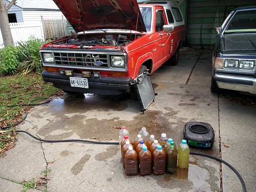

Drained the rad flush/water mix. What came out was super gross, and since the rad was clean due to the 2.0 having been a clean engine inside and rad being new, that means the block was gross. Glad I flushed it.
After draining, I ran hose water (yeah, yeah, I know) through the block, as well as thoroughly in both directions through the rad and heater core until nothing but clear water ran out. Hooked it all back up, filled with a full jug of concentrate plus the balance in distilled water and that should be that (capacity looked like 6.8L, jug of concentrate 3.78). Installed correct lower rad hose at the time (application: 95 Ranger 2.3 due to extension pipe at bottom of water pump)

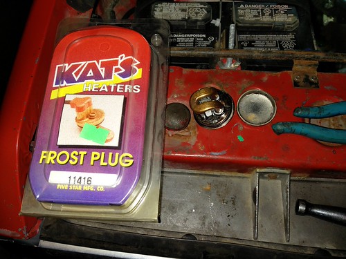

Block heater is in. Block heater appears not to leak. I have not tested that it actually works yet, and am hoping that it will. Amazon will be delivering a remote control on/off thing which I'm going to use for it. I had to slightly bend the element on the block heater for it to go in flush in that location. The instructions did not specify a location or clocking because this isn't "for" a Ranger according to the instruction sheet...but the same heater is for a Ranger according to Amazon and eBay listings...shrug. It fit with some minor tweaking, I'll call that good enough.

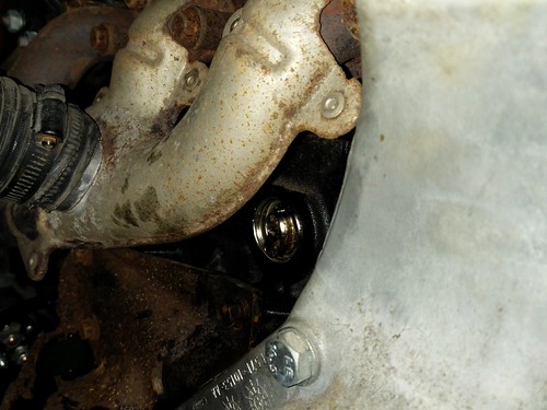

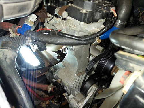

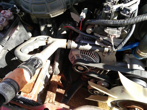

Discovered I was down quite a bit of coolant prior to leaving the meet, investigated further at my friend's house. Found the alternator and passenger frame rail saturated with coolant but block heater was bone dry. Traced it back to a poorly sealed hose on the 'Tee' for the coolant temp sensor. Easily fixed. It may have sprung a leak due to manhandling while putting in the block heater.

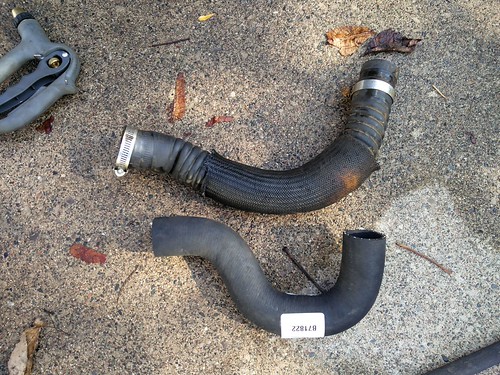

In fixing that, discovered a heater hose is rubbing on the O2 connector and would pinhole through soon. Covered that with split loom and will prioritize new heater hose soon. I just got a bunch of new hose out of a car's trunk at the junkyard.
