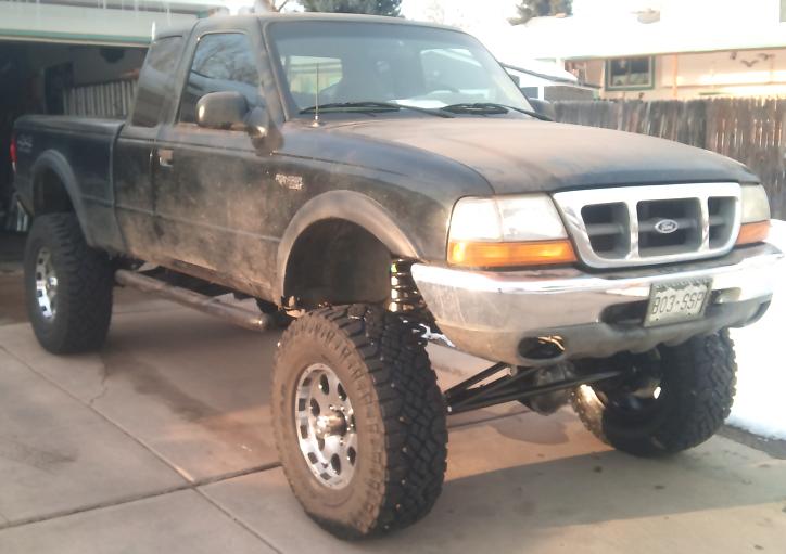

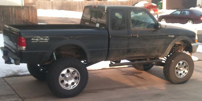

:yahoo:1, 2, skip a few 99, 100! Here it is finally done!:yahoo: The front coils I got are too stiff so I have to buy new ones. (dont get your coils from coil spring specialties:annoyed: ) but other than that it is done. Let me know if you have any questions about specific items. I am too lazy to put them up right now.

That a is a very sharp truck u got their. Look very good!
Have u driven it yet? Any more pics.

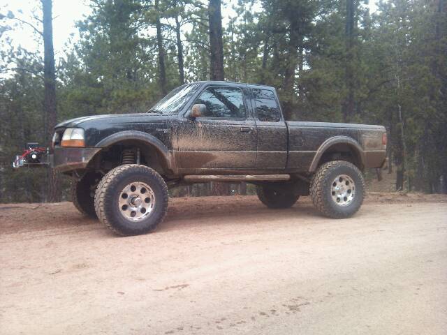

So Eric did you get to take it out wheeling? If so how did it do. Sorry I did not get to stick around, had to take my wife out to dinner for V Day.
I have been driving it around and have taken it offroad. I had the first set of springs I bought which were way too stiff. I have since put new lower rate springs on and it rides a lot better. Anybody out there doing this swap dont get a spring over 300# and dont get them from coil spring specialties. I went with the Deaver superflex 4" lift spring. I am going out again on the 18th. I will let you know how it does. Were you able to get your steering box thing figured out? Oh by the way that first nut that guy showed us at a Ace was the right one. I took my steering apart and took the piece down there. FYI Napa doesn't carry metric castle nuts. I will try to get more pics next time I take it out.

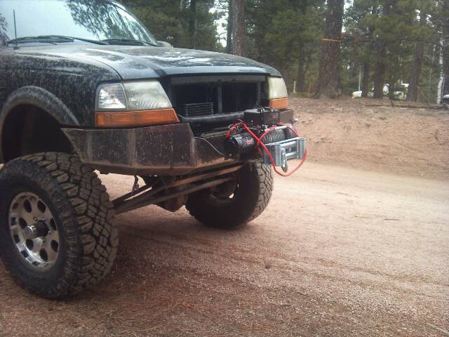

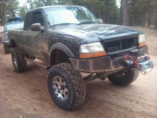

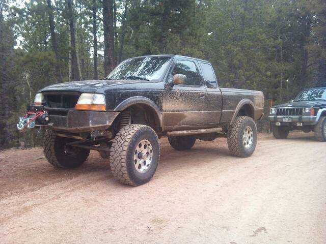

I have been working on the bumper, I picked up a XRC8 from Smittybilt. I decided to go with a reciever style winch setup. Here are some pics of the truck after I took it out today with the partially completed bumper with the winch receiver plate installed.

Looks good so Far!
Looks real good.

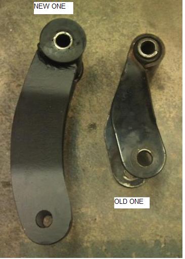

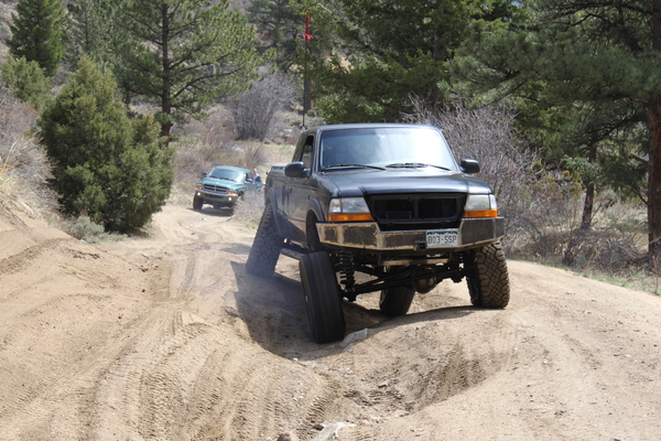

So, I made these...:icon_welder:
Now I can do this...:icon_hornsup::icon_cheers:
Now I need to get the limited slip carrier in the front so I wont lose traction like that.
1freaky1 let me know when you want to go wheeling.
