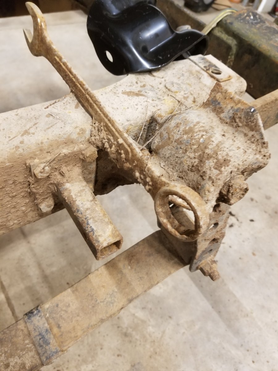

Back when I first lifted the '90 I made some removable mudflaps as I didn't want attention... I went to the steel yard and got some small square tubing that fit inside eachother and made like 4x4 plates for the frame side to be bolted on as shown in this picture:

You'll also notice my failed trail fix from like 4 years before that... :). From there I made an L to go in that and go down under the rear fender and made a cross bar with the same tubing to center the flap behind the rear tires like this:

The picture is deceptive, they sit maybe 1/2" under the sheet metal. I made the flaps themselves out of 1/2 of a semi mud flap, held to the tube with 3 or 4 1/4" bolts.
