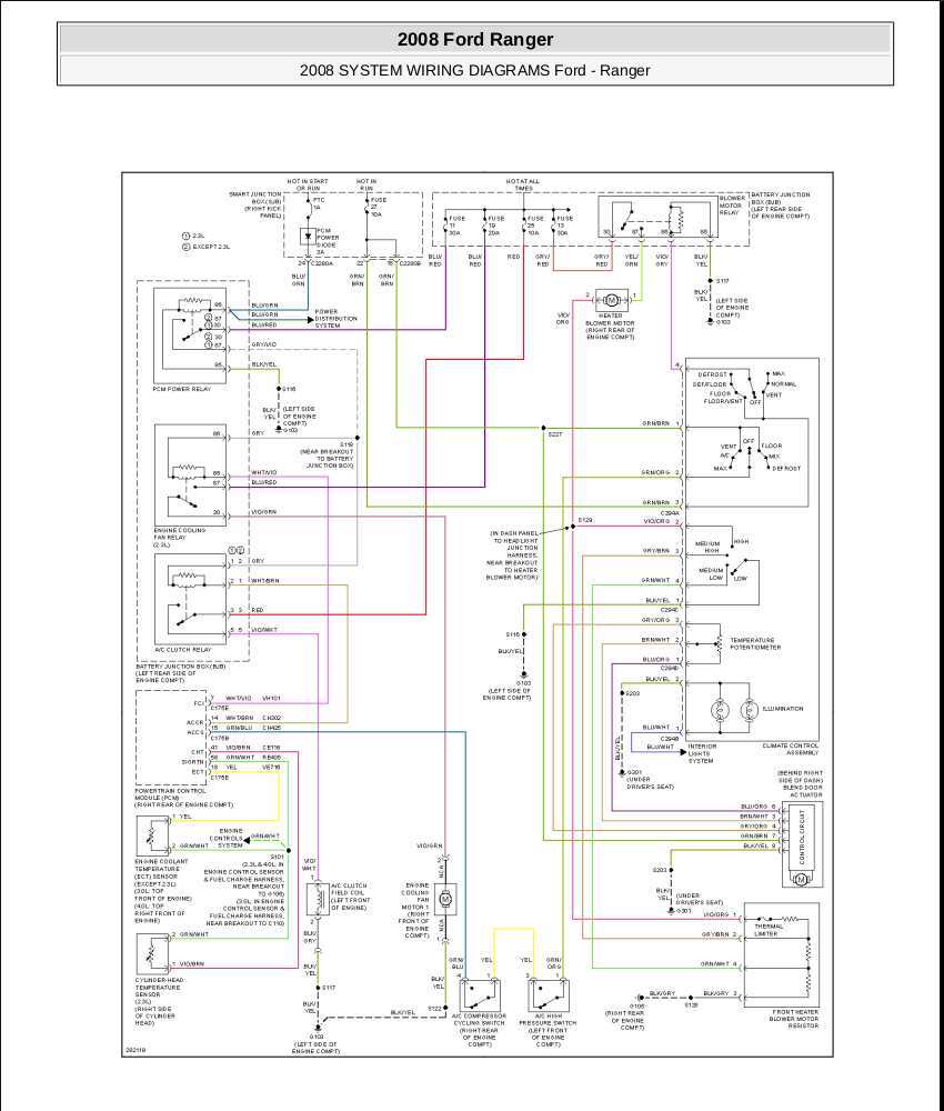

The wiring diagrams are likely correct in terms of point-to-point wiring, but what is shown withing the boxes representing switches and other devices is best considered an artistic rendering. It's not always useful for troubleshooting. Mine is a 2004, and I have diagrams for 2002, 2005 and 2008. The 2002 and 2005 don't show the floor/vent position at all and the 2008 shows the AC engaged for all modes but "off". So I pulled mine apart.

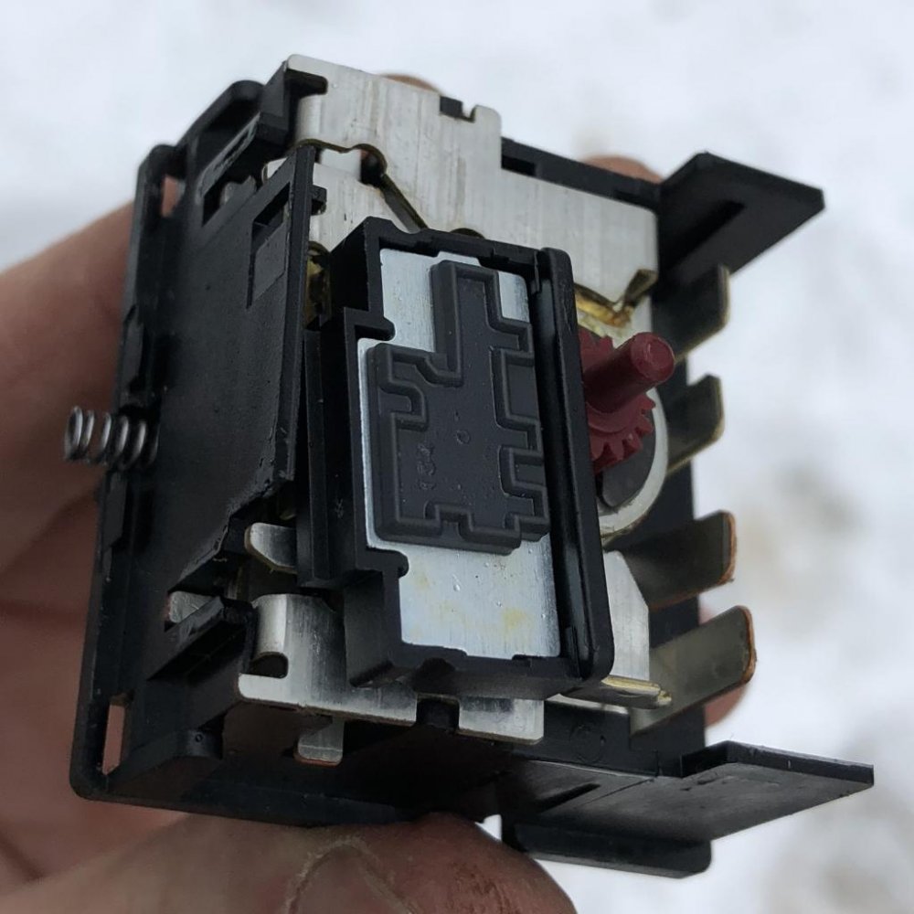

On my 2004 the AC clutch is energized for both AC and DEFROST modes, as well as FLOOR/VENT. It is off for FLOOR and VENT, as well as OFF. I thought about disabling the AC for the FLOOR/DEFROST mode but decided to leave that alone, and just disabled it on the FLOOR/VENT mode. Taking the HVAC unit out was pretty easy, but taking the mode control out is not for the faint of heart. Note the detent spring and ball behind it that can easily get lost. Also, there is a sliding vacuum control valve moved by the gear, and that must be phased properly on reassembly.
To disable the AC on FLOOR/VENT I cleaned off that one spar with brake clean and applied some thin Kapton tape over it. That is a tough resistive tape with a good adhesive used in electronics manufacturing, which was suitable for this, but there are probably other tapes or ways to insulate it. Now when the wiper hits that spot it will not make contact and the AC won't turn on. I reapplied some silicone grease and put it back together - had to replace a bulb too. Everything worked well. Since I use FLOOR/VENT and FLOOR most often I'm hoping I may see some mileage improvement.

I don't see a wiring connection between Blend Door motor and AC selector, so temp control should still work IF heater core is still getting hot coolant
There is one on the wiring diagram I have for a 2008, but not the one for my 2004 - the problem is that my 2004 actually has the same setup shown for 2008. Apparently they just didn't get around to updating the drawings for a few years!
The blend door motor is toward the lower right:
No connection, just has the 3 variable resistor wires from temp control knob
And a 12v and ground wire
So should work the same in any setting on the AC control
Looks like the same wiring back to 1995 when Blend door went electric

I know that is what it shows, but don't take it too seriously. I have found that these wiring diagrams are decently correct when it comes to the connections between devices - the harness essentially - but what is shown within the devices is conceptual at best. And often simply wrong. I don't know if it does or doesn't disable the temp control on Max AC, but I would not be surprised. That's the intention of the setting.
