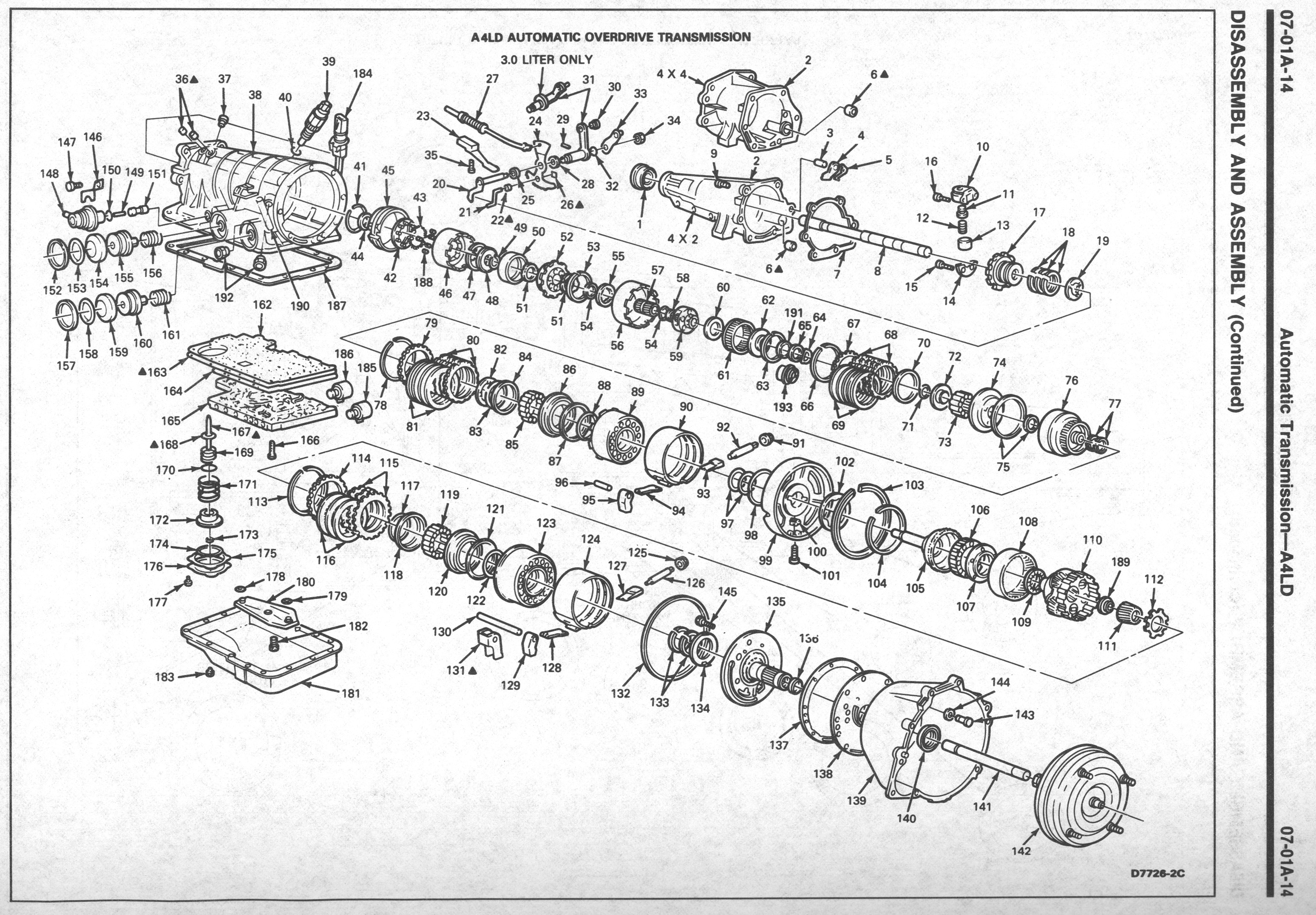

If I remember right you have an A4LD in that, and the pump comes off with the bellhousing, and you need a special pump alignment tool to reinstall it. you might also have to change out the top shim for proper clearance to the new pump. But it has been a while since transmissions class when we rebuilt one, so hopefully someone else can put in a second opinion.

IF memory serves the input shaft ( shaft that runs from the TC through the trans pump shaft ) is removable by hand. That's no biggie at all that it came out. Its made to.

If the input shaft wont seat all the way in the transmission when you try to reinstall every thing again then the OD planets the shaft seats into may be twisted a bit.
Use a pair of vise grips ( align the teeth on the grips with the splines on the shaft ) and give her a couple gentle taps with a hammer on the vise grips until it slides in.
