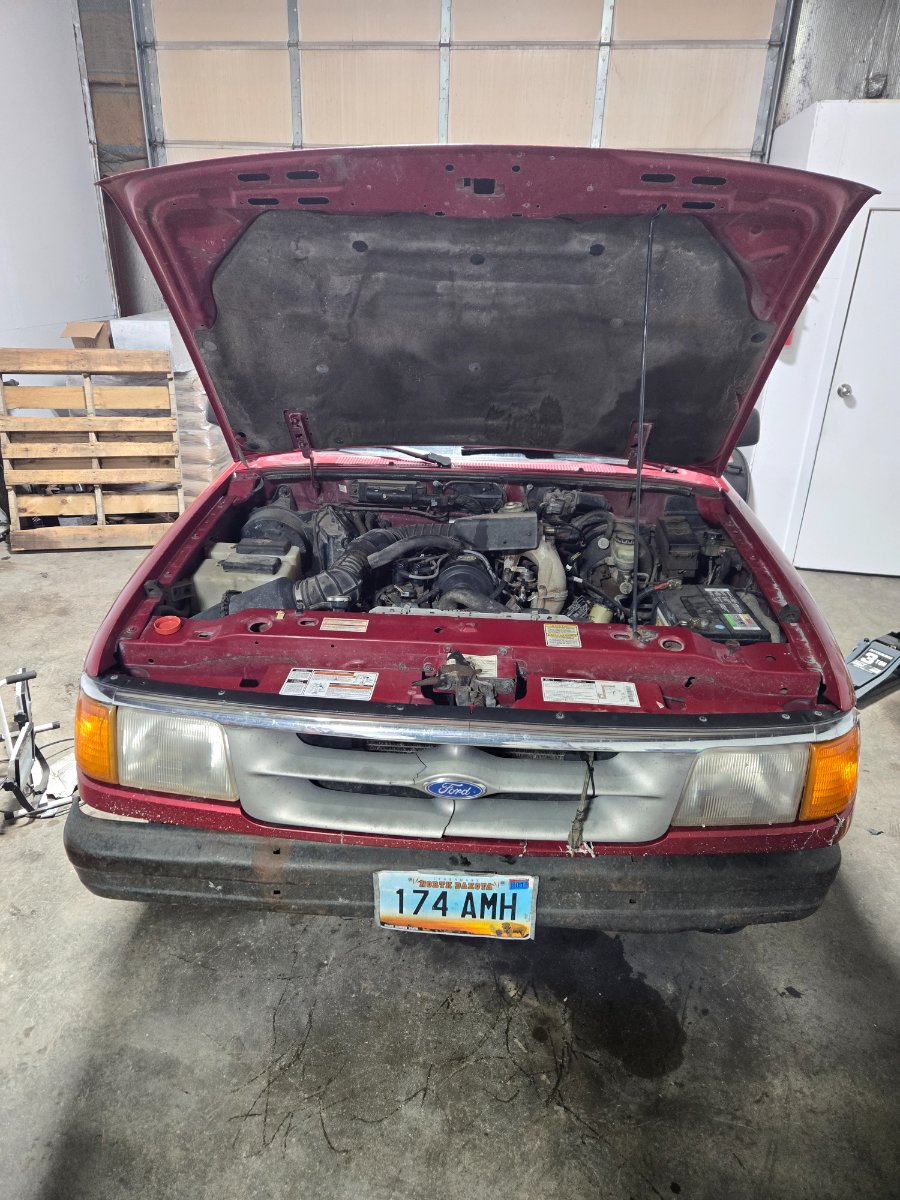

Thanks for the help. Engine is in and almost ready to start. Couldn't get a new upper radiator hose and bought the wrong oil filter. DUH! I dont trust my memory since my accident but I happened to have been right but online search was wrong. LOL.
Its already to go, hopefully by Wednesday night.
Nice, same color as my '97 even...
I like that they still stuck with the FL1A/PH8A or whatever variants, easy to find at garage/estate sales sometimes too...
