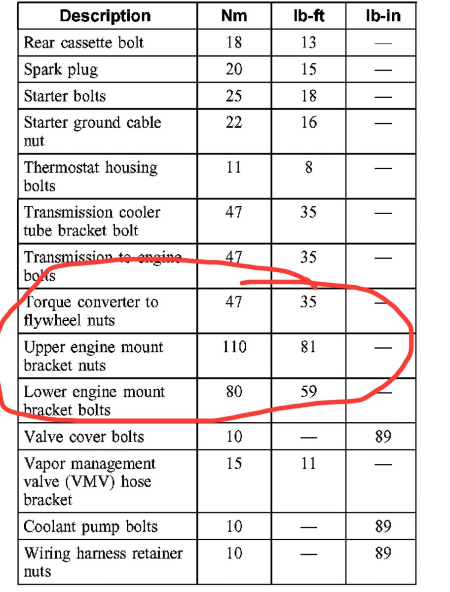

Hello again everyone,
I’m struggling to find the torque specs for the bolts that go from the motor mount bracket to the block on the engine, as well as the nuts that go from the motor mount bracket to the motor mount itself. Maybe I’m not understanding the terminology of when I’m looking it up but it’s saying there’s like an upper and a lower torque spec, see photo
Motor mount bracket torque spec
I torqued the bolts that go from the motor mount bracket to the block to 45 ft-lbs because that seemed like a good number and I didn’t want to strip/or snap the bolts and I just put the nuts that secure the motor mount brackets to the motor mounts on until they were snug, but I would ideally like a torque spec for those, lemme know if these are the right torque specs because the photo says lower engine mount bracket bolts but the bracket connects to the motor mounts with nuts and the upper engine mount bracket uses bolts to secure it to the engine block, not nuts, so I’m just confused, lemme know if you can point me in the right direction, thank you!

Aren't both parts of the mounts on the 4.0 nuts? So the only bolts would be the ones from the bracket to the block.
You probably already know this, but there are "standard" torque specs based on the thread diameter and pitch if you can't find a manufacturer specs.
