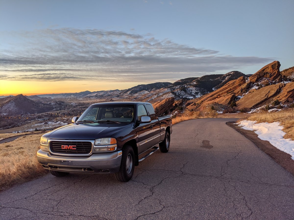

I ended up buying this. She's got some miles (170k) on her, but is in very nice shape. All optioned out, it's a cowboy Cadillac compared to the Rangers I looked at. Very luxurious for the year. 5.3l v8, push button 4x4, leather, heated seats, all that jazz. I'll probably keep the 93 c1500 for work and drive this as a personal vehicle. Wish me luck!
