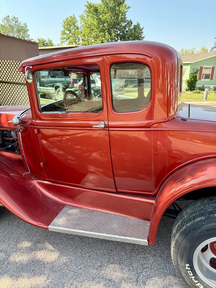

I don't know how long this link will stay valid but I was very intrigued by this build that happens to be in my area.
Allegedly it was built with 1975 parts but I'm guessing he meant 1985 based on the steering wheel, gauges, etc. Looks like it got hit in the front. The bumper, license plate, hood and radiator surround are kinda bunged up. Driver's door is obviously not lined up right/not closing correctly.
The body work and a lot of the custom parts look awesome. I would like to meet the builder and see why there was so much time spent on paint and wood trim but then the ripped up seats and Ford carpet were reused... why is there a whole AC HVAC plenum in the trunk but no AC compressor... why does it look like the majority of the smog junk was left intact instead of a Duraspark swap? Why cut corners and re-use a 40 year old upper radiator hose that is also kinked? I'm sure I could nit pick more but aside from my complaints, it IS a very cool build and incredibly unique. Has to be one of not very many 4x4 Model A's, and it is for sure a great start to a very cool rig that really just needs a lot of little details ironed out.

The only thing better than the shiploads of effort they put keeping the factory cluster is relocating the BII's HVAC box to the trunk. :shok:
I wonder if the axles are geared so the 4wd will still work with staggered tires...

I kind of doubt it but who knows. Why would you know to do that if you didn't know that a Duraspark swap is stupid easy...that type of deal... seems like maybe some "I didn't know better" or project fatigue set in. I'm trying not to be too critical, I would drive the wheels off that thing 7 days a week and twice on Sunday.
I can't tell but I'm curious if it's a steel body or fiberglass. Looks like the hood, trunk, doors, maybe the fenders are steel for sure.
I don't see a lot of the emissions garbage that would have been on the fender... but with the guys dedication at relocating thingss (like the charcoal canister behind the dizzy) that doesn't mean a whole lot. There may have been some aftermarket ignition back in the day that was e-coil friendly too.
It smells like a pre internet build or an older fellow that wasn't internet savvy and just kitbashed with what he had.
