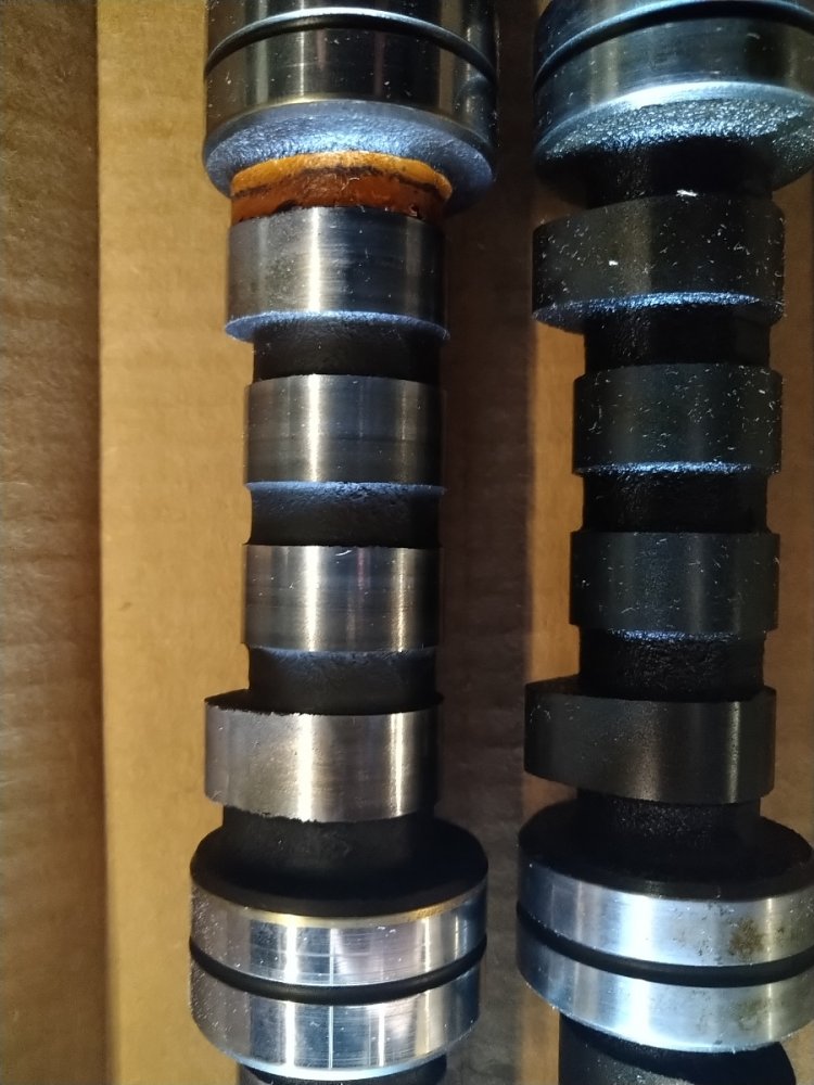

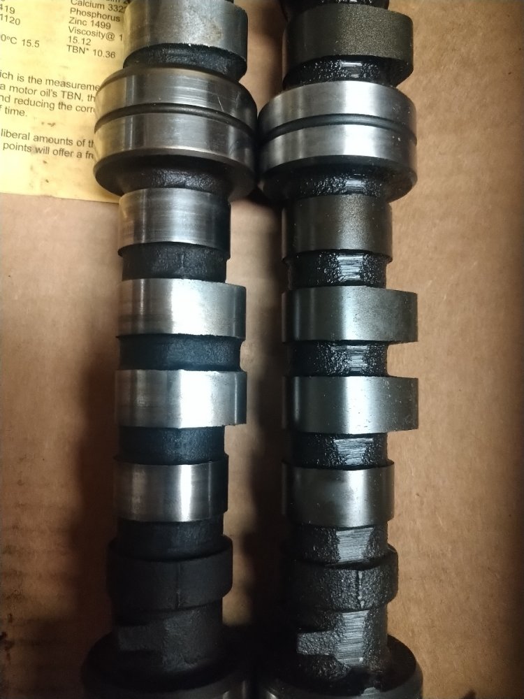

They went dead from clattering against my cam.
My cam side by side with a melling stock grind.
