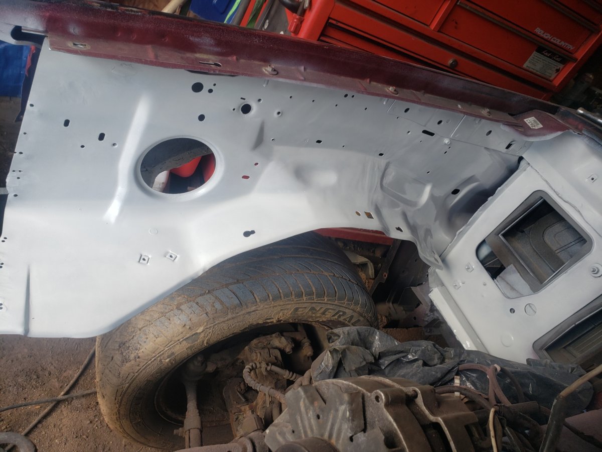

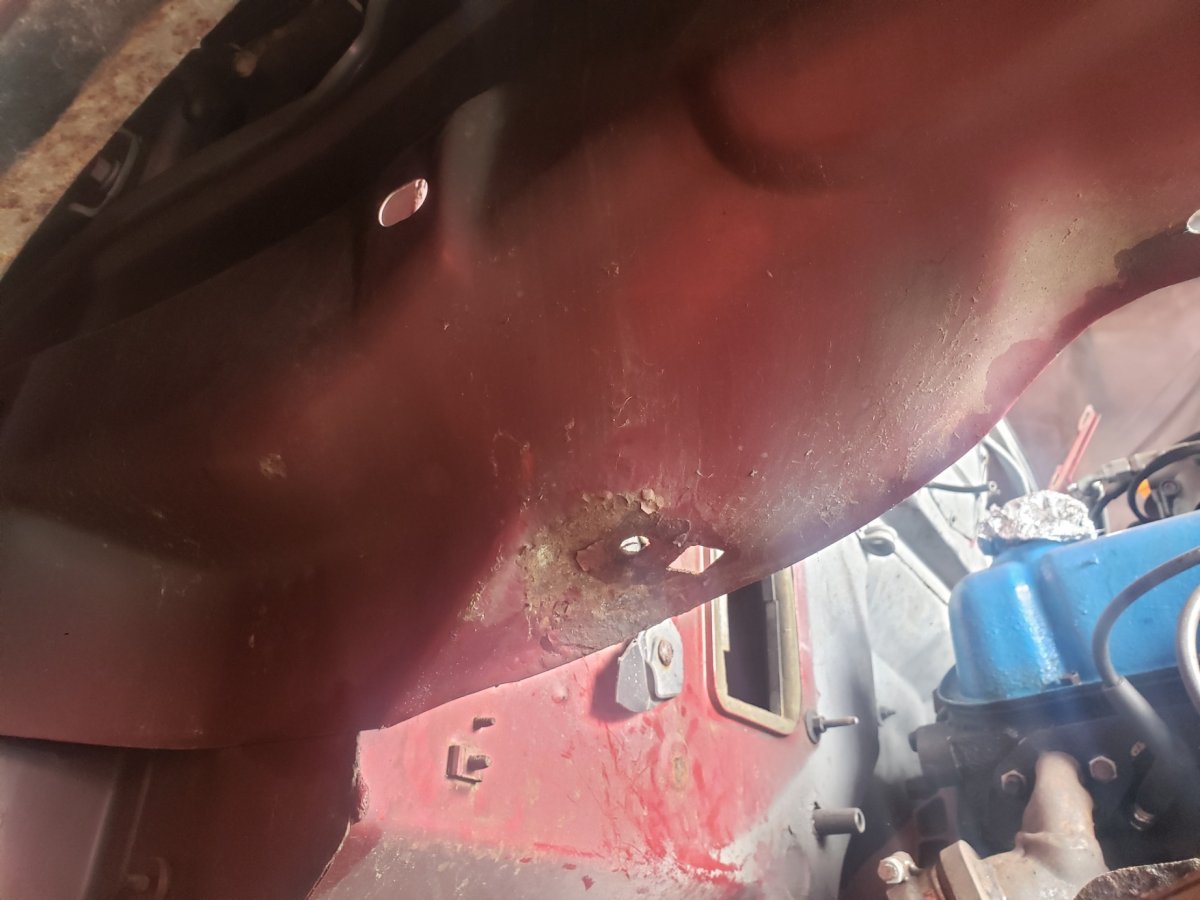

i dont know about newer year but 1997 the mazda b2300 ad ranger was the exact same truck its a brand new rad support and passenger fender and they are both ranger one when i ordered them and they are exact fit even the body line but going newer style i dont know that part actually but made quite alot of progres today body is already ready to be of the frame, started to work on the rust and primed where it was bare metal im progressin slowly but surely kinda taking time doing everything myself but i hope ill be done before summer
one side done atleast

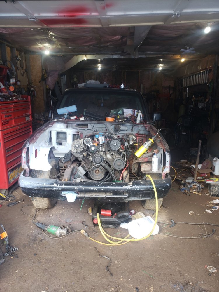

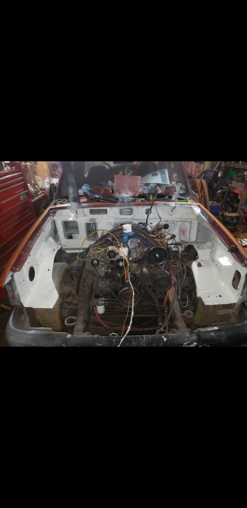

tomorow im hoping to finish the rest of the engine bay and having the cab off , next step gonna be to do the whole frame and im waiting on the full suspension kit from energy suspension, then ill start making the crown vic strut fit in the front i got quite alot to do but should be worth it in the end ill keep posting update on here specialy if i manage to make the crown vic strut work in the front but it should work great since they are the same diameter , travel is close enough tbh and same lenght.. i may just have to modify the stock coil spring location anyway ill keep taking picture and show you guys since i never seen or found anything about anyone doing it before

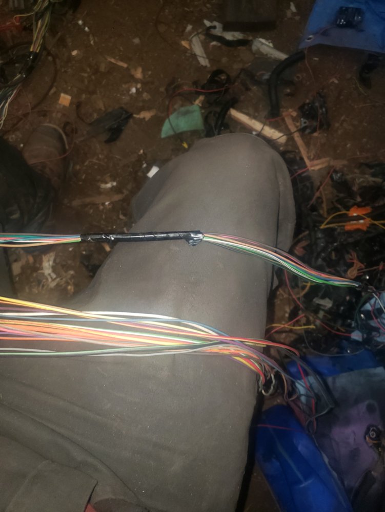

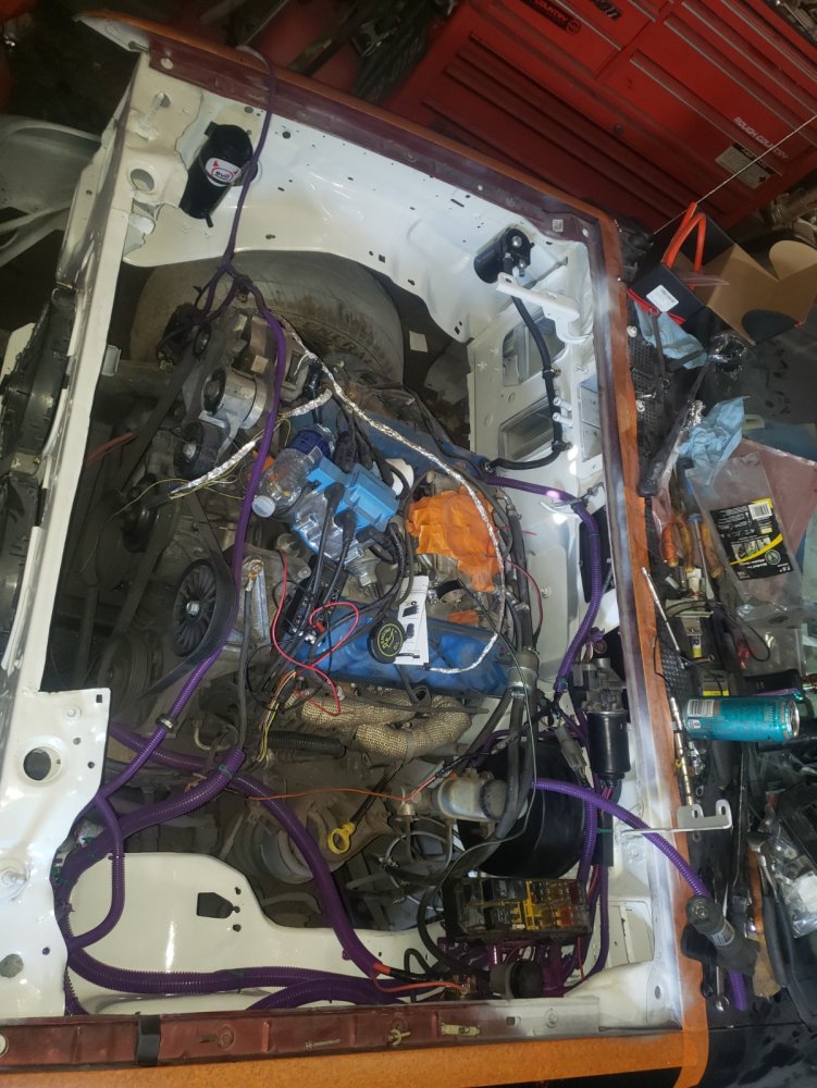

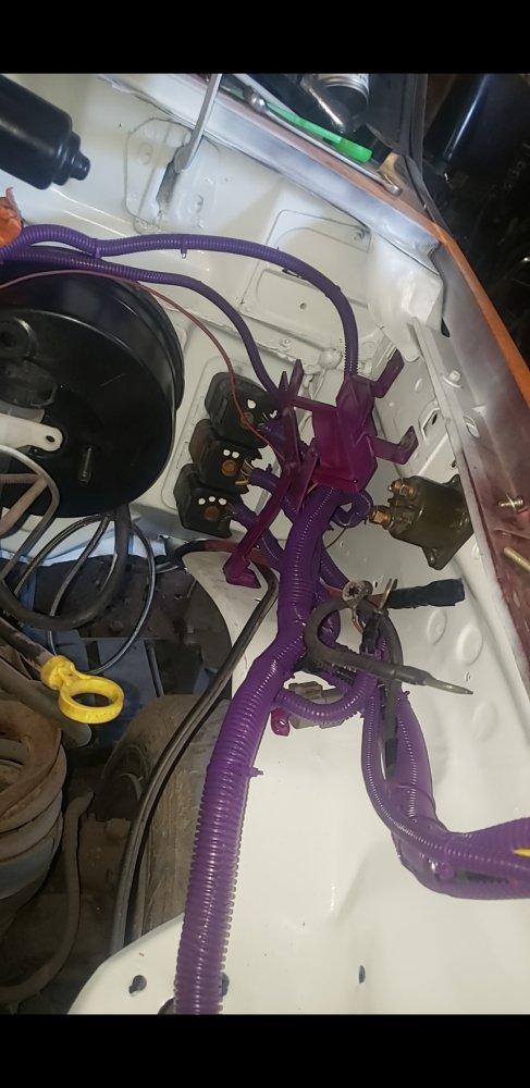

so i ended up with doing way much more work then i was suppose to havent tried the suspension yet i ended up cleaning the engine bay , taking the whole wiring harness out and trimming it down to only keep the necessary and loomed the whole harness purple to math with everything , extended and rerouted everything i had to , making quite alot of progress

The wiring looks good. Time well spent, to do it right.
thank you!!! took me awefully long specially removing every single wire that i didnt needes from the oem harness i did it the right way by unpinning each wire from connector and must have removed like 10lbs of wiring from oem harness hahaha that is everything i removed
  • mazda b2300  1997 5.0 swap c124 plug help!
And now that it's done, I bet that you're glad that you did it. Nice work.

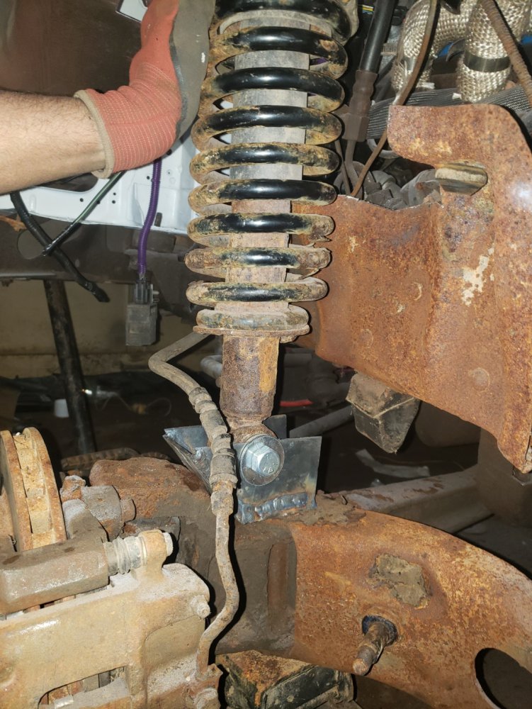

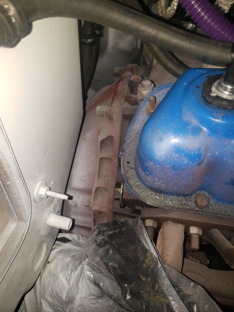

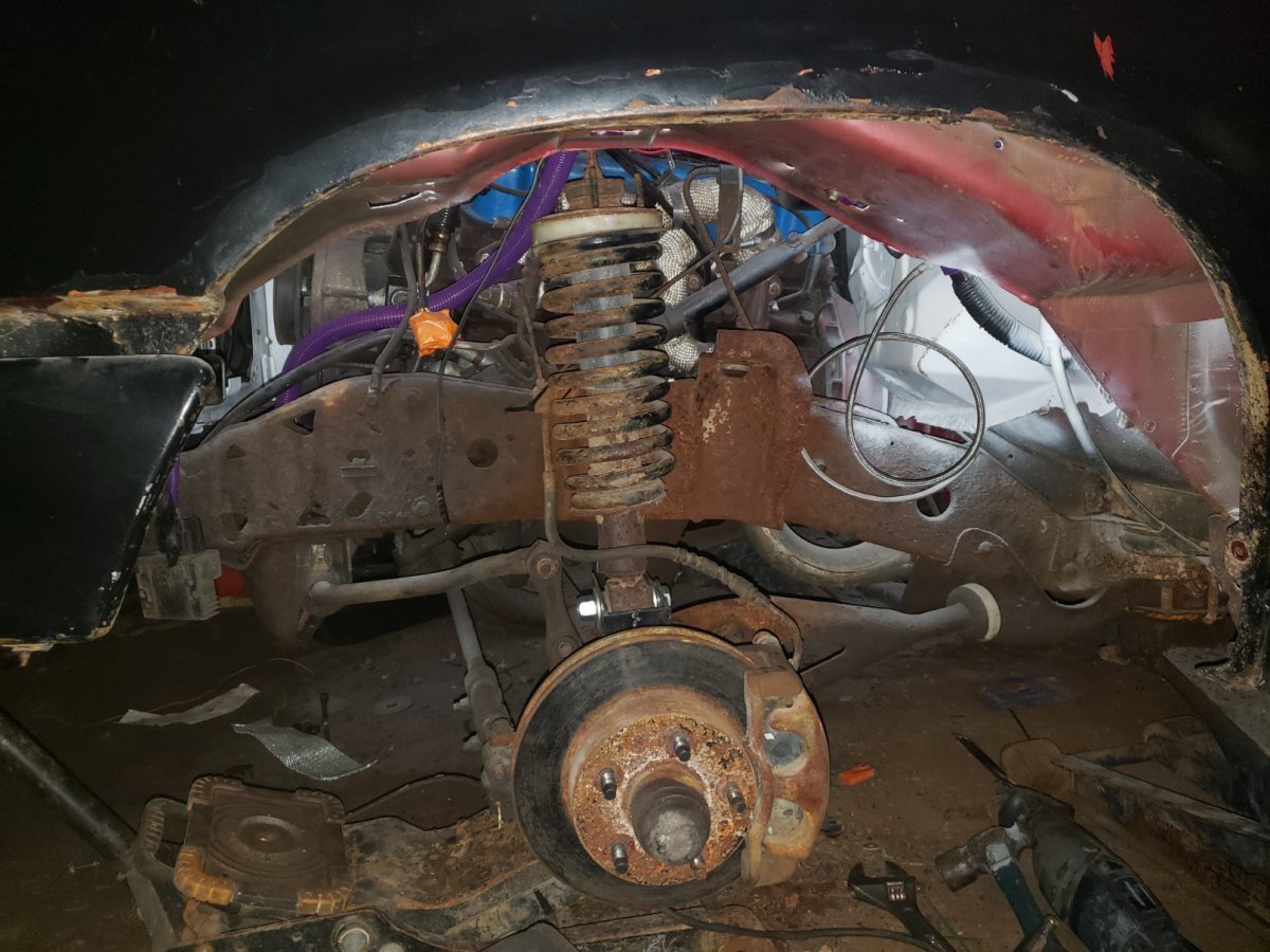

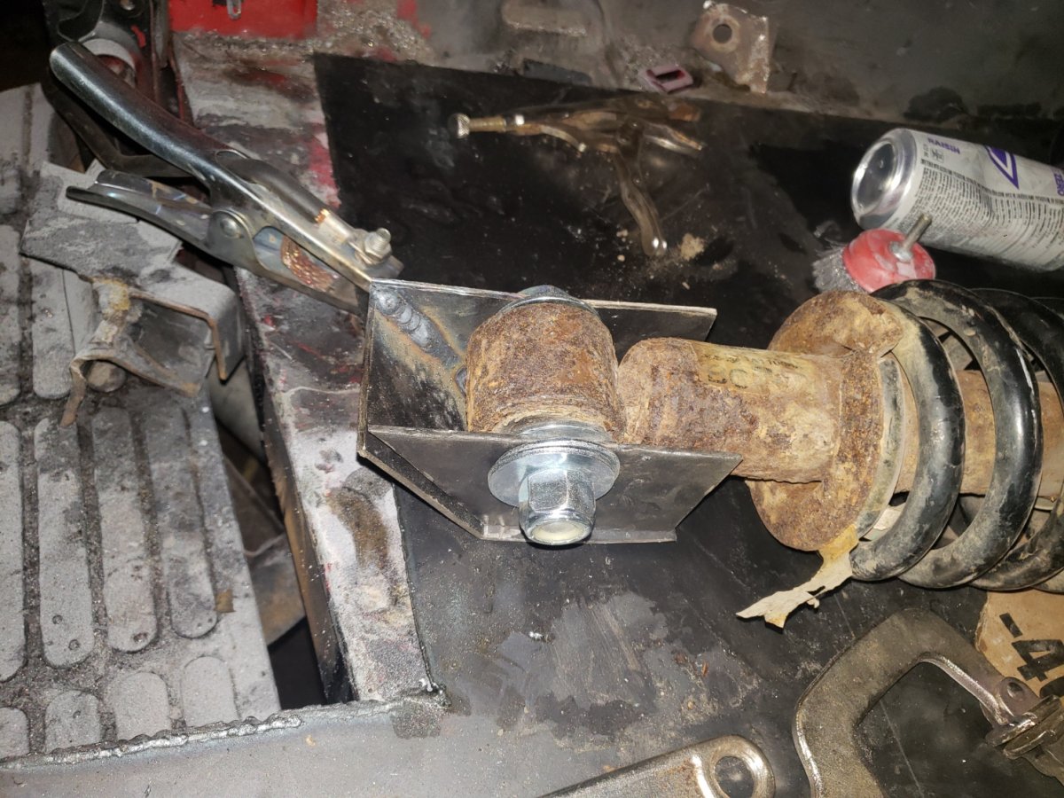

exhaust crossover deleted , catch can and over flow installed , rad support back on , wiring taking place slowly... ad well to the important point so far it look really good for having the crown Victoria front strut working well on the ranger.. definitely a lot of fab and a lot of measurement but at this point im pretty confident its gonna work very well once done im half way there on one side

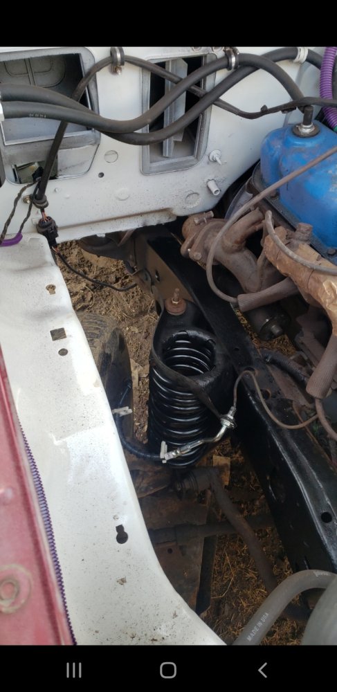

so quick update i was able to make the crown vic strut work but i had to remove them and went back with stock cause it ended up way too stiff almost static so no go for me which was a mistake of my part for not doing enough research about the weight of the p71 compared to my ranger and the spring rating in the end i ordered a new set of moog HD coil spring which actually made a bigger difference then expected maybe by next week truck will be back on the road and next step is complete bushing kit and body wise and paint job haha right now looks like a total sleeper which i kinda like
