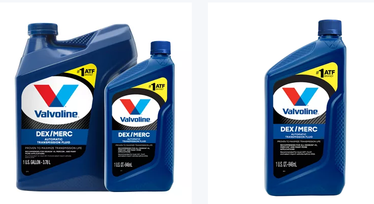

Plain ol' Mercon (what was originally specified for the M5OD) is still widely available, it simply is known as "Dex/Merc" now (any auto parts store carries it).

The M5OD I rebuilt about 6 years ago for my '88 started grinding going into 3rd last year (only in really hot weather though) and I had Valvoline Dex/Merc in it. Fluid looked new when drained, no major metal or anything, just the usual light sparkles that I would expect from 25k in a manual trans.
I put 10w40 synthetic engine oil in it about a month ago and occasionally I still get just a little "chunk" going into 3rd but never the nasty grinding noise. I "fixed" another M5OD with a 2nd gear grind with 5w30 engine oil. My suspicion is that the thicker oil makes up for a worn synchro temporarily. I don't think that I'll have oiling issues with engine oil like I might with gear lube but I guess I'll find out if I ever tear it down. Why a synchro would fail after only 25k is a mystery... junk aftermarket parts maybe.
I would like to try Valvoline Synchromesh MTF in an M5OD sometime but at $10/quart it's a high price to pay for an experiment. I really like that particular fluid for Mitsubishi transmissions.

This is the stuff I have in my car right now:
SUITABLE FOR Mercon®, Dexron®-III, Ford M2C138-CJ and M2C166-H, Allison C-4 and TES-389, and Caterpillar TO-2.
