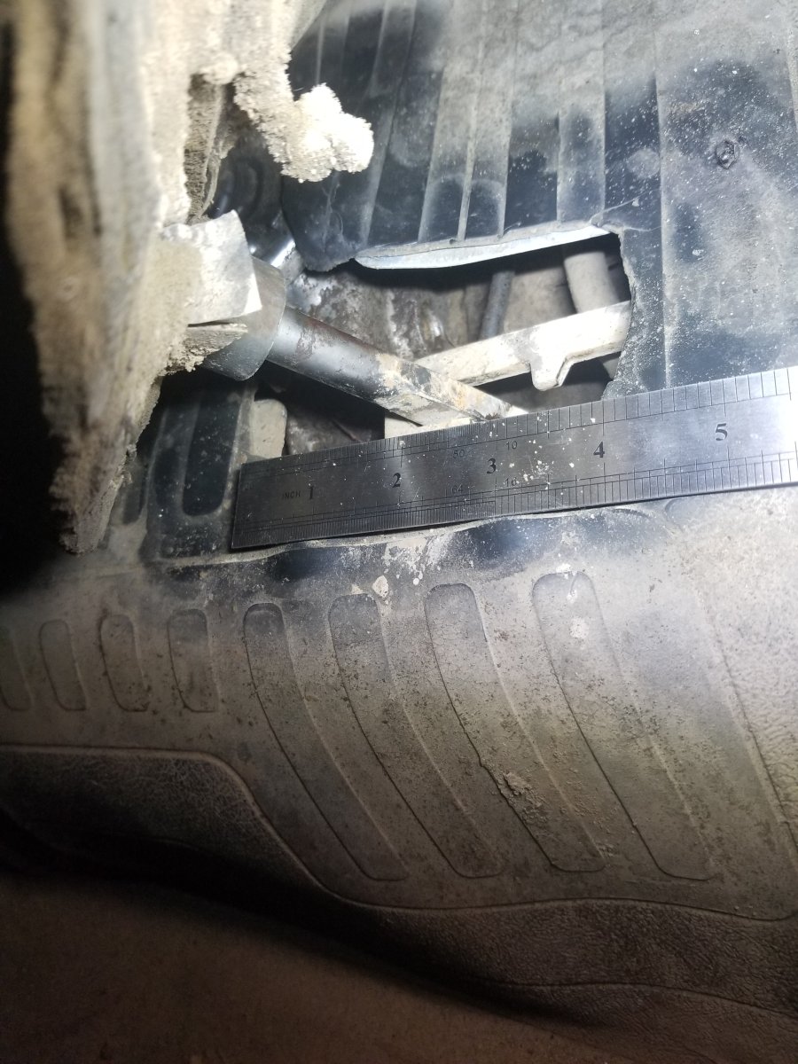

The shifter boots in my '90 aren't screwed down or anything, I'll see what I can come up with this weekend...
Ok, sorry for the delay but I finally remembered without getting distracted...
Manual Transfer Case Shifter Template
There's a picture with a ruler for scale. It looks like the notch starts at the back of the trans seal thing and goes back 4" and is 2.5" over from the left side of the seal. I'm pretty sure that'll get you roughed in at least...
Thanks! that will give me somewhere to start
