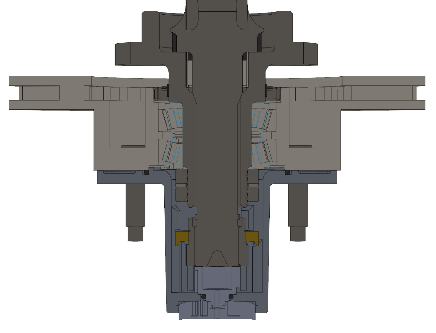

Quoting 'Doc' from Back to the Future, I apologize for lack of detail, I only had couple hours this afternoon. Diagrams are made from parts I have kicking around my office.
Ranger Spindle/Hub-Rotor/'Hat"
Pale blue in center are the cutaway bearings. By quick measurement, the races are separated by 5mm.
Inner and outer bearings are LM603011 cup/LM603049 cone aka Set 37
You can see how the wheel mounting surface is outside both bearings.
A stronger 'hat' doesn't solve the issue of insufficient bearings (too close together, wheel cantilevered). And there is no way around that issue with 5x4.5" pattern.

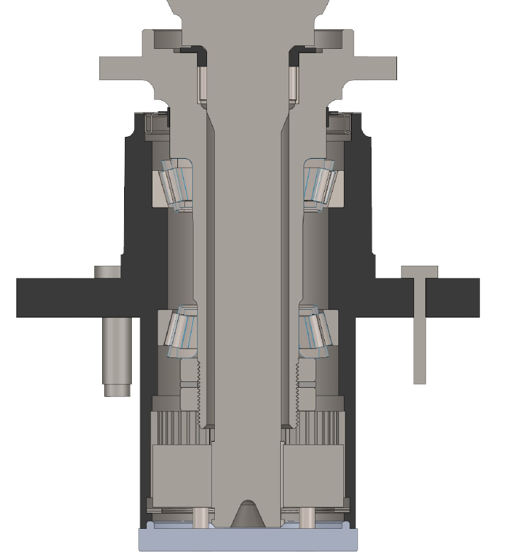

F-150 Spindle/Hub/Puck (happens to be setup full time)
Again, pale blue is the bearings - in this case they are separated by 1-5/8".
Inner bearings are Set 37, while outer LM501349 race/LM501314 cone aka Set 45 (yes, my F-150 hubs had "Dana 28" bearing for outer)

You're not telling me something I don't already know... The D35 wheel bearings are closer together than the D44's, yes. The WMS is outside of the bearing, yes. And absolutely yes there is a solution to that: Positive-offset wheels.
The factory RBV wheels had offsets of +12-19mm which puts the tire's contact patch close to right underneath the bearings (6" wide wheels had 3.75" backspacing, 7" wide wheels had 4.5" backspace).
None of that is why the D35 has an unusually-high rate of bearing failure (the D35's bearing design is actually quite robust, far more than it needed to be). Where the problem comes from is probably unexpected (I didn't make the connection myself until maybe 8-10 years ago): Aftermarket brake rotors that continue to be sold with pre-installed bearing races, but without matching cones to go with them. People (shop techs included) combine these parts on their own (often from differing countries of origin) then (not realizing why) wonder why they fail and blame it on whatever they can think of (or whatever it was they heard the last guy say, in the D35's case it's the spacing of the bearings). AFAIK, D44 wheel hubs are not sold with pre-installed races, so is why you don't see so many failed bearings on them (people are normally prompted to install both the cone and the race from a matched set since neither item pre-exists). Guaranteed if you mix races & cones on a D44, you're gonna see a similar rate of failure there too.
This is why I always tell anyone doing brake or wheel bearing work on these trucks to get rid of any pre-installed races and use both parts of a matched bearing set (perhaps the Brakes forum needs a Sticky on this). Practicing that myself, I've yet to have one fail (excepting from water intrusion once). And that's with heavy 35x12.50R15 mud tires on -12mm offset wheels (plenty of cantilever action going on there lol).
Nicely detailed diagrams, BTW :icon_thumby:
