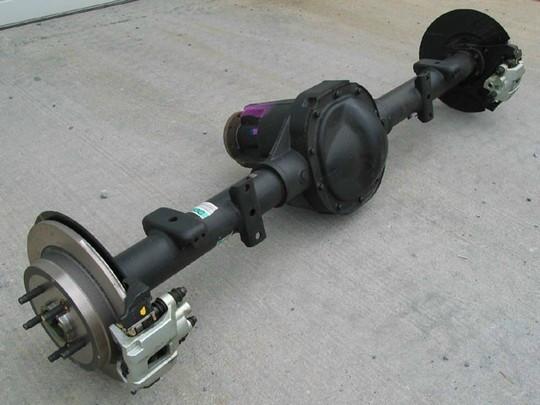

making explorer axle swap easier?
i cut my stock ones off the ex's axle, it was easy...
might reuse them, might not.. thought about using a thick square tubing and making perches that incorporate some lift into the perch. maybe only like an inch or so.

Even if you use the flip kit you still have to weld the shock mounts on. No getting around that. So just weld new perches on as well. It isn't hard. And if you don't know how to weld find someone that does and needs a new friend.

I agree that it's not difficult. Why would I need to weld on new shock mounts? Thanks.
i believe its because the on the explorer the shock mounts are integrated into the U bolt mounting plate?

Because on explorer axles the shocks mount to the spring plate. And that plate will not work over the axle if you use it on your Ranger, and thus will not work with your shocks since they are mounted inboard of the frame rails anyway.
so when i do my 8.8 swap, should i leave the upper location of my stock shock mounts in the stock place??? or is there a better way to "direct" them?
If you mean the upper mounts on the frame rails I'd just leave them, they can't be relocated higher unless you cut the bed.
i don't have a "bed" lol.. but yea. that's what i thought to. i was thinking of moving the upper mount to the middle, just make a bar that goes between the frame... but i don't think there's room for that in a b2.. i'm gonna leave them
