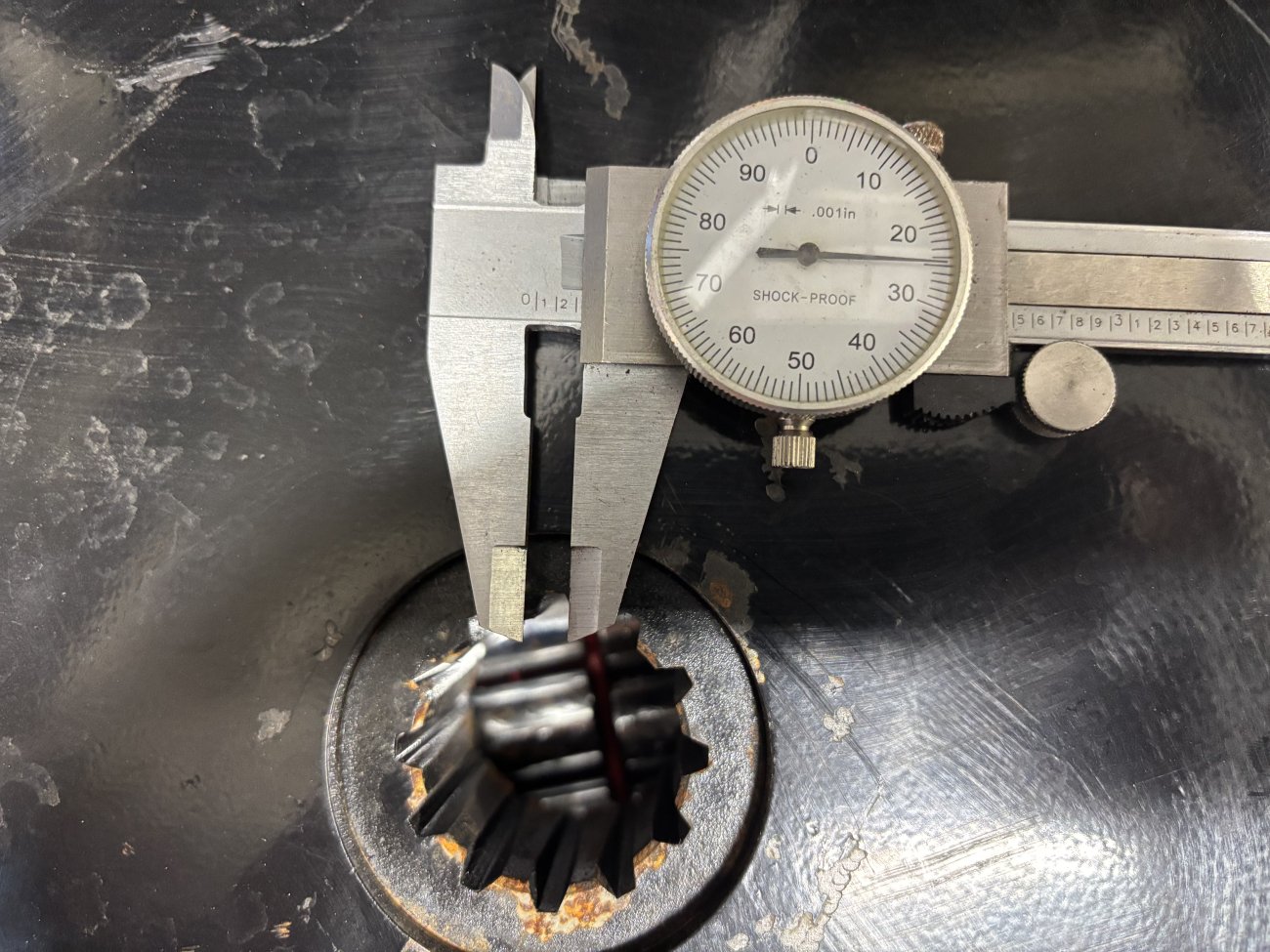

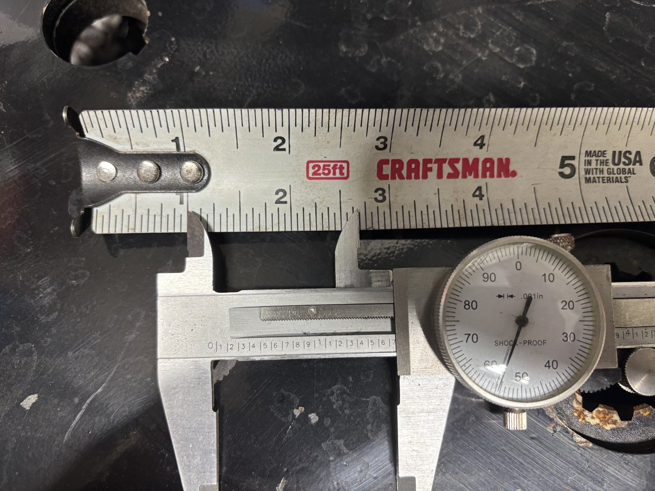

That is bottom of the groove to bottom of the opposite groove

Top edge to edge of the tapered groove.

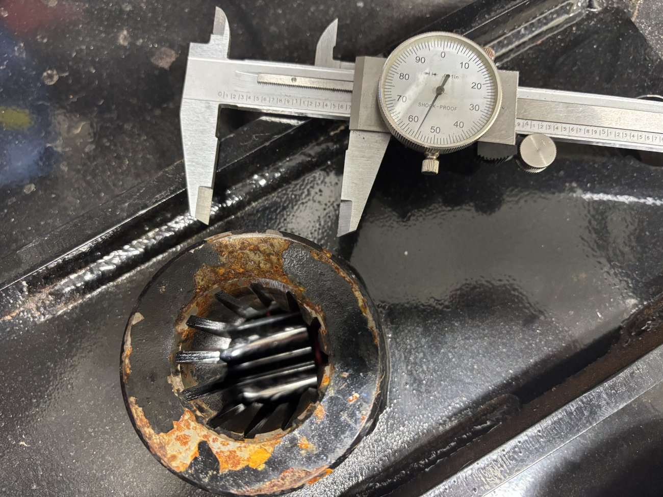

Wondering if it would be possible to make a double sided broach and push it through 6 times with a shop press to fix the 12 splines
I think whoever made the thing should have finished cutting the splines there.
IMO it isn't made right. I would try to return it if possible.
Too late to return now. Originally I had thought of returning it and trying again but the family friend said he knew a couple machinists and could get it taken care of. Couple months later I got it back without anything being done. Then it sat here a couple months because I haven’t had time to deal with it. Now that the weather has gotten poor, it’s become a project for cold days in the shop.
I couldn’t find anything specific for my brush hog. Actually couldn’t find much of anything in relation to information or parts specific to mine. The company is still in business apparently, but the models have changed and old information is hard to come by. Gearboxes have changed with the newer ones. Blades and bolts are still apparently the same but the rest I dunno. I sourced a 12-spline of the correct measurements (at least the measurements listed) and there was a vague reference that it fit my brand (Howse), and it used the correct blade bolts. Closest I was able to find. Made in China of course. It fits on the shaft, just the angled sides of the grooves are slightly too narrow to fit over the splines on the shaft.
My old stump jumper is bent and the bolt holes are egged out. I like the thickness of this new one in comparison, much more sturdy, I just need to make it work.
If I really wanted to (I don’t), I could cut the center hub out of both stump jumpers and swap it. Be a bugger to grind out the weld and it appears to be a press fit as well. Makes me wish I had a mill or big lathe.
You may be able to take a tri-angle file or a dremel and hand cut the splines some, but I don't think you will be making a broach of any kind. That is some sort of treated tool steel so it will cut and keep an edge.
Did you say you could cut that piece out and replace it with another one you have? Could you use a hole saw and lots of cutting oil to cut that piece out?
I can try burning out the finish and a file again, but a file wasn’t making much of any progress the last I tried it. I don’t think a dremel will do anything useful on this.
I can harden and temper a piece of steel. If I make a double sided broach, it only needs to last for 6 cuts. I’ve just never tried making a broach and haven’t been able to find any real useful information so far on making one.
Cutting that piece out of both stump jumpers and welding it in is theoretically possible. I would have to check, but I think a hole saw of the appropriate size will not reach the weld bead before bottoming out.
I find a bunch of weld in 12 spline stump jumper hubs on ebay and the price isn't too terrible... but they are all tapered splines.
