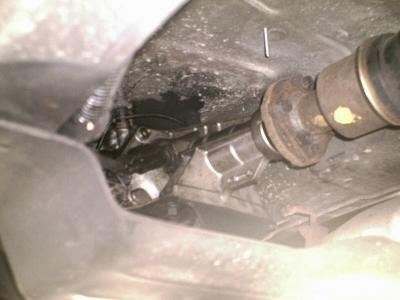

*I'm still surprised that @lil_Blue_Ford 's 1359 transfer case didn't have oil in it. I would have thought input and output bearings and speedometer gears would have appreciated a little lubrication.

It was a fully machined 1350 T-case. Should still be around here somewhere. Really kinda odd. They just hammered a freeze plug in the front output hole, put a single bearing in the front instead of the planetary, clipped a slip joint joining front and rear shafts so it couldn’t move and called it a day. Completely empty, no evidence of ever having oil. Of course, you’d have to fill the thing completely full, way above the fill plug to get anywhere near the bearings since there’s nothing to sling oil around.

Filling dummy transfer case up to fill plug would be darn close to bearing level; close enough that every bump/dip/hill you went over would oil bearings (I'm looking at disassembled bw1350 as I type this). Waste of oil and not much oiling, but the bearings aren't really under much load without low range/front axle drive.
