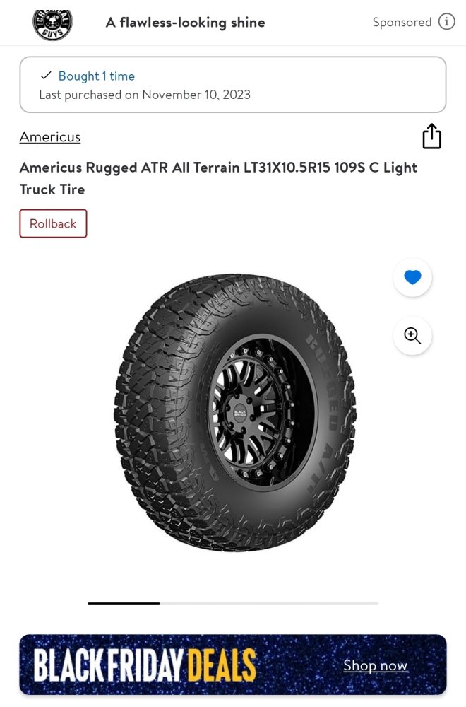

I got these tires. They have some good reviews. I don't use my truck that much so I'm not really worried. These are Rollback price @ Walmart with free delivery, I have a shop that will mount and balance for $15 a tire, not too shabby. They came to $596 Total with tax and free shipping for 4. They look nice and healthy too.

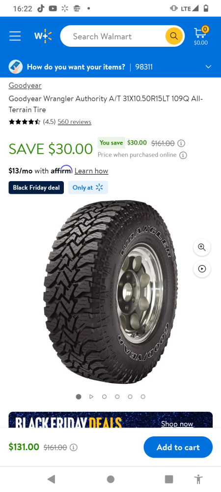

Also, if you have not taken dilevery yet, the have a nice special on the same size Goodyear Wrangler A/T @$131 each; I was considering them.

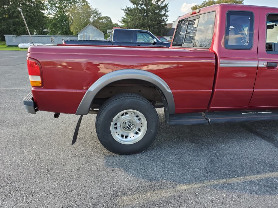

Thanks for the info,, 🙂 I saw those Good Year Wranglers on the Walmart site and was going to order those originally..... But I liked those Americus ATR tires better. They looked more beefier and looked like they'd fill the wheel well up a little better, and I love the design, especially the sidewalls. My current tires look so lost in the Ranger wheel well, I believe they are 235/75/15.
These Americus Rugged ATRs are real sweet looking.
Have a look, they look lost....🤣

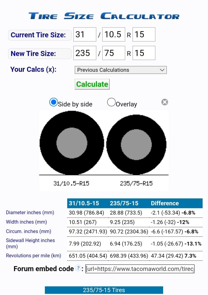

Further, there is a substantial difference in the tire sizes. Going from 235-75-15 to 31-10.5-15. Hopefully no issues mounting them on the original Ford Deer Hoof Rims.
You should be just fine as to the fit.
What's the oem tire (door sticker)? I wouldn't be surprised if it were 31" (265's), mine was.
265’s were a option and as far as I knowcame on the same 7.5 wheel that 235’s were put on. 265’s are the metric sized equivalent of 31/10.50’s, no worries there. Id assume you have the 4.0 ohv with 3.73’s- my 93 s/c was setup that way and did fine with both 235’s & the later 255’s. Now the 2.3 with those sizes is another thing, fine with 4.10’s until you hitch up a trailer or really load the bed.

It's 235.
Yes I have the 4.0 OHV Super Cab
