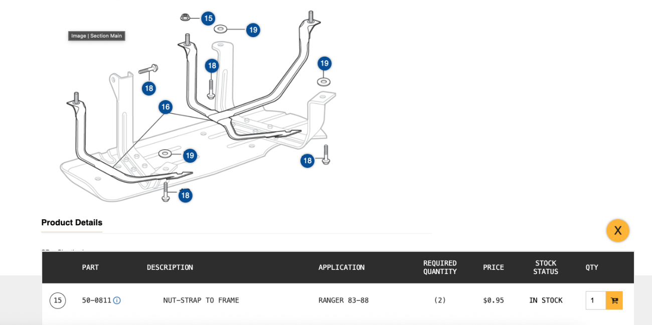

Looking for the spec of 50-0811 (15) nut

I'd go to the hardware store and get a bog standard M10x1.5 flange lock nut (since the drawing makes it look like that is the particular sub-variant) $0.60... might even be able to get a real ford one from ford most likely
