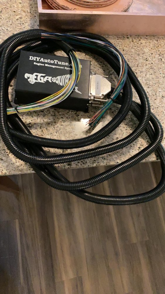

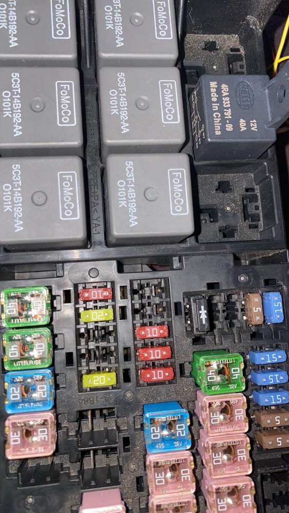

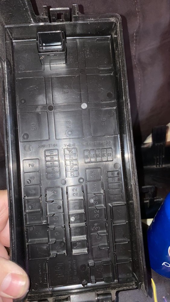

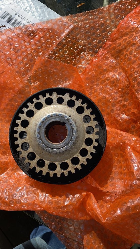

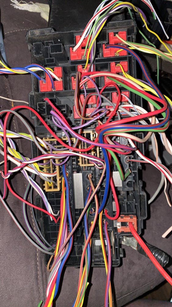

Slowly collecting parts to get the ranger running under Megasquirt. PiDash stuff. 36-1 95 ranger pully for the crank sensor. Scored a 2013 mustang power distribution box for $27. Has 7- 40a relays, 4 of them fused and should really clean up my wiring and I’ll be able to isolate the ecu from the factory wiring.

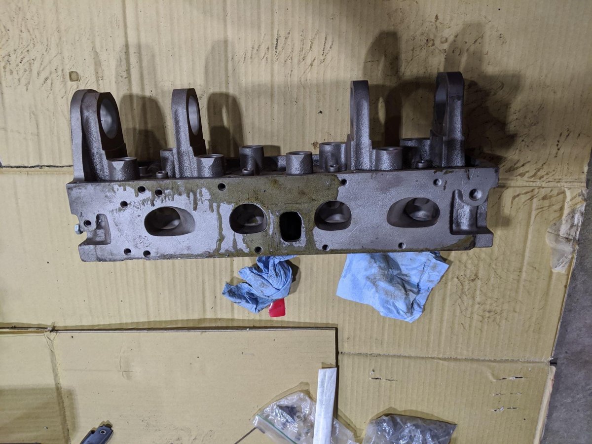

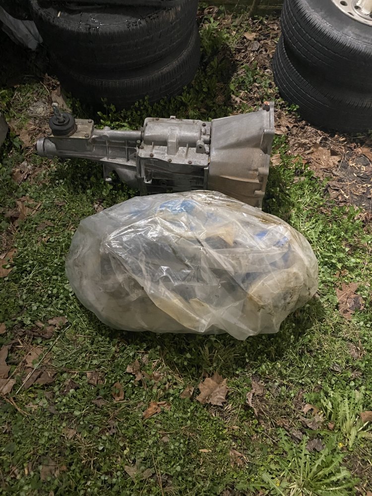

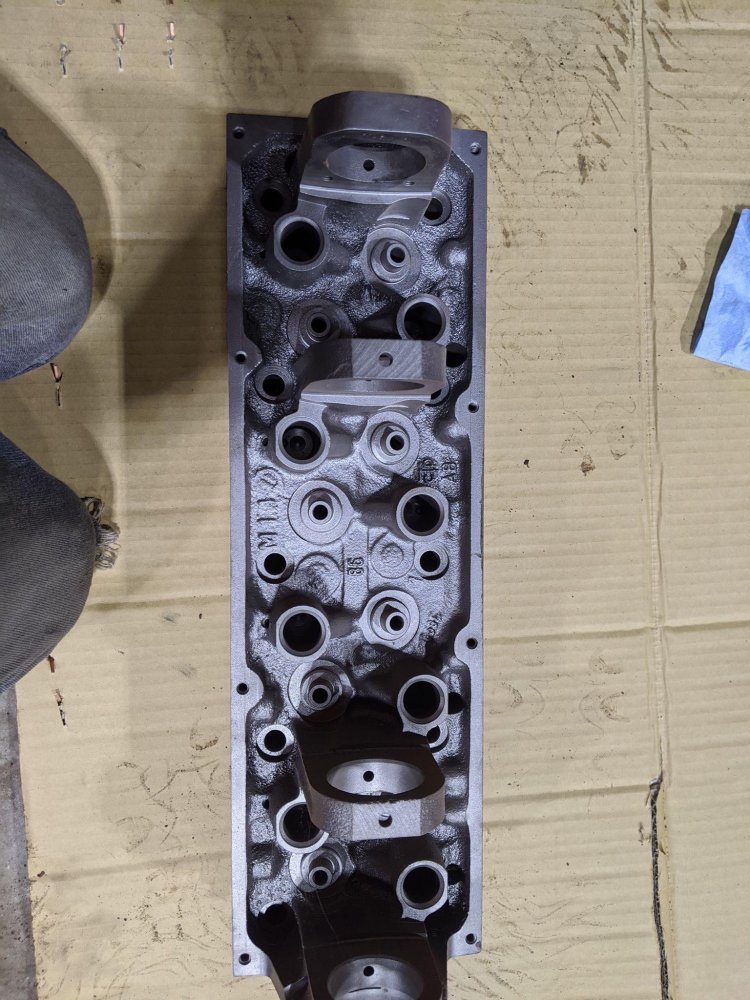

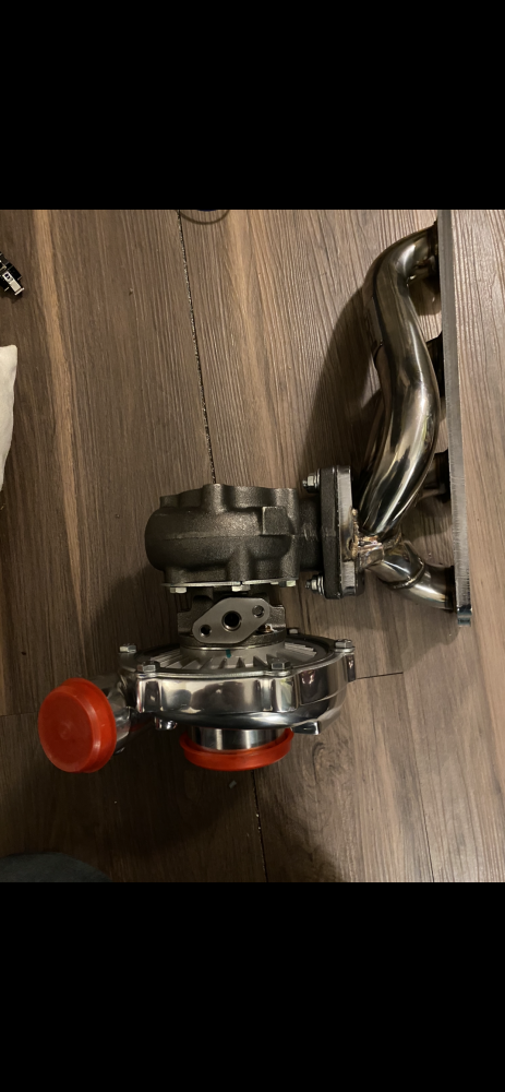

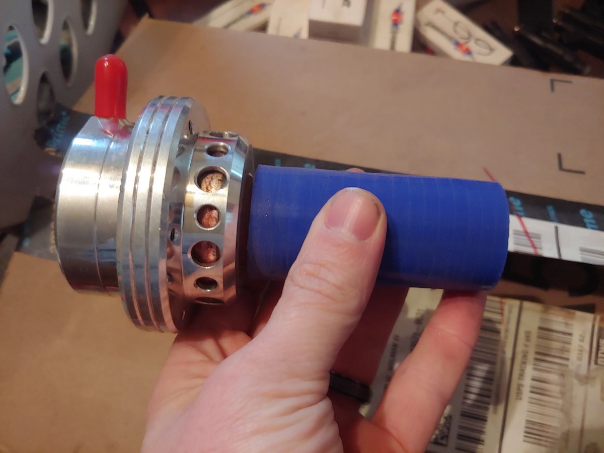

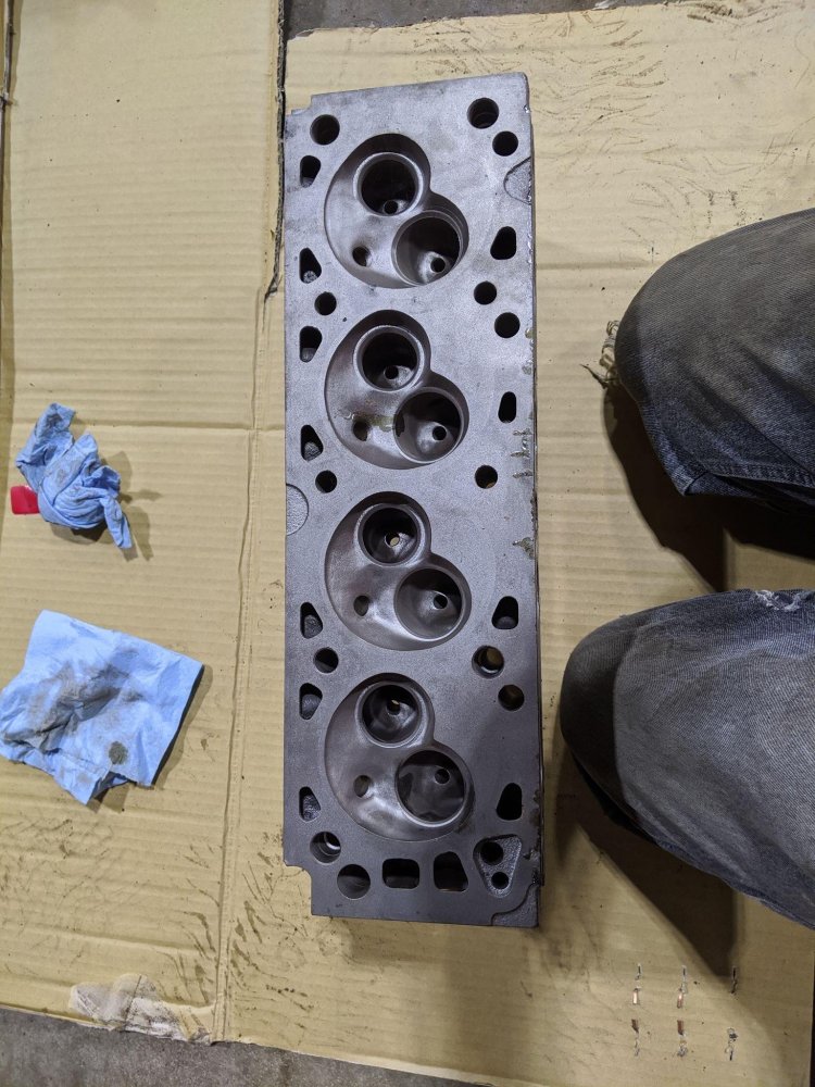

Grabbing turbo and drive train parts: 8.8 expo rear, turbo coupe T5, Spec clutch, T3/ T4, ported D port head, 65mm 5.0 expo throttle body, ported up and lower intake, complete turbo bottom end. Just need the Valvetrain, to finish the motor. Need a Turbo header( the one in the pic is garbage) and exhaust. Finish the rear end/ driveline and this thing can go together!

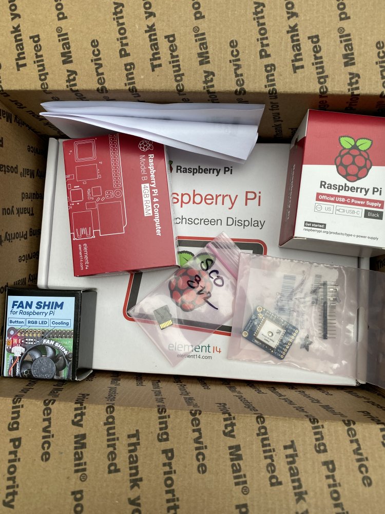

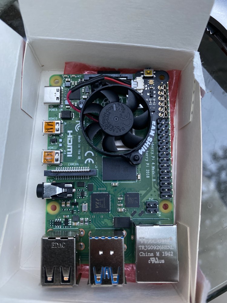

I’m roughly $250 in on the pi dash, including the acrylic I’m mounting it to. This is all Raspberry Pi products or endorsed products. The cables were eBay/ amazon specials. The only other thing I may need is new fuel sending unit as I believe that input can be calibrated and rather start new than try and run the issue down later?
I may end up spending the money on a faster micro sd card to speed up the boot time and wish I had done so in the beginning.
Another thing: I haven’t fixed the shutdown/ power supply issue yet but found an old forum post from Raspberry that hopefully will fix it.
