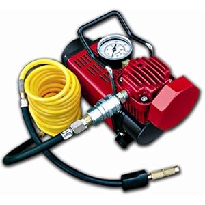

Start of OBA! on board air
bought a MV-50 12 v compressor this last week with some Amazon credits that I had. really good reviews on line for this compressor. It has really good reviews on the jeep websites.
http://www.amazon.com/Industries-MV50-SuperFlow-Hi-Compressor/dp/B000BM8RT8?tag=959media-20
it lived up to expectations by airing up my 33s to 33 psi from 10 psi in under 3 minutes.
My extra coiled air hose with a universal female fitting plugged right now the fitting. This is the only thing on line that people talk about as bad. I put it under the hood in the battery box area to test fit it. Fits real good, so probably going to just bolt it to the battery box tray. Plus hard wire it to the battery.

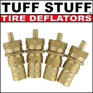

I also bought some Tuff Stuff Tire Deflators.
http://www.amazon.com/Tuff-Stuff-Tire-Deflator/dp/B0049WPUX2/?tag=959media-20
They were hard to adjust as the reviews said. What was not said was how slow they are! Takes almost 10 minutes to go down to my desired 10 psi. I can pull the stem and have the tire down to 10 psi in 2 minutes just doing it by hand. So I think that I will just go back to the Manual method.
