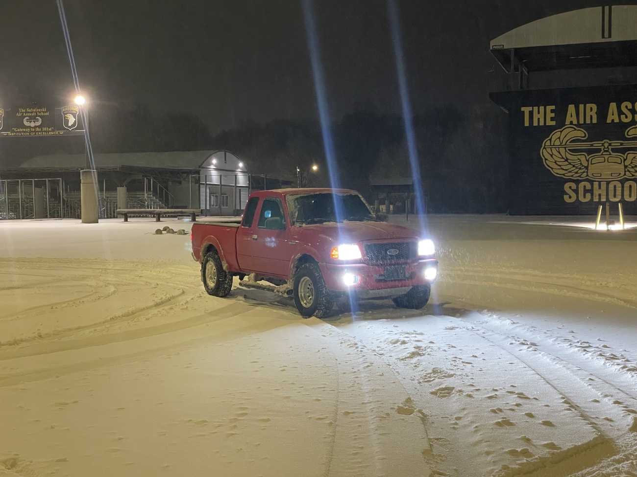

I fixed it yall. There’s a connector behind the spare tire against the frame on the drivers side. It’s the main connection for the taillight wiring. I unplugged it cleaned the connectors then reseated it and everything works great now. I also wired up a new trailer light connector. Thanks for the help

Thank you, for letting us know, and great job fixing it!
