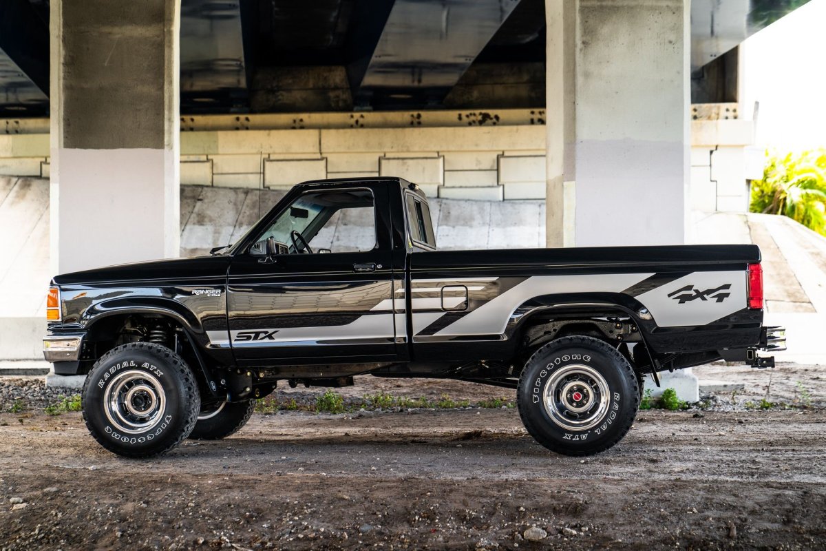

I saw this build by Bullet Motorsports and really liked it. They have the Rough Country but I will probably get the Skyjacker. When looking at the build page it says 31 are max tires with a 4 inch lift why is that? In this picture I feel like 32's or 33's could fit?

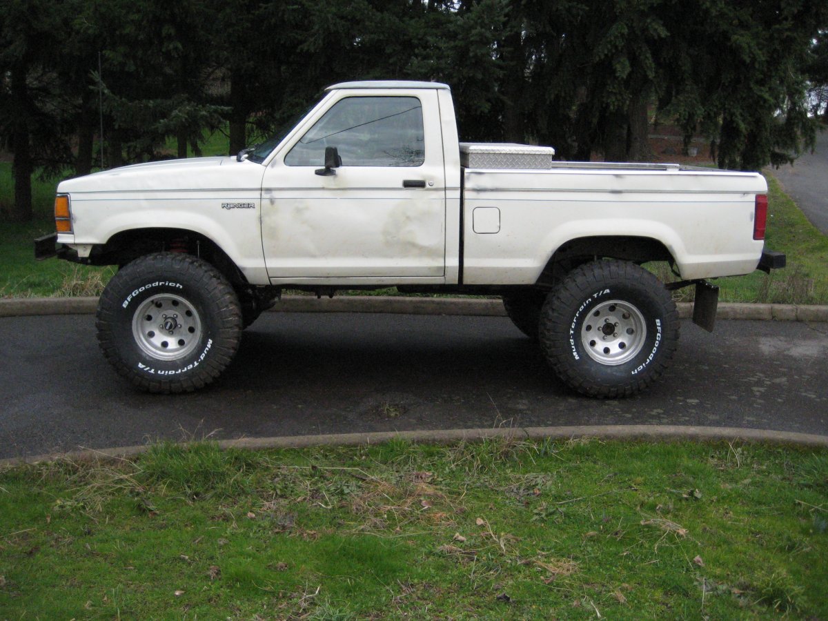

Most of the tech stuff is going around '83-88 body style which has smaller front fender openings and expecting you aren't going to trim the fenders... the stock front bumper is a restriction too with the air dam under it that will hit first. I fit 35" tires on my '90 with a ~6" lift (got it used, assuming) with minor fender trimming, before I rolled it it looked pretty good, I'll try to post pics of how I did it later tonight. That said I'm pretty sure you could fit 33's with a 4" lift.
In this picture you might be able to tell that I trimmed the back of the front fenders and the front and back corners of the rear fenders, I wacked the corners off some with an angle grinder then took some sheet metal seaming pliers and folded over the edges so it isn't a jagged straight metal edge like most people do, it looked good until I rolled it and the "just ain't care" level just went out the window... I mean I still care but not as much as when most panels were straight... wait, on closer look that's after the roll but when it was still clean and well I just covered the just ain't care thing :)
