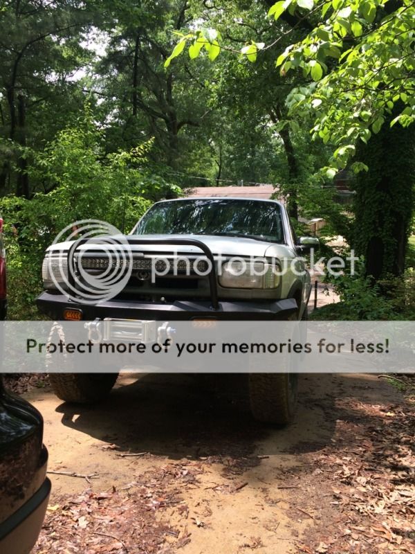

I forgot to add a pic of it with the winch

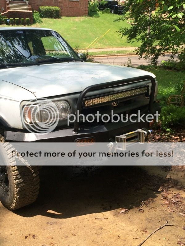

My homebrewed setup

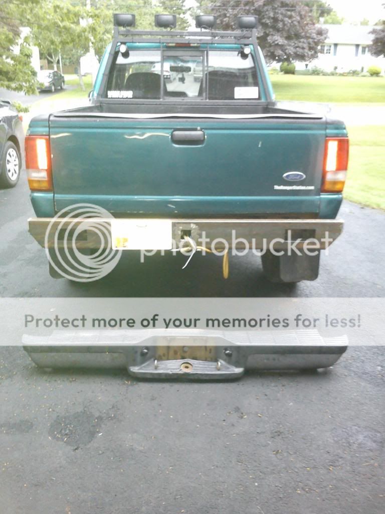

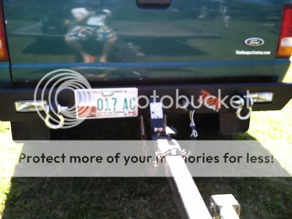

Unpainted
Painted and installed

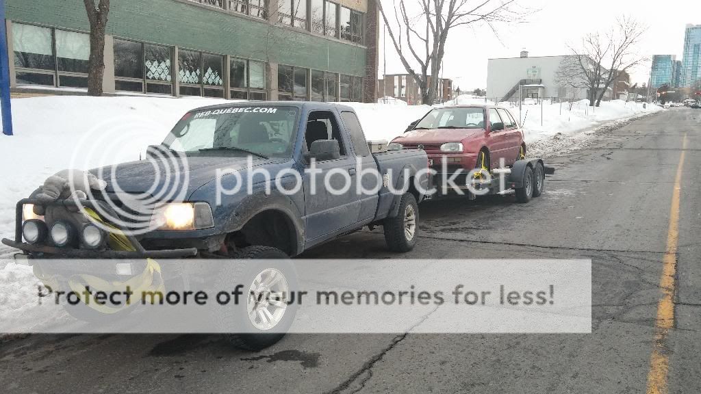

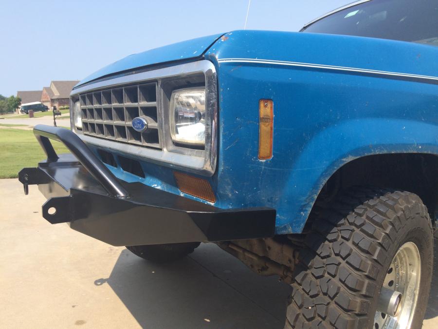

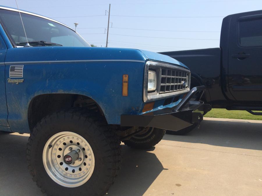

Here's one i just built for my ranger and i also bobbed the bed.

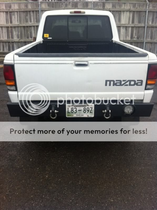

I looked throw a lot of your guys bumpers. they all look great. heres the bumper I just built for stubby..

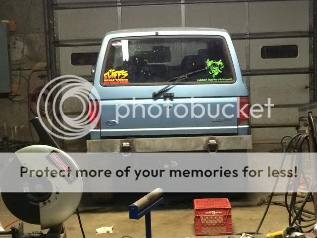

Front is 1/4", rear is 2x6x3/16 lights frenched in with 1/8" and the plate mounted in the receiver

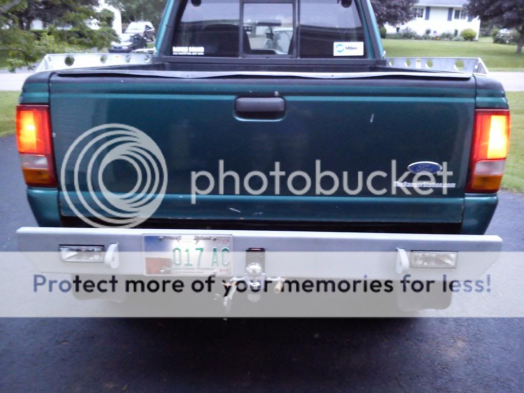

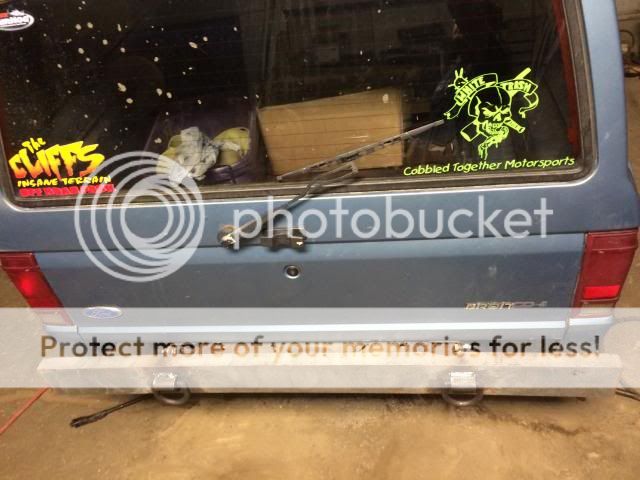

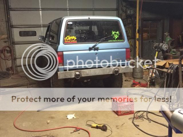

Here's my rear, quick and simple. 64" piece of 5" C-channel with 3x4" angle iron brackets.

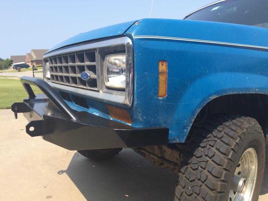

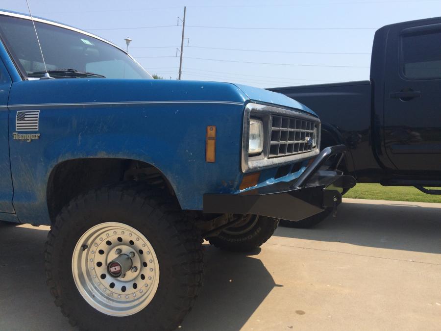

85' Ranger Winch Bumper
I had a local guy fab up a winch bumper for my 85 ranger. He welded the winch plate below the top plate of the bumper so that once my winch comes in he can plasma cut the top section off and the winch will recess between the frame rails and I can mount a fairlead to the front.
85 winch bumper
