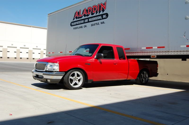

Okay what a long a$$ day.....here pics of 2/2 as promised.
This is right after.....
And this is after they settled and sagged under the V8. They sagged/settled about 1/2 inch.

nice, i can finally see what its gonna look like before i do mine, the only thing im unsure of is whether i want to remove a leaf spring because it would be nice for it to be level looking, but then again i dont know if its gonna cause alot of harm, the most i haul is an atv in the bed and an atv on a very small trailer, and they way it is now it barely squats hauling both those, thanks.
I dont know aabout removing leafs...ivenevr heard of anything coming out of it. Especially for hauling I would def flip the hangers first or flip the axle over the springs. Those leafs will sag quickly if you alter them at all.
