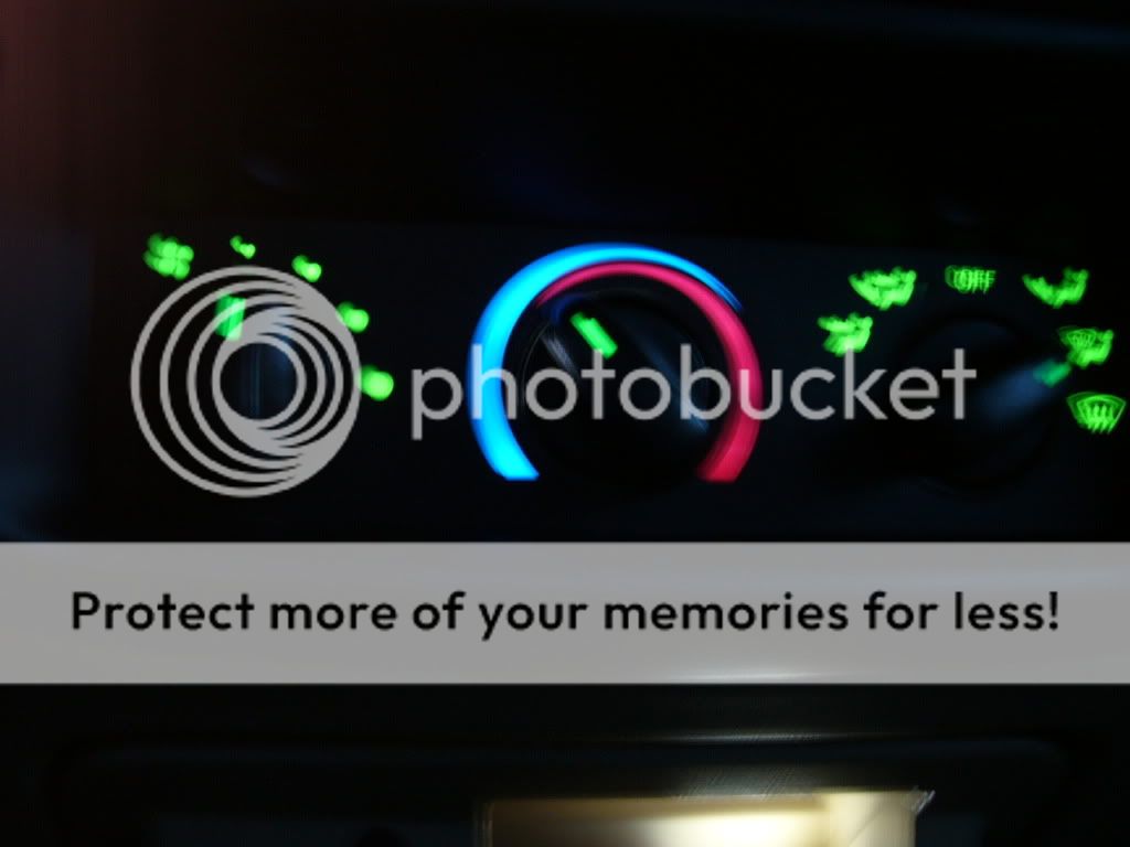

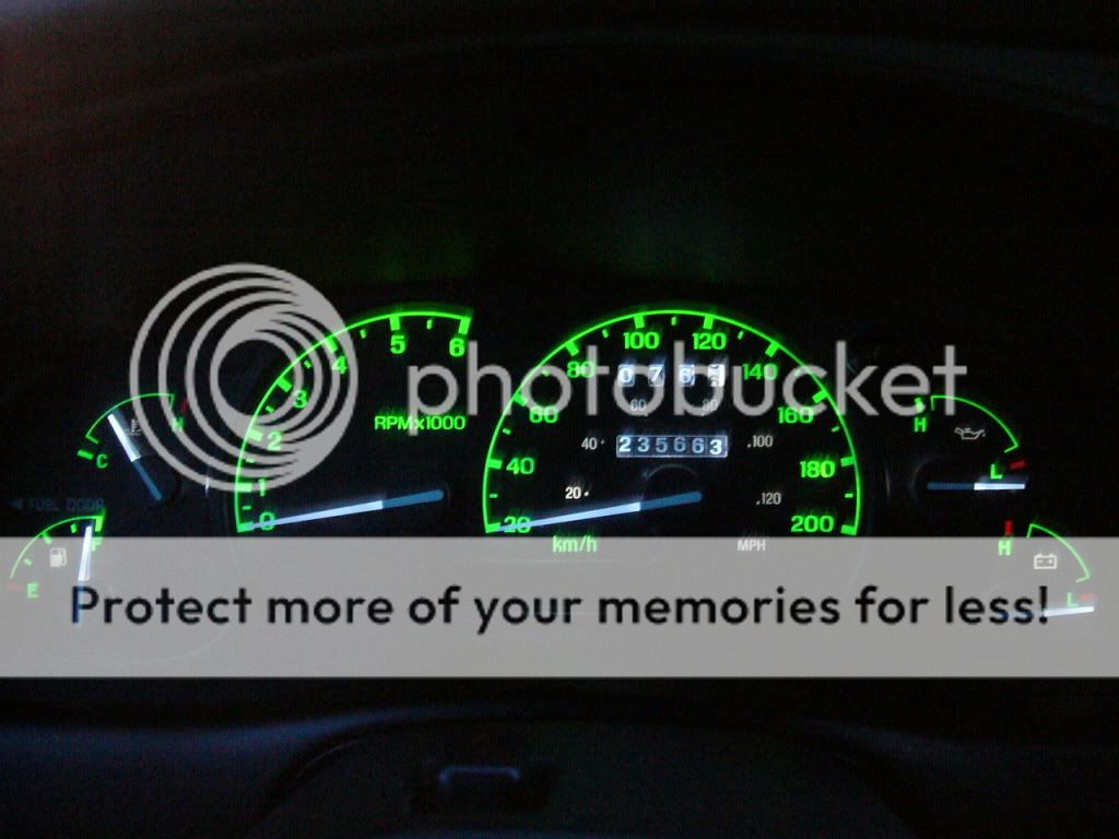

Am I the only person who put white LED's in and got Blue numbers?
I used the single LED's, with the 120° angle. They're not Uber bright at all, any Brighter and they'd be annoying.
On the HVAC Controls, is that just white LEDs as well?
It depends on the wavelength of LEDs you use. If you use the hyperwhite ("Cool" White), you will get blue as the filter used to get the green color is actually blue. "Warm" white (what incandescents are) is a yellowish light, so it hits the blue filter and ends up green. Cool White, which a vast majority of LEDs are, produce a blue light, so blue + blue = blue.
Did you fill your tank just for the picture? Haha.
I try yo keep it full when its possible :icon_idea:
I'm soon to have Mustang hvac knob to replace mine, I want the dot on the knob to be white but mine are green all the way and my friend's mustang its clear with just the tips painted green
10$ worth of LED from ebay, done the HVAC and cluster, and the result is perfect :icon_thumby::icon_cheers:
