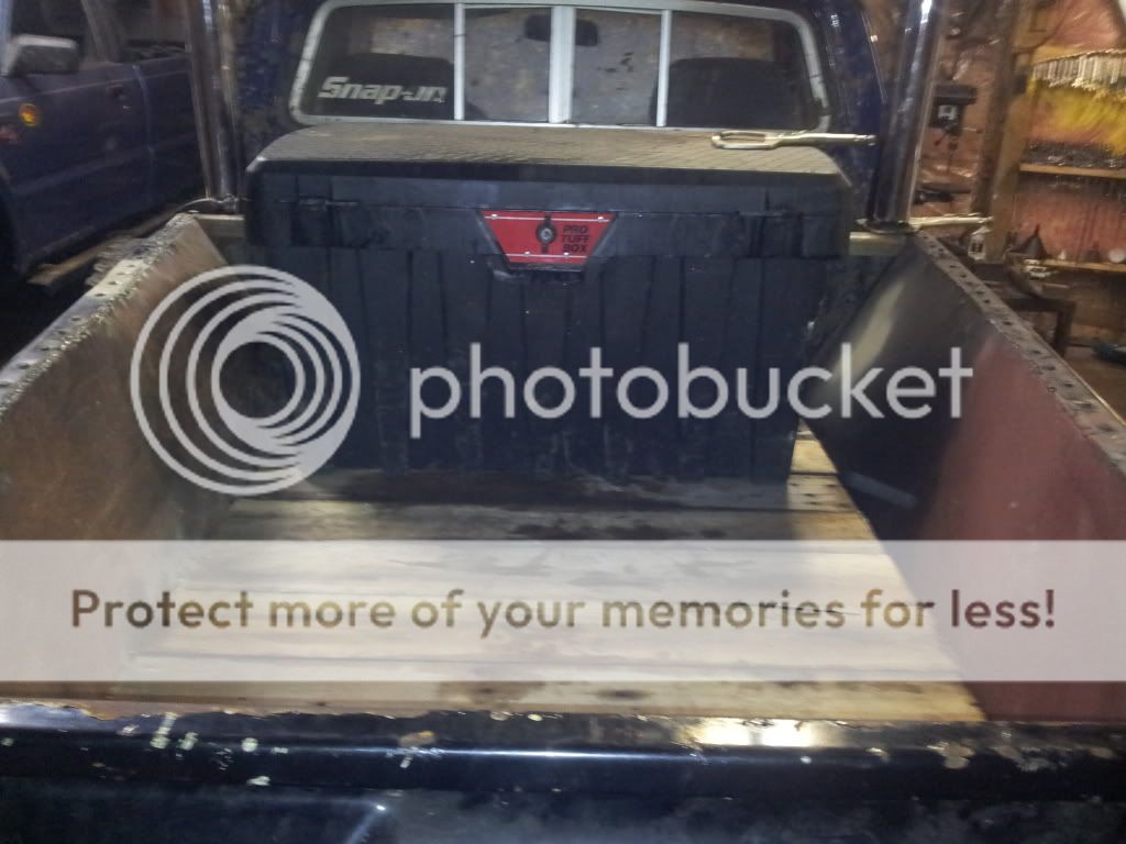

not the best picture but this was bobbed and dove tailed we just ran sheetmetal from the top of the bed rail down to the frame rails all the way down. basicly it makes the whole inner fender like a smooth triangle shape. hard to explain but it worked well and you can still use everything as a bed as long as its on top of the frame rails
if you want to get all crazy you could get it on a 4 wheel scale and see where the truck is weight biased. Try and make up for it by using thicker plate. But i think 3/4 steel as a box is a bit OVERKILL. and anything short and its likely still gonna be pretty heavy upfront. so unless you really plan on airing it out then i'm just rambling on.

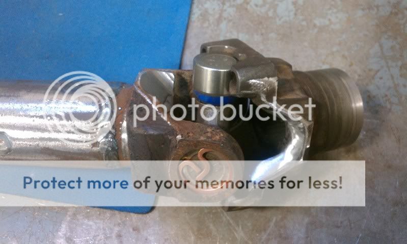

Yokes cleared and new joint installed, front shaft all ready to be put in a tested
Drive shaft installed and tested. Binds at about 1" before full droop. Need some shorter limit straps, I have 18" now, need some 16" ones.

I think I will skin out the inside of the bed, basically fenderwells, then we will go from there. Trying to keep this KISS (keep it stupid simple)
