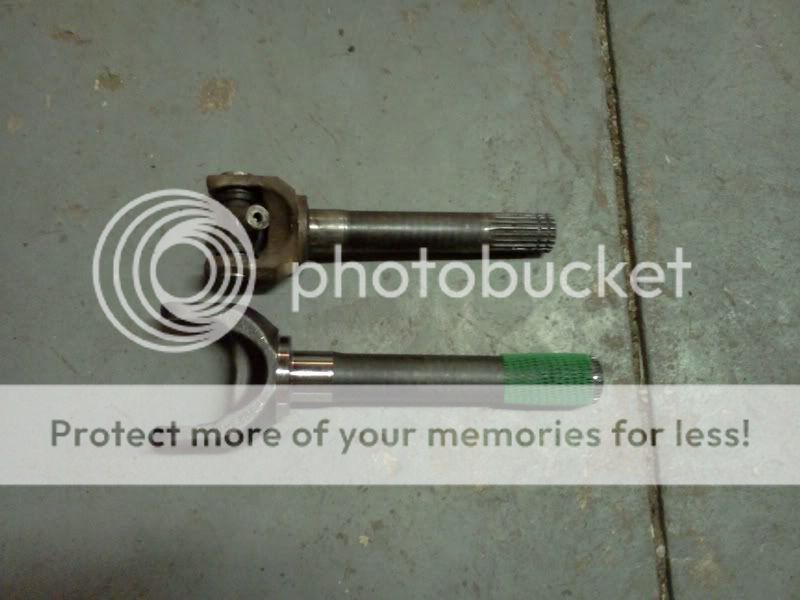

Got my 60 stubs today, looks beef! Here is a picture to compare my 44 stub to the 60.
That is why I'm swaping
