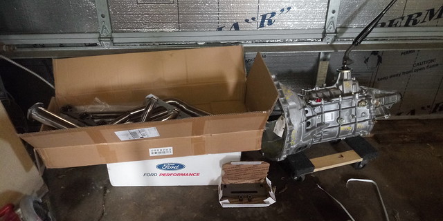

Parts are starting to come in, ive placed several orders over the past week or so and have gotten probably half of it. Fedex kinda screwed me, they have a rockauto shipment that was supposed to be delivered saturday but i think they lost it. I saw the truck pull up in front of the house while i was out back in the garden, after a few mins the truck drove away and i got a notification that it couldnt be delivered due to weather (70 and sunny) so the driver must not have a "idk wtf im doing" option on their little scanner thingy. Hopefully it shows up on tuesday like the tracking info says now.

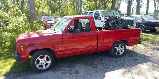

I picked up my engine today, 5.8 efi from a 97 f350. I thought it was only fitting to bring it home in the back of the ranger. I got all the computer and wiring and everything with it, hopefully i can just plop it in and make it run. Not looking to spend much time or money at this point, maybe in the future. The goal right now is to get it mounted, bolted up to a trans, get exhaust figured out, that kind of stuff. Im hoping a couple weekends worth of work to make it drivable. I also picked up another roller engine that i may "build" for a winter project. I grabbed an explorer axle from the same guy, I'll probably abuse the 7.5 for a while before i swap in the 8.8 though.

Nice...
Damn engine looks huge in the bed.
