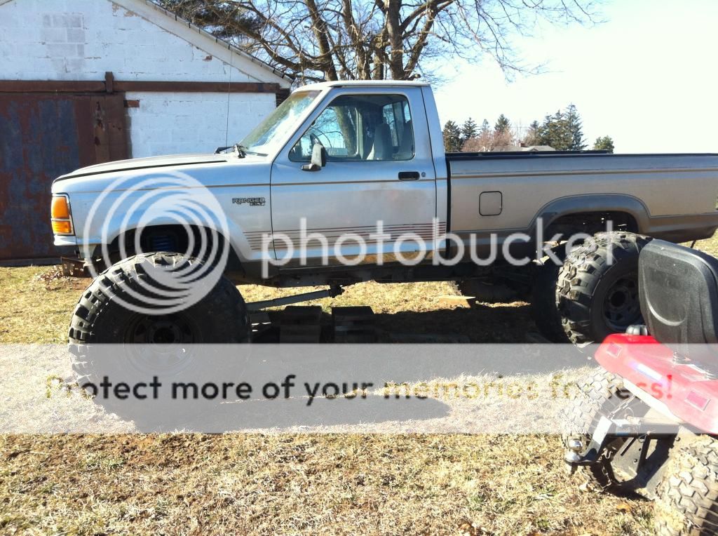

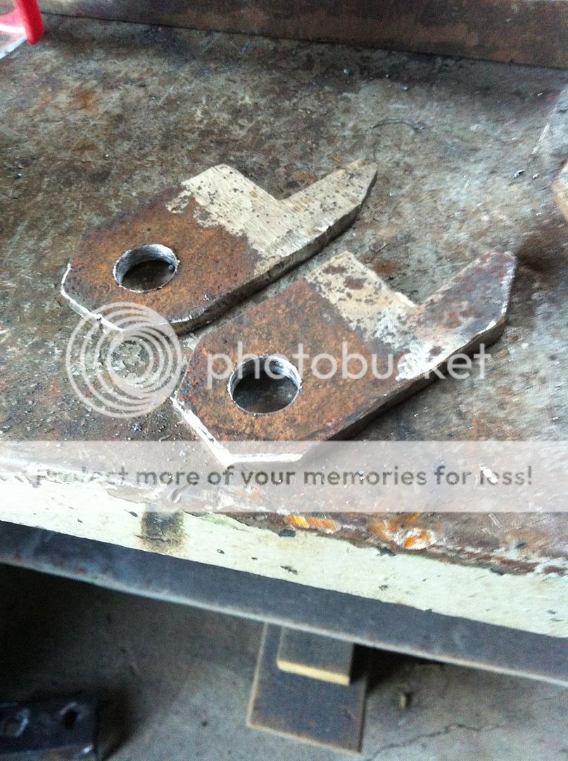

Go from a TRE track bar to one with a bolt hole, double sheer design.
Hadn't made it to the shop in a while. Went yesterday, finished my transmission xmember. I ended up cutting out the center section and flipping it so it'd set the transmission higher where it needed to be. Also cut, drilled and welded new permanent trac bar tabs to the frame.
Koty's 91 Ranger Build Thread
How's it goin? Just saw the post about your track bar. I recommend plating the frame prior to welding the bracket on and building the bracket out of .25" plate. I welded mine straight to the frame and ripped it off the first time I went out. I've got a couple pictures of how I did mine if you're interested.
With mine I won't weld to the frame, I'll just add tabs to my current mount that that has served me good to this point but will go over the welds since a few have porosity.
Ya I made the mistake the first time. That was the onlything I had welded to my frame at that point. Now mine is bolted on with 6, grade 8, 9/16 bolts.
Nice, unfortunately they've already been welded in. After hearing that I may run a couple more beads over with the 220v mig. Maybe add some sort of brace for them
I always weld mine.... just do a diamond not a square and good bracing.
Yep! Don't need any of that breaking loose. Thanks for the suggestions though!

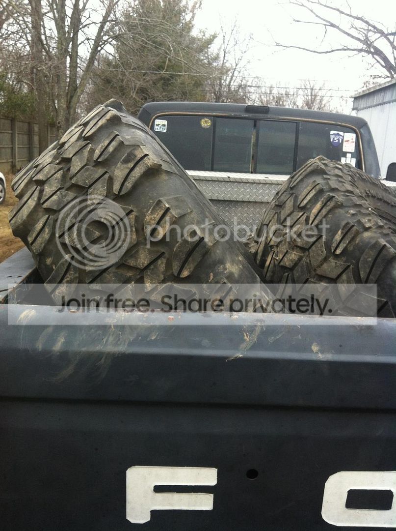

I played around with the tires alittle, and a buddy grooved them for me.
