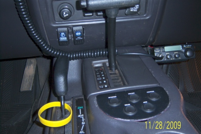

Got a firestik and a little cobra CB for christmas. Looks like my next project will be fabing up a CB antenna mount. I've seen alot of guys run an angled mount out from the hatch, and hang the CB under the dash on the passengers side. Both look clean, might do it up that way. I have some scrap (of course) stainless angle somewhere that I have a few ideas for.
Don't know how big the cb set is but I would sit in the passenger seat and hold it where you are thinking of mounting it to make sure that any potential passenger is not going to kick it to death accidentally. My son mounted his sideways on the transmission hump.
It's a cheap little Cobra 19. Here's one mounted up in an XJ how I plan to do mine.
