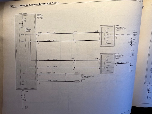

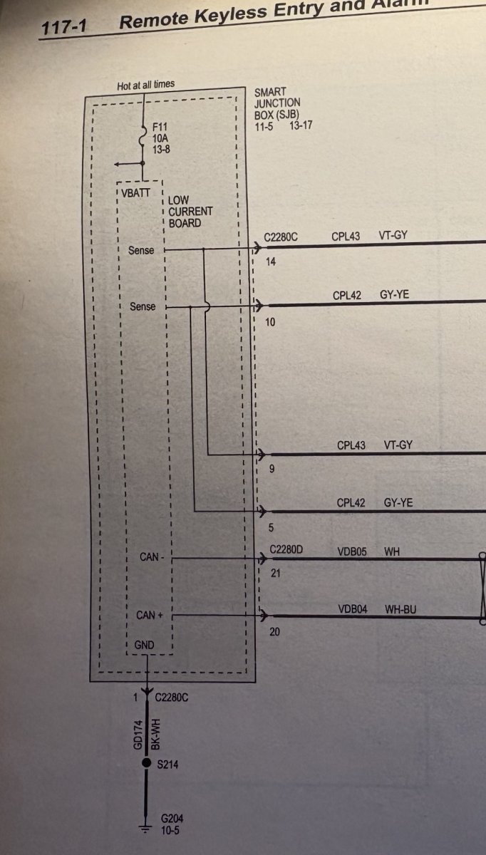

Still nothing! It doesn't make sense! According to the wiring diagram, the LC Board receives the signal from the transmitter and sends a pulse to the relay to either lock or unlock the doors. I checked the F11 fuse and it's good. Even if it was bad, other things associated with the board would not work. I can get another SJB, or BCM, but it would need to be programmed to my truck. I even tried the sequence to add a new transmitter, but the doors did not lock/unlock to verify programming mode. What I'm not sure of is, does the LC Board in the SJB actually receive the signal or does another module receive it and send it to the LC Board. The diagram below just show "Sense", so I assume it "senses" the signal. Such a freaking headache!

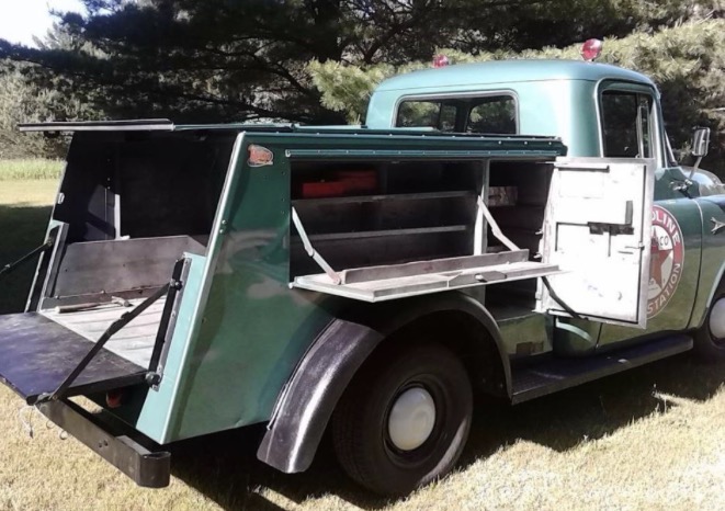

This isn’t my truck, but it’s a pretty close. The top of the bed had a sliding roof and a fold down door so you could stand a refrigerator in it, or you could lock it up tight. I bought it for 200, had a mechanical problem fixed for 100, painted it for 20 bucks, redid the wires for $10, and sold it for $1200 about four years later! Who can say that about anything today!

We put the new PCM in and it worked. However, the door locks still do not work. I tried programming the transmitter but the door lock do not lock/unlock on the eighth turn of the ignition as they are supossed to. Does anyone know what exactly receives the signal from the transmitter? Is it the BCM, IC or the PCM?
