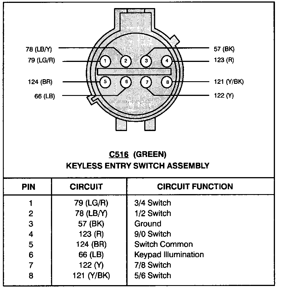

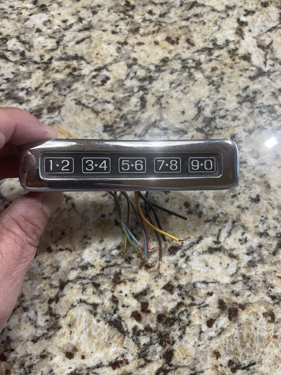

Keypad from a 1994 Lincoln Towncar. I ended up using a keypad from a 1999 Continental because the lights worked. There are 7 wires that go to the RAP and 1 ground wire.
Keypad Diagram

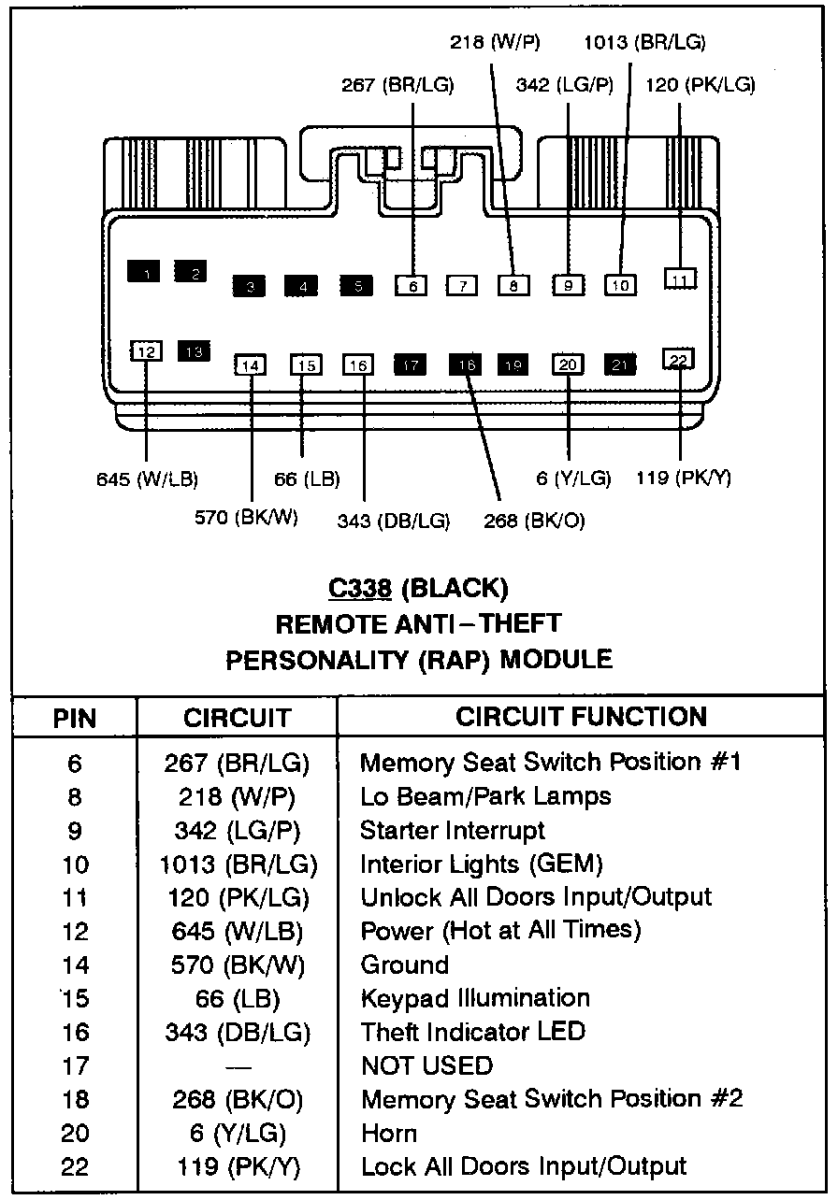

22 Pin RAP Connector-you'll need Pin 15, LB wire

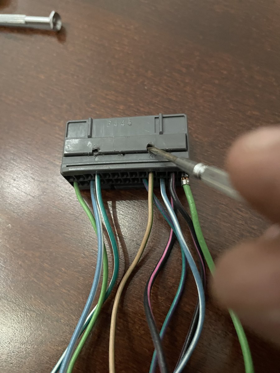

26 Pin RAP connector. You will need Pins 5, 6, 7, 8,12, 15, 19, 26 (If you don't want Autolock you can omit Pins 12 and 26)

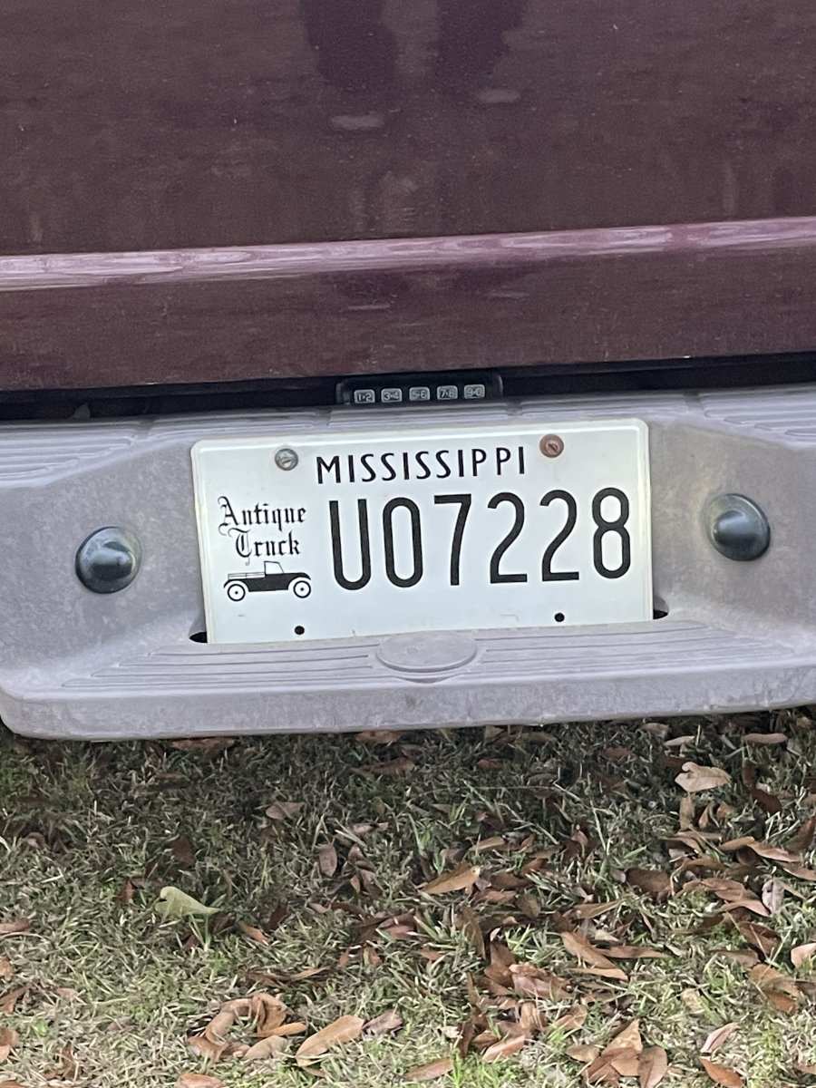

So I hooked it up roughly and put in the code which is on the outside of the module. It worked great. But I was extremely nervous about cutting a hole in my door. Because there would not be any going back if I messed up. So I toyed around with other ideas on where to put it. I really just wanted it because I wanted to be able to get into my truck if I didn’t have my keys with me. I thought about the wheel well, the front grille, or the bed. I finally picked a spot right above the license plate that would not be very noticeable, but I could easily get to it.

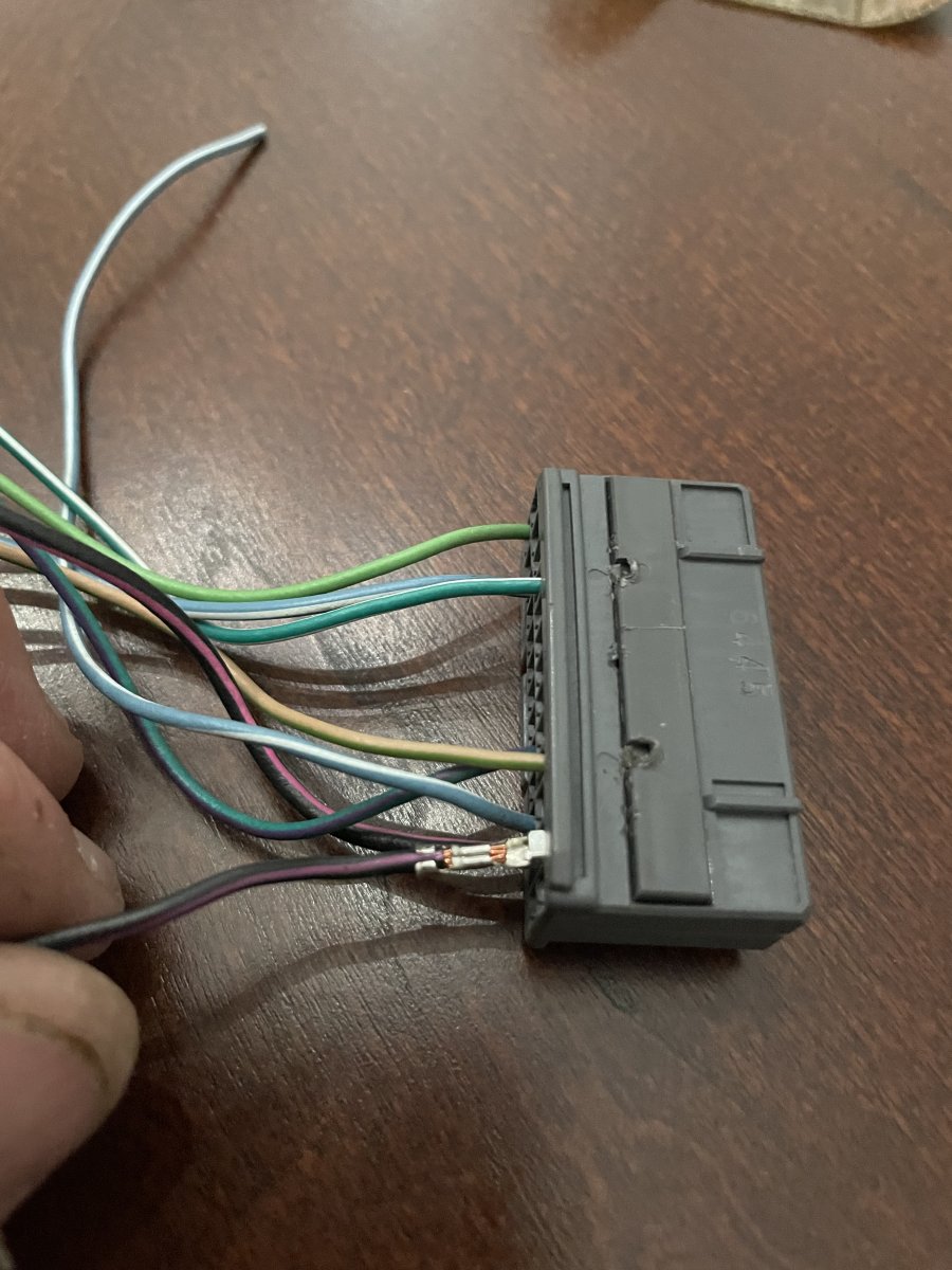

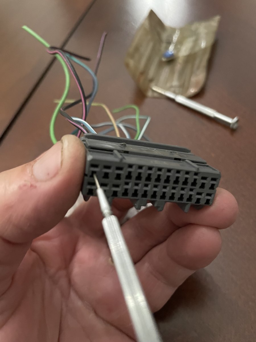

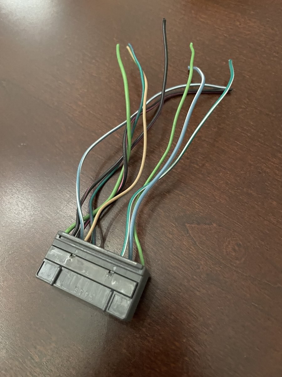

So I depinned the 7 pins from the Explorer connector and added them to my connector.

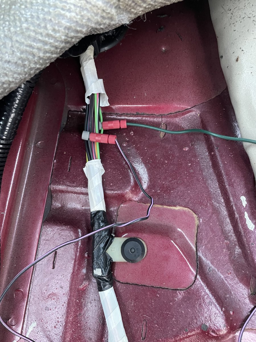

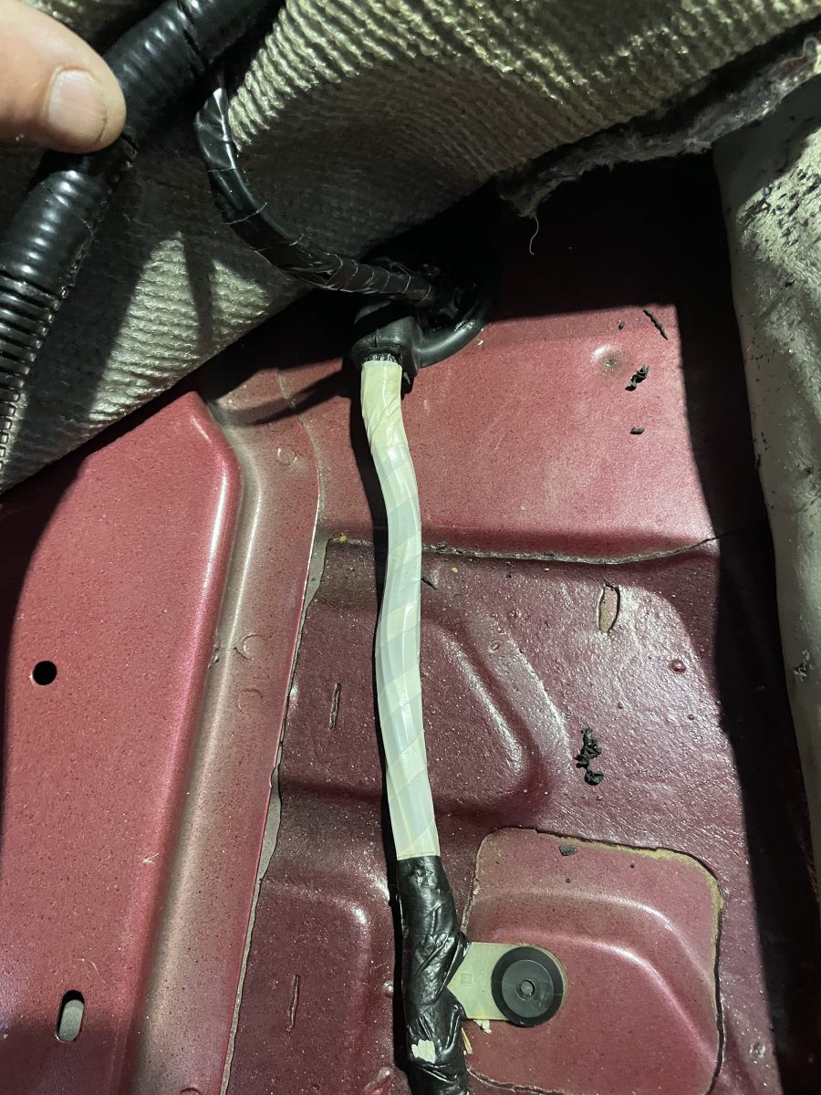

Then I ordered several feet of colored wire. I removed the driver’s seat and carpet. Under there, you will see a large grommet with a harness going through it. I drilled a small hole to the side of it and put my new seven wire harness through that.
Then I routed the harness down the frame toward the back bumper, where I attached it behind the bumper. There was a hole in the frame where I put a bolt so I could ground the keypad. This is what the finish product looks like.

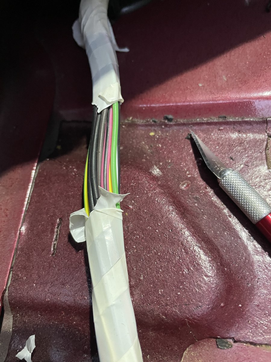

So using the auto lock feature was a lot easier. I added the two pins to my connector, a light green wire and a black/pink wire. Remember that original harness that went through the big grommet under the driver seat? The two wires you need are running right there. So I carefully opened up the loom and found those two wires. If you do this be very careful not to cut anything. Also, there are two other wires that are light green but have stripes. I triple checked to make sure I tapped into the right wire. There is only one black/pink wire in there so it was easy. there is a pink/black wire so don't tap that one. These two wires are for the reverse light and the brake light. So I tapped into those two wires and then taped everything up.
