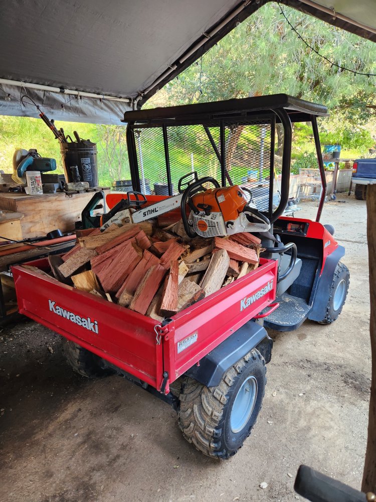

So I got a utv for the yard, and it has been coming in really handy. Nice machine, just needs a little love.
I'm sure some of you out there are familiar with these things....I am not. Figured maybe I can get some info here.
Seems to have a common 286cc engine.
I want to do an oil change, can I use the same stuff as I put in the motorcycles? I have a variety of good moto oil.
Its runs like its suffocating. I heard theyre jetted very lean. Can I make adjustments or do need to buy jets/kit?
Also its hard starting, do these have a fuel pump/prime system of some sort?
Any info is appreciated. Cheers.

I think its '01/02
Its a carb, and looks more like something on my pressure washer than a motorcycle.
Air filter looks good. Not sure what checking the fuel filter means on this thing yet lol.
