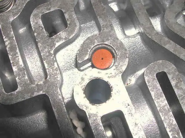

Question though for all those people who installed a transgo kit: The valve body did come with a very small aluminum cylinder with a pinhole in the end of it. It was described as ready to install right away, so I didn't try to put it anywhere. The body had the transgo shift kit already installed, so I assume it may have been extra or a part of the kit. It is about the size of a pencil eraser, and is hollow with a small pinhole in the top of it. Does anyone know where this goes or what it does/is? The valve body came with no instructions since the kit was already installed. Or if anyone has the transgo installation instructions around they can scan to a pdf I'd be eternally grateful! Thanks guys!:icon_cheers:
Glad you got it going. I'm not sure of the part you are describing, maybe if you can post a pic...
SVT
I was going to take a picture before, but I didn't want to go into the transmission fluid covered stink bag holding the remnants of my long lost troubles if I could help it...:icon_thumby:
So here's the best pictures I could get of it. My camera really sucks, but it's the best I can do. Hopefully it is adequate!

So while looking through the 5r55e rebuild diary over at explorer forums, I found these pictures.
Just bought a truck, need tranny help!
This looks eerily similar to my cylinder, but it looks kind of flat. Mine looks like it is longer than this, but it could recess into the valve body. Anyone know what this puck looks like removed? Or better yet, what the heck it does? I'm hoping if it was missing altogether I would definitely know it.
EDIT: I just found this other picture that shows a shallow puck, which I believe is the one in the previous pictures, but also a taller cylinder that is supposed to, quote, "restrict flow to the intermediate band". I highly doubt this is necessary, or really something I would want in a shift kit, but I suppose transgo thought it was a good idea. Here's a pic of them side by side with the rivet from the kit.
It looks like a restrictor/limiter used as you stated. My guess would be since it came with the shift kit, it allows the shift kit to be tuned to shift more firmer or shift softer, but I'm just guessing. Maybe contacting the shift kit company can shed some light (and correct info)...
SVT
I emailed the dude I bought it from on ebay. He got back with me but not with the instructions. Apparently he was surprised it didn't come with any...I'll post back when I hear in case this happens to anyone else buying with the shift kit installed. He's supposed to send me the instructions for installing the puck, but it is taking him a few days. It is actually surprisingly hard to actually find the instructions for these shift kits without buying one. In the meantime, I'll be working on getting rid of all that rust in the cooling system...
So here is what this little painfully easy to overlook part does:
"it goes in the front servo feed hole which is above the valve body it is just a extra to the shift kit and is not necessary"
So it actually fits in the passageways above the separator plate before you mount the plate up. Didn't really think to look there. Oh well, it's not hurting anything, so unless I want to firm the shifts up a little more, I'm going to leave it be until the next fluid change. Then I may drop the valve body and stick it in. Or leave well enough alone, considering what I've been through...:annoyed:
