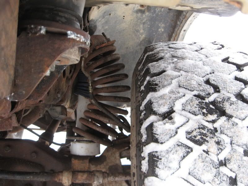

well the ranger didn't fair so well.........
on the first run through the woods, he was doing a slick hill climb and caught the LF tire against a tree and walked the tire up about two feet and almost layed it over. And when hitting the tree the LF coil went SNAP
guess the 30 year old decided it had enough, later he had a starter problem and ended up packing up and heding home early
and the coil bucket bent way out after the bottom rung snapped, snapped just past where the coil was secured to the beam, so it was loose
very very nice carnage
the bottom of the coil snapped so new coils are in the works
yeah that was a hairy ride up that tree but after the coil broke i am now gonna just go with some straight axles. i bought a 9 inch from a town car that is coil sprung so im gonna do a 4 link in the rear and hopfully do a HP 44 in the front. still in the works of finding the front axle and supplies to build the 4 link. any leads to a cheap 44 would be awesome doens't matter if it needs gears or a carrier or somethign like that i plan on chromoly shafts and taller gears maybe 4.56 or 4.88 i love torque.!!
