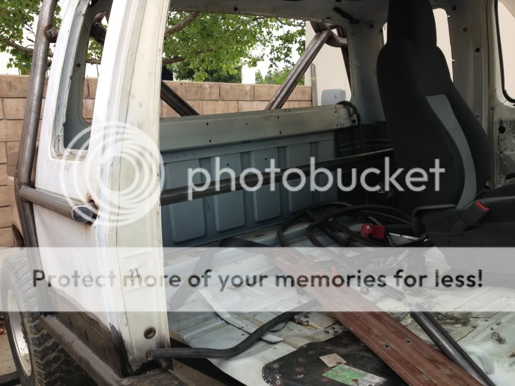

Really want to do some type of body protection, without an entire exo cage.

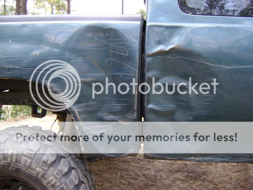

The most difficult portion will be the one place that seems to get the most damage... The rear doors.

Trying to get an idea of how to do this, but still keep both rear doors functional. I mean, I went through all this work to change the body, I want to at least reap the benefits of it.
I don't want to end up with this

Josh, what about making a removable tube just for the xcab doors? You can make a T bar that runs from top to bottom between the front and xcab doors, then run a bar just below the glass height to the bed. You can use those clamps Ian used on the curvy buggy project that goes over the engine. Use those clamps on the 3 attaching points of the T section. This will limit use of the xcab doors whilt out on the trail, but it will give you the body protection you want, and just a couple seconds and 3 bolts later, they're off allowing 'street use'. The storms have done quite a bit of damage here, I'm pushing to get it done for this weekend, but its gonna be real close, still haven't fixed the bridge yet, got more rain this weekend...
SVT
The only thing about that is I know me, and I would forget it at home one trip, go wheeling, and tear up the door, so the only way that would be feasible is if the removable sections were stowable on the truck somehow.
I also have a gut feeling that the fuel tank mounted on the frame is going to get in the way of the driveshaft again.
We can make a holder on the inside bed rail, and the fuel tank can be modded, or replaced with a fsb tank...
SVT
SVT
It would still need to be collapsable to fit.

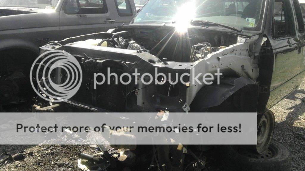

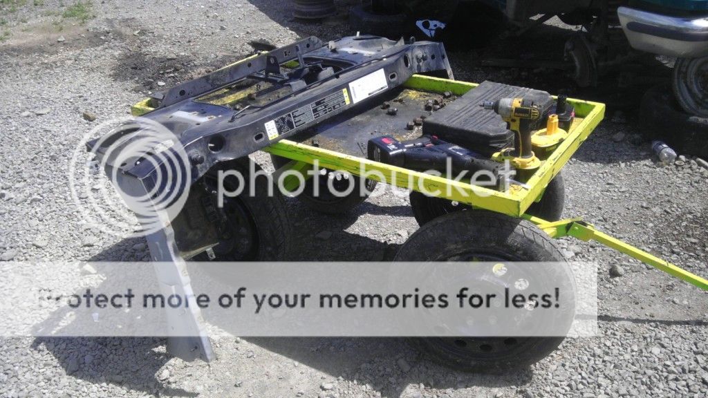

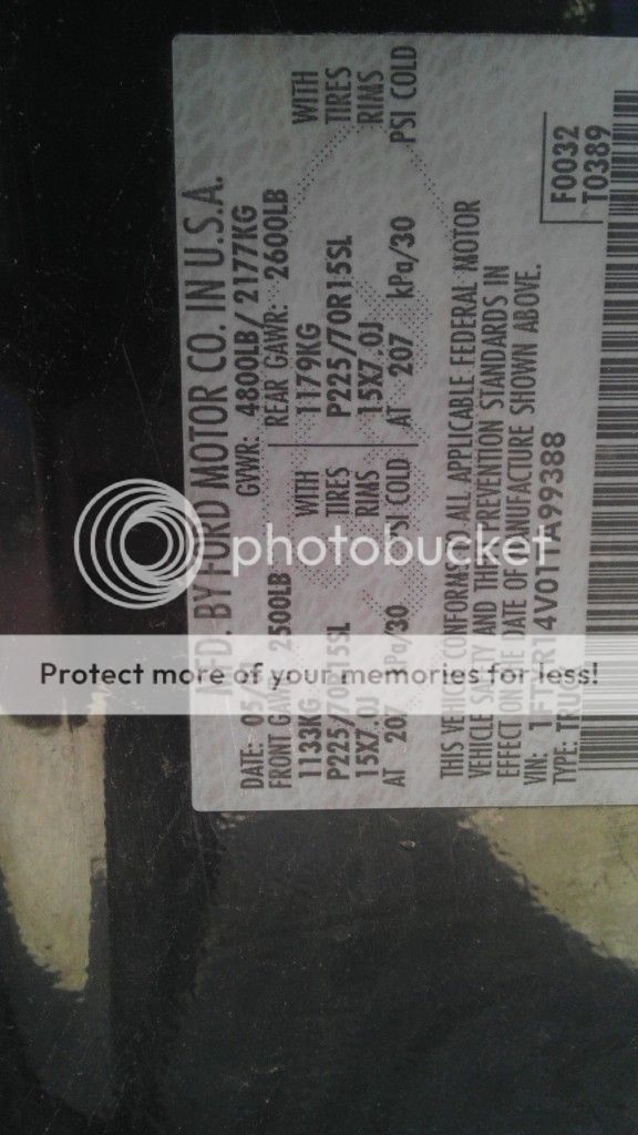

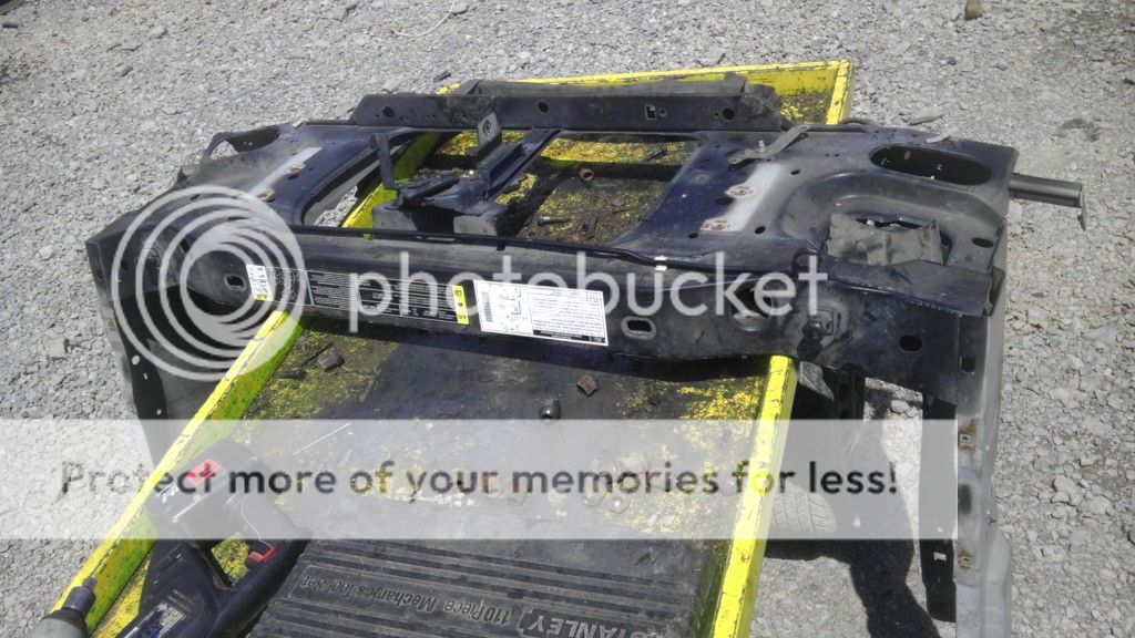

I finally found a good core support, and as it turns out its the same year as the cab, even has the same motor and trans (3.0/auto)...
Here it is out and on the dolly...

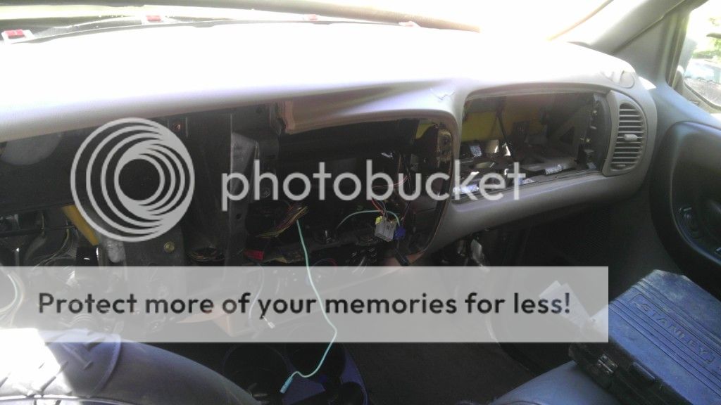

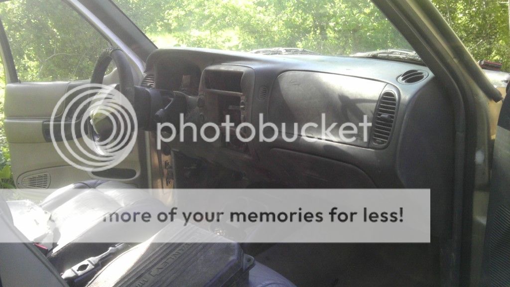

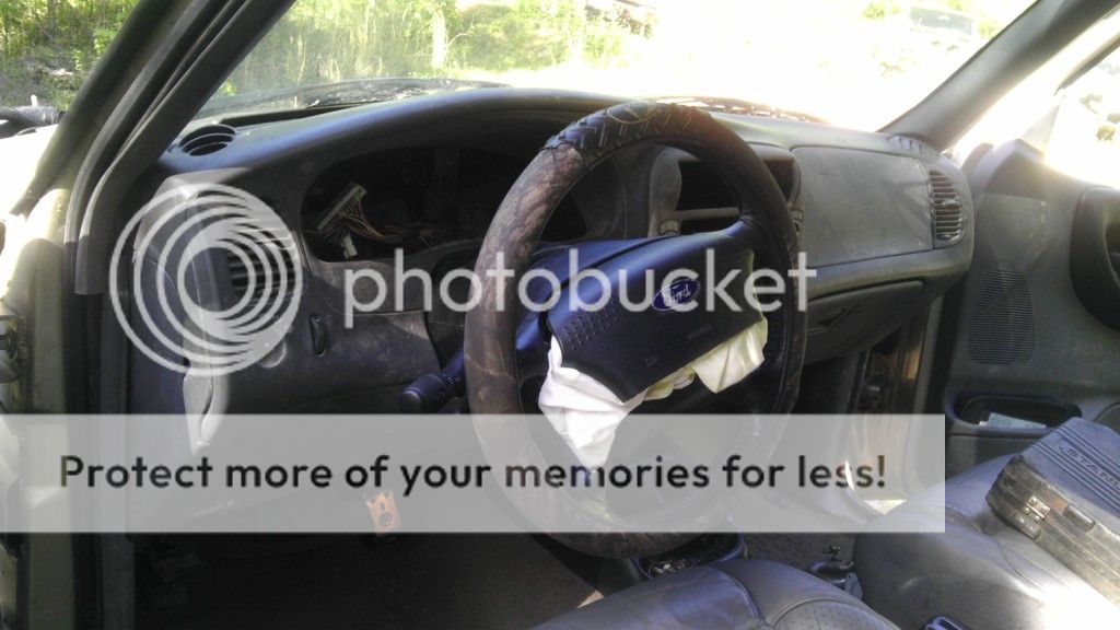

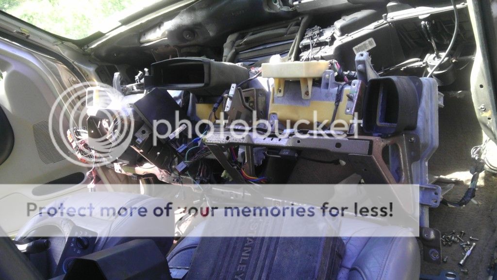

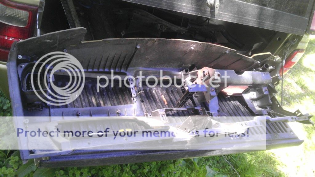

So that was pulled Friday. Today I decided to get the dash swapped, as it shouldn't take too long. Little did I know Josh decided I didn't have enough to do and made it even harder on me by taking every nut and bolt out of the dash frame except the four or five on the backside. Since it only has 7 bolts holding the dash to the firewall, I started pulling the dash...
Since I had to pull all the bolts out of the old dash, as Josh didn't save the bolts from the grey dash he pulled, I left the frame and wire harness in the truck...
Finished pulling the grey dash pad from the frame...

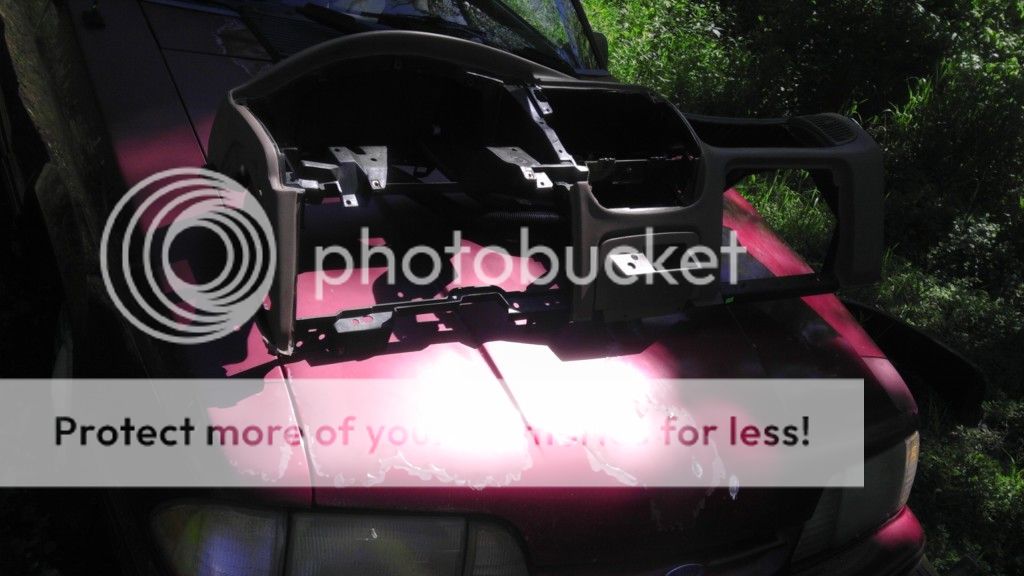

Then after a few more hours of installing all the bolts back into the dash frame, the dash was swapped...
For those with good eyes, you will notice the instrument cluster is not installed. The cluster trim panel, knee panel, and radio bezel are just sitting there as I still need to swap the wires over for the tach. I stopped here for the day, as I'll be back on it Tuesday and swap the wires and install the cluster. Monday is grass cutting day.
