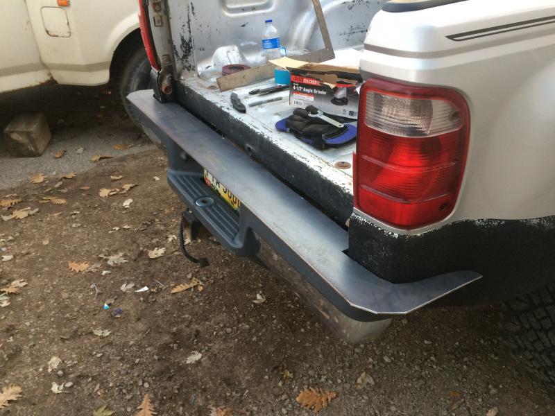

Made a "custom" rear cross member after the factory spare tire carrier/crossmember rotted away on me. I'm in a constant battle with rust.

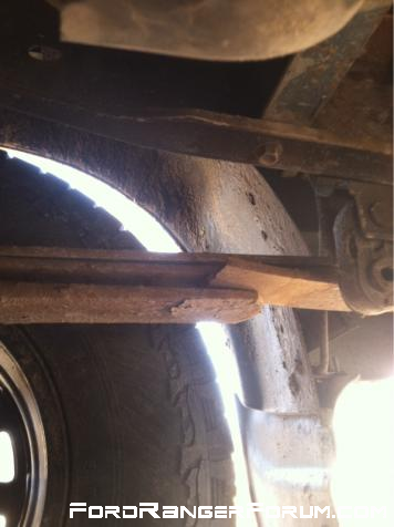

Broke a leaf spring. Don't know if this was from doing dumb stuff or not. Probably was.
jimmyspy's 02 4x4
So, I put on a set of junkyard explorer springs and belltech 6400s. I was also able to ditch the factory lift blocks.

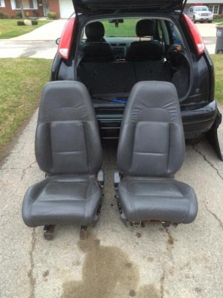

Bought some expo power/leather seats

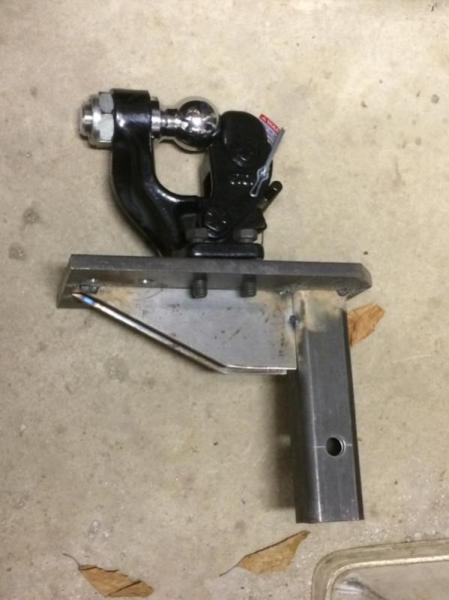

Built a pintle mount

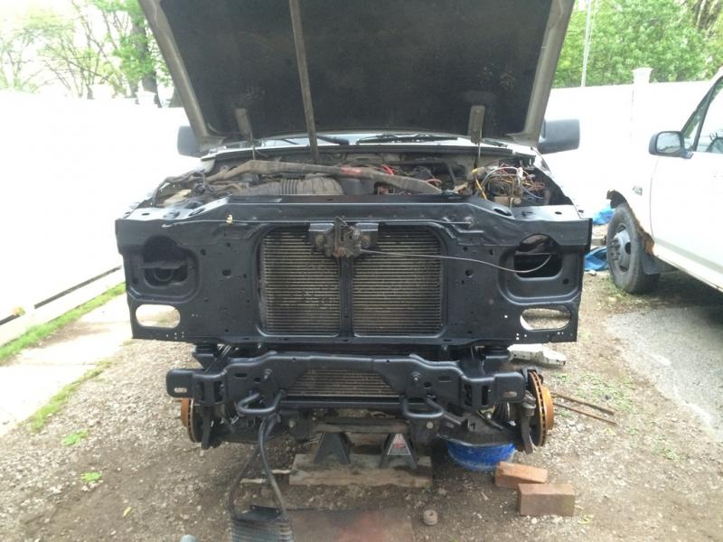

Ok, so we left off with coil overs and things being purchased. I got a good deal on the coil overs from a member over on FRF (brand new, never on a truck) and that got the ball rolling... slowly. To be honest, I had everything sitting in the garage by February, but didn't "break ground" until late April. But, that's the life of a shade tree mechanic. The shocks are Fox 2.5 emulsion coilovers (I can dig up part numbers if anybody needs them) and the shock brackets are RCD originals that have been around the block a few times.
The truck was also in desperate need of a new core support, so I figured as long as we were tearing some stuff apart, we might as well tear it all apart.
Started off stripping most of the front clip off the truck.
jimmyspy's 02 4x4
These next few really show how bad the core support had gotten. The Ohio winters had not been kind

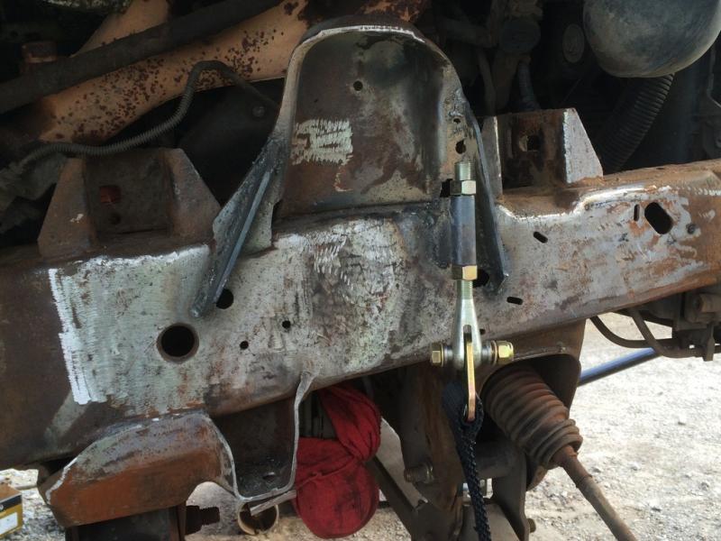

Here are the passenger side shock tower gussets and upper limit strap mount.
jimmyspy's 02 4x4
Lower limit strap mount. You may notice that it's very close to the sway bar mounting hole. There is enough room to sneak the end link in there, but I don't run the sway bar.

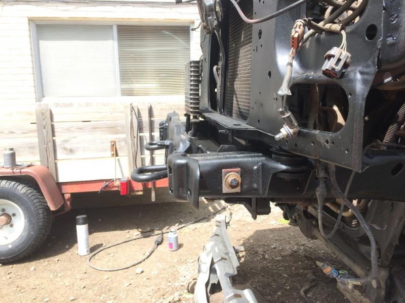

Front receiver back in.

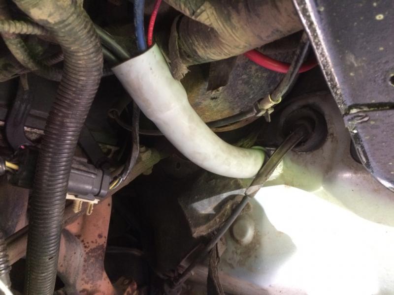

So previously, I had wires running through every hole and grommet I could find in the firewall. This looked awful, was a big chafing risk, and caused a lot of leaks (of both cold and water) So, I took a panel mount fitting for 1" conduit and punched a new hole in the firewall. I topped it off with a 90 degree elbow turned up to keep the elements out. Moving forward, I made need to step up in diameter or add another one, as the 1" is about at capacity now.

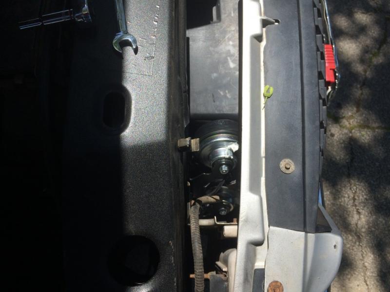

Here's a pic of the f250 horn I threw on during my rushed preparations.

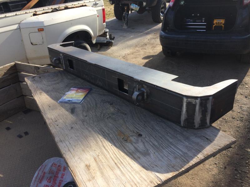

OK, last installment(ish). We left off with some things being purchased. They were for a rear bumper project. After looking for a rear bumper with a swing out tire carrier for a ranger, and being sorely disappointed, I decided to build my own.
I started out by cutting the general shape out of a piece of 3/16th plate (don't hate on my "top of the line" work station lol)
jimmyspy's 02 4x4
jimmyspy's 02 4x4

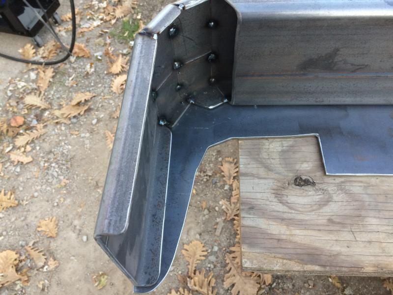

I opened the corners up later on so they wouldn't dig into the bedside
jimmyspy's 02 4x4

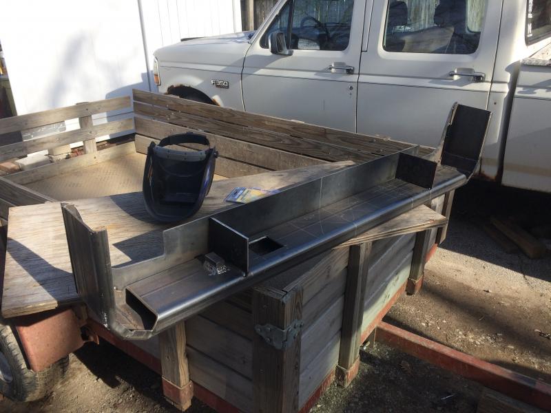

Then I cut pieces of 2x6x3/16 tubing to make up the body of the bumper.
jimmyspy's 02 4x4
jimmyspy's 02 4x4
jimmyspy's 02 4x4
jimmyspy's 02 4x4
jimmyspy's 02 4x4

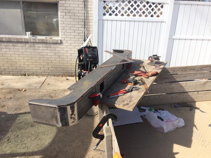

Here's all the tube tacked together and tacked to the top plate
jimmyspy's 02 4x4
Here's all of the pieces for the frame tie-ins. These were cut out of 1/4" plate.
jimmyspy's 02 4x4
Frame tie-ins welded together and mounting holes drilled.
jimmyspy's 02 4x4
jimmyspy's 02 4x4
jimmyspy's 02 4x4
jimmyspy's 02 4x4
Frame tie-ins on the truck
jimmyspy's 02 4x4
"Test Fitment" (I was really just getting excited to see it on the truck haha)
jimmyspy's 02 4x4

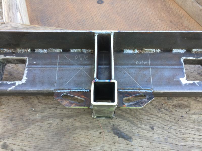

Next, I cut all the required holes in the tubing for the LED pods, clevis mounts, and the bumper mounting plates.
jimmyspy's 02 4x4
jimmyspy's 02 4x4
Clevis mounts welded in and mounting plates tacked in place
jimmyspy's 02 4x4
Then I boxed in the LED pod holes and welded in the mounting plates.
jimmyspy's 02 4x4
This one shows the tapped holes for the LED pods
jimmyspy's 02 4x4
So the rolled edge of the tubing against the flat plate posed a bit of a problem. I ended up just laying several heavy beads in the little valley and grinding them smooth. Quite labor intensive, but it turned out well.
jimmyspy's 02 4x4
Another test fitment and some eyeball measurements. The hitch receiver was also tacked on.
jimmyspy's 02 4x4

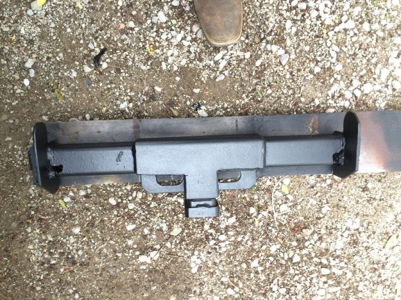

Then I got the receiver, safety chain brackets, and bracing welded in.
jimmyspy's 02 4x4
jimmyspy's 02 4x4
Final test fit before drilling the mounting holes.
jimmyspy's 02 4x4

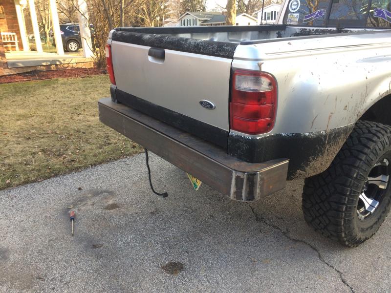

After drilling the mounting holes, I bolted the bumper on and started in on the tire carrier.
jimmyspy's 02 4x4
Drilling the hole for the spindle was quite a pain. It had to go through 2 layers of plate and a few welds.
jimmyspy's 02 4x4
jimmyspy's 02 4x4

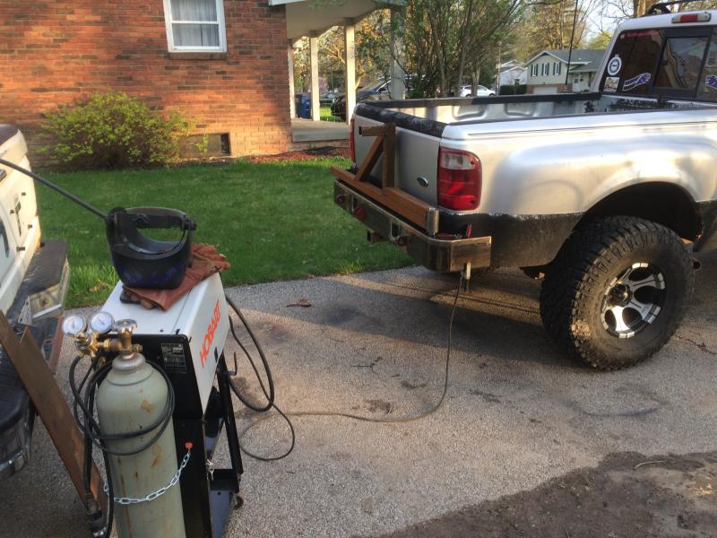

I don't have any pictures of the final welding on the carrier (I was in a rush haha), but here's the final product all painted up.
jimmyspy's 02 4x4
jimmyspy's 02 4x4
I really love the way the bumper turned out. It was a ton of work, and took forever, but it was well worth it. Although, I am very jealous of the aftermarket support the jeep guys get haha
