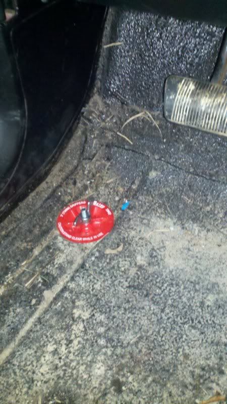

I used Herculiner for the floor in my XJ after I fought the small rust patches. Its been done since August and still looks new even after winter abuse and hauling parts. To clean it, I removed the big 3" OEM plugs in the very front corner of each floorboard and replaced them with 3" pipe test plugs from Home Depot; just remove the plugs, rinse the interior down, spray with purple power, scrub with tire brush, and rinse.
I planned on taking the rubber plugs out when I did the bed liner, but I was going to reuse them. Do you have any pictures of the pipe plugs you used?
Ill edit this post and post them up in about an hour :icon_thumby:
EDIT: Here you go: (excuse the "clean" floor)

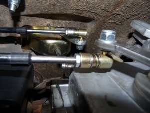

I ordered a Novak cable shifter kit for my transfer case today. I got tired of the 4-Lo popping out and the shifter linkage coming out of its brackets.
I got lucky when I called. They had 2 in stock. Novak said they are selling off the shelves as fast as they can get them.

Stock Shifter Linkage:

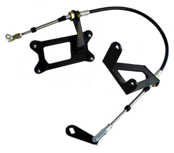

Novak Cable Shifter:

I got my Novak shifter in today. This thing looks beefy. I can't wait to get it installed as I have a trip planned for Sunday. Too bad it is going to have to wait until tomorrow after work to install it.
The Novak shifter replaces all the brackets (transmission, body, and transfer case) that the stock shifter uses and replaces the linkage with a cable.

I got the Novak shifter installed tonight. It was actually pretty easy to install, it was the adjustment to get it to shift right that was the hardest part.
It shifts amazingly well. It is VERY smooth through all the selections. I wish they made one for a Ranger so you could see how well it shifted. This would be a good replacement if you couldn't find a BW1354 shifter.
