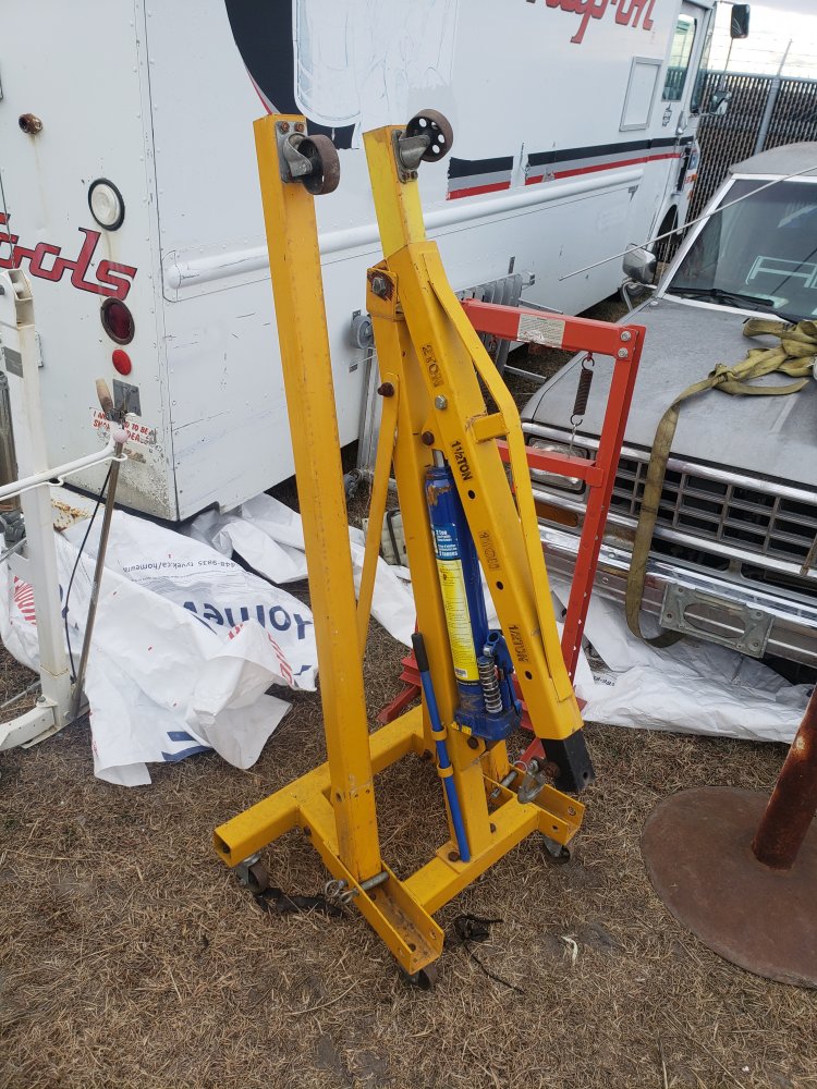

Basic engine hoist folded up.

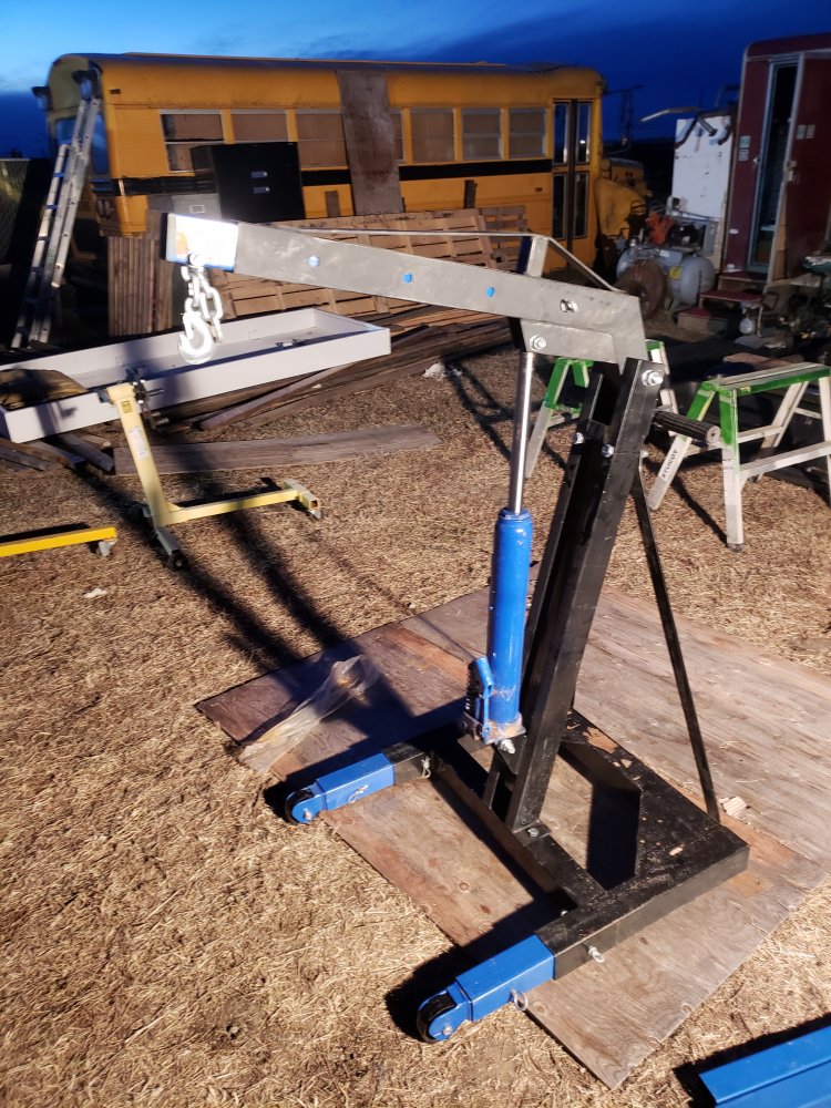

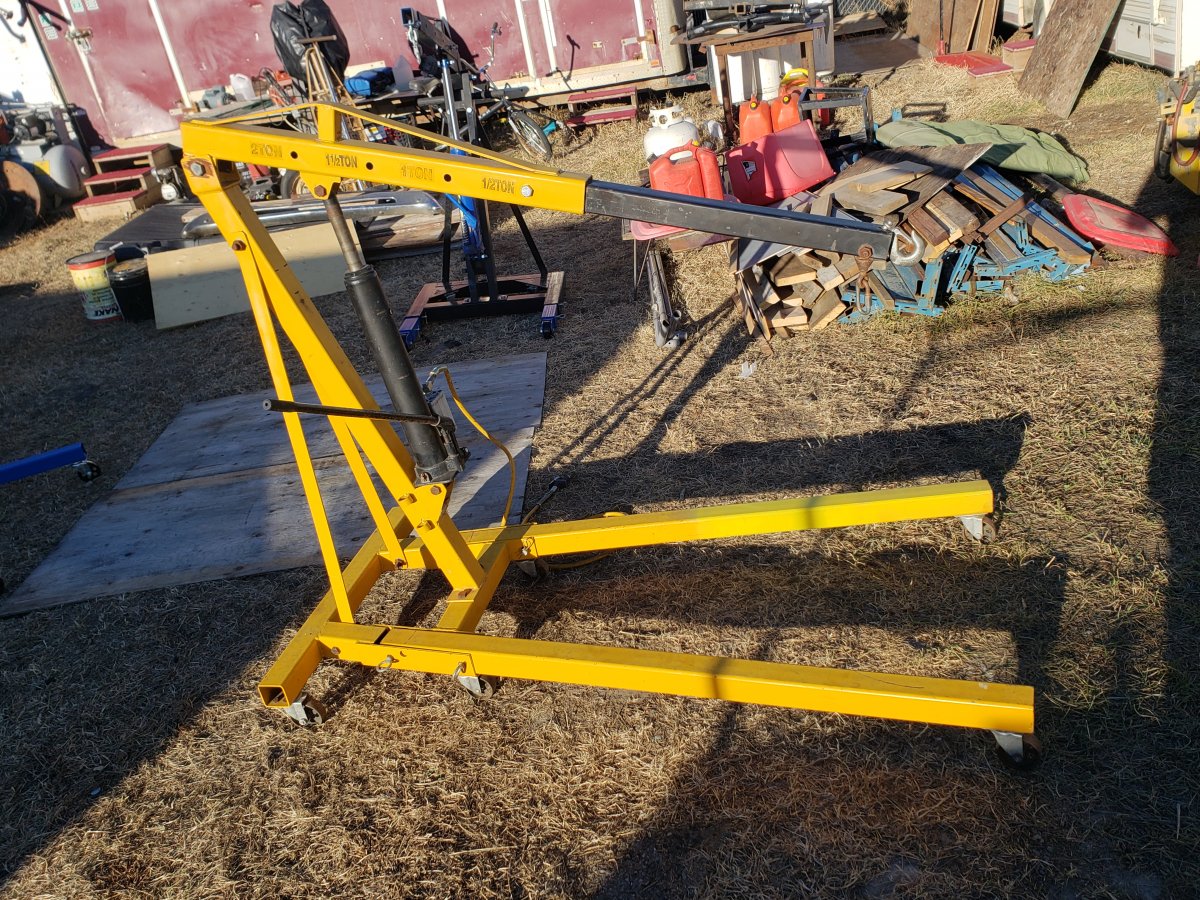

Basic engine hoist ready to work

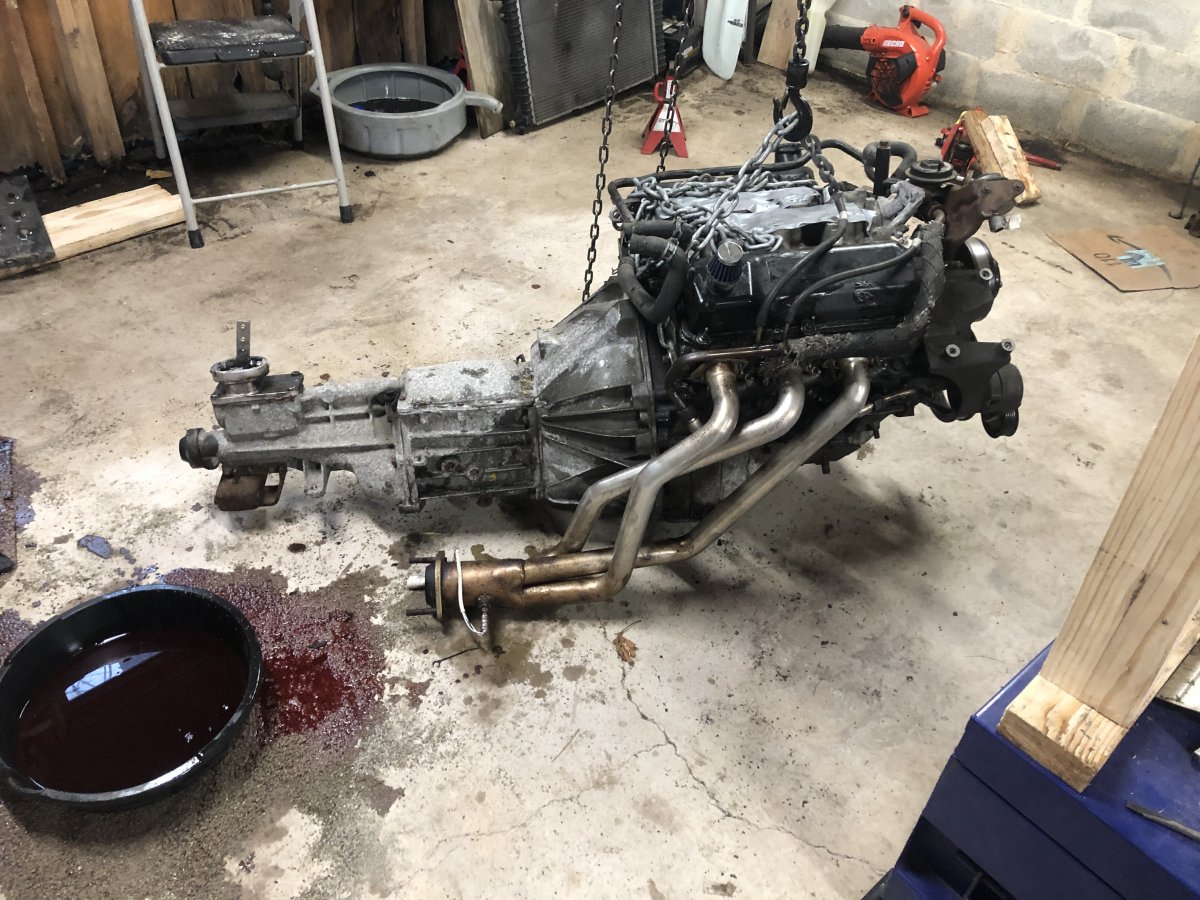

Low profile engine hoist meant for lowered or vehicles without much room under the bumper. The legs and boom extend.

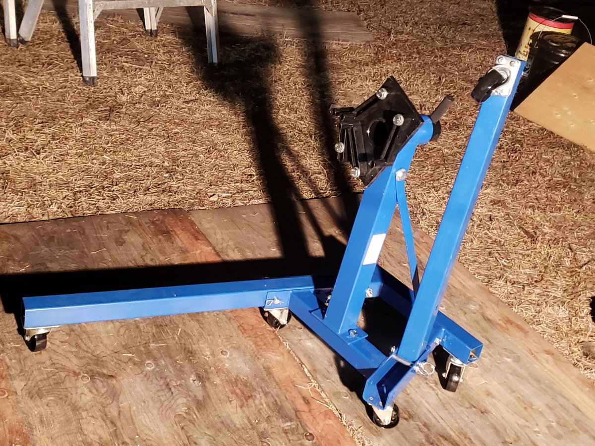

Foldable engine stand

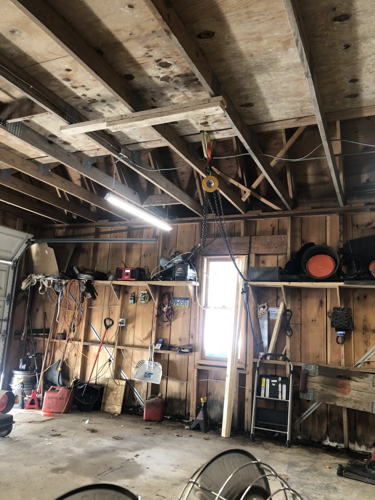

What do you have that chain hoist connected to?
There is a 4x4 running across the joists to spread the load, I have a lifting strap wrapped around the 4x4 and the hoists hook goes on the strap.
I also put up a couple of 2x4 in the middle of the garage to support the ceiling because the joists do not go all the way across, they are stapled in the middle.
