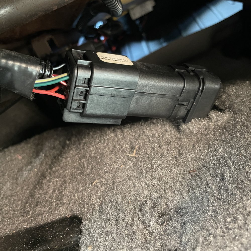

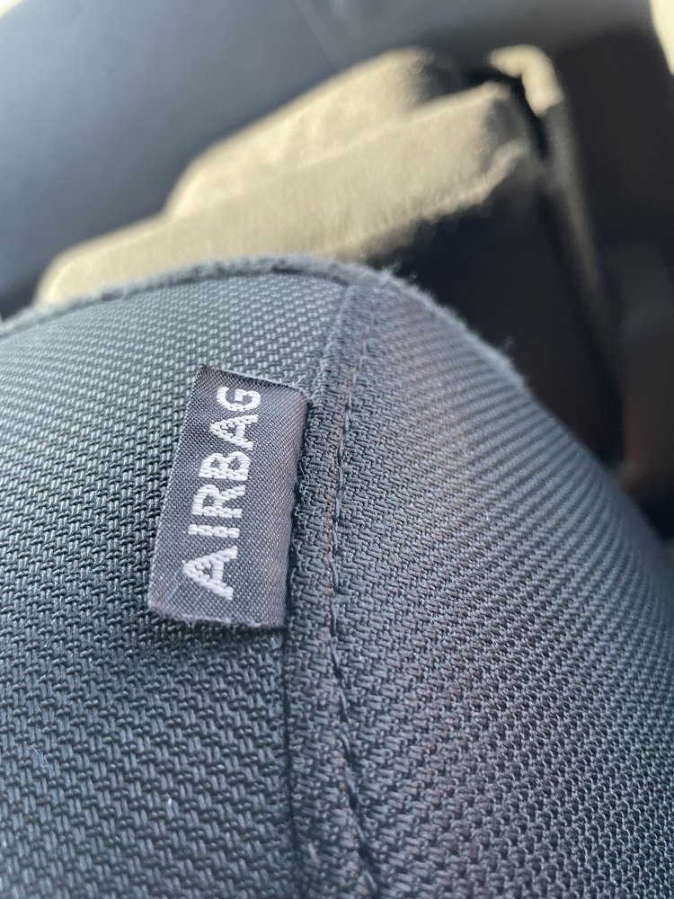

Okay, I know, another thread on seat swapping… Basically, I want to do a seat swap on my ranger. I have 2010 60/40 cloth bench seats, and I have read threads and articles on what fits. But my truck has in-seat airbags, and from what I can tell most of the seat swap threads don’t deal with seat airbags. I don’t know when the ranger started having these, but are there any other ford seats that have airbags and the same connector?

hmm, probably better to hit the junkyard and check out what looks good and has the bags. than you can just cut and replace the mounts
Might want to look on the Explorer aisle
I think it was just 2010 & 2011 for the side air bags in Rangers. Thus why not a lot of discussion on them.
Not only will you need to see what Explorers have those but if the connector is the same. Then there is the question of rail compatibility as far as foot spacing and/or if the original seat rails from the Ranger can be swapped over to your new seats.
If your swapping to non-airbag seats then you can add a resistor to the airbag connector to trick the computer into thinking they are there & not have a dash light. I have a pile of resistors, just have to get what Ohms they are. I know its not your original question, but just some info if you need it.
FYI, a 2010 Mustang has the same connector. Likely 2010-2014 Mustang seats would have the same. The mounts are different, but the Stang seats do look good in there. 100% need a center console set up & fab some mounts, but I did try it out ;) I would assume Ford did not do many changes to the airbag seats, so anything in that general area is probably going to be the same.
Thanks for the info. I was also looking into ‘10-11 Crown Vic seats too or just having the stock ones reupholstered. As for the explorer seats, there aren’t enough 2010+ explorers in yards near me lol. I wasn’t even worried about the airbag light, but I don’t know if it’s just a stupid idea to remove airbags, I mean it’s just from the seats, right? But I’m going to look into Mustang seats now 👍🏽
