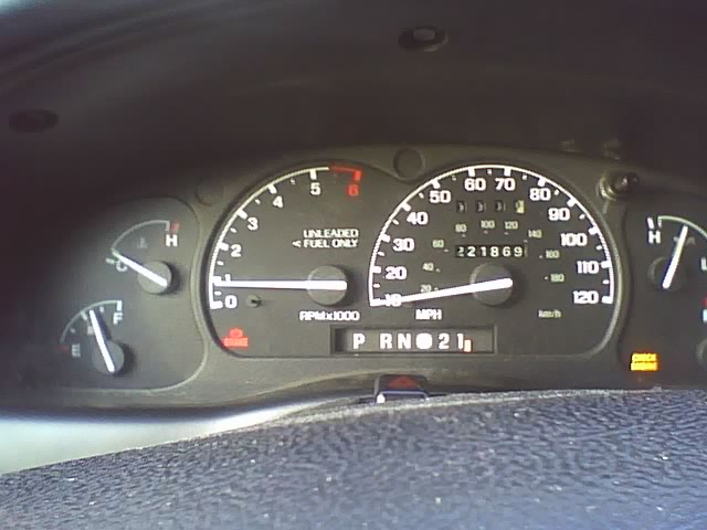

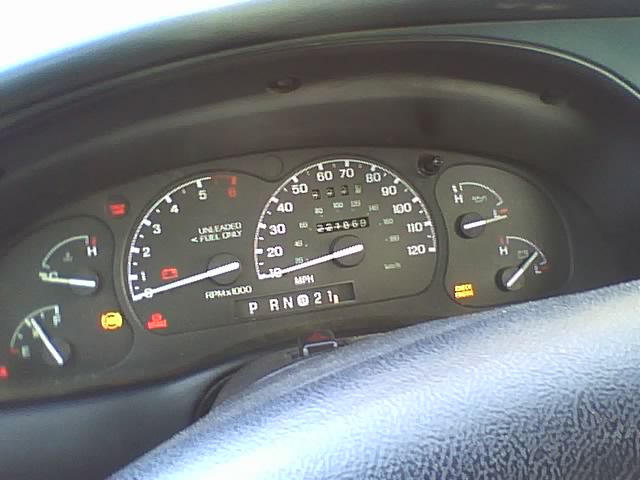

But as promised, here are the pics. One one pic, I have the key on the ON position. As you can see, the only thing that is not on is the airbag light because it comes on and turns off fast (and the Door Ajar is outside the pic, but it turns on). The other one shows the truck on Idle (Damn you Check Engine code P1443:bawling:).
