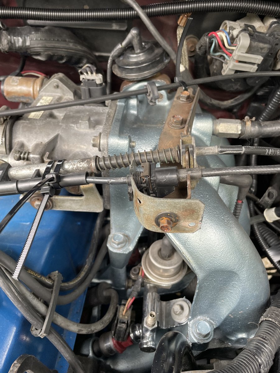

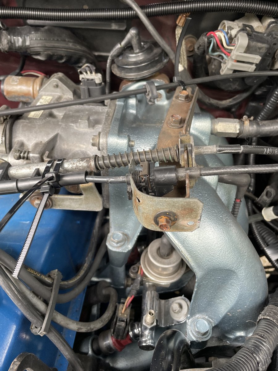

The cruise actuator cable for a 95-97 2.3L is rare and discontinued since 2004. The 3.0 Ranger cruise is the right length, but the center cable is too short. It can be adjusted, but the latching pin needs to me moved. it's goofy, but works, until I can turn up a correct cable.

Since '95 -'97 2.3L cruise actuator cables are just not out there, I used one from a 1996 3.0L. You can see how I "adjusted" the cable, by moving the serrated part way out there, towards the throttle body lever, then cramming the horseshoe over the whole mess, in the wrong spot. Maybe someday, I'll find the right cable, but for now, it works fine like this.

@flybeech, if you are still around, can you repost the pictures of how you used the 3.0 cable on your 2.3?
Thanks! Great post!
Here is how I got the 3.0 cruise control cable to work on my 2.3.
