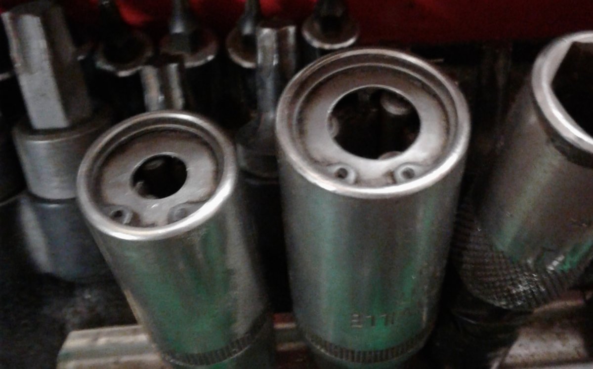

These are the extractors I used in my VW shop. Lots of 8 and 10mm studs to remove and install.
They're not perfect and will damage the stud threads if they're hard to get out.

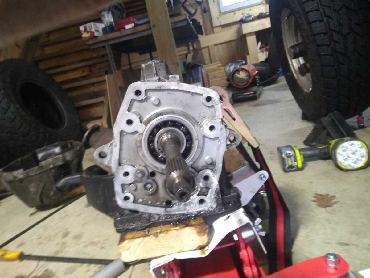

So I got the plate off:
35614

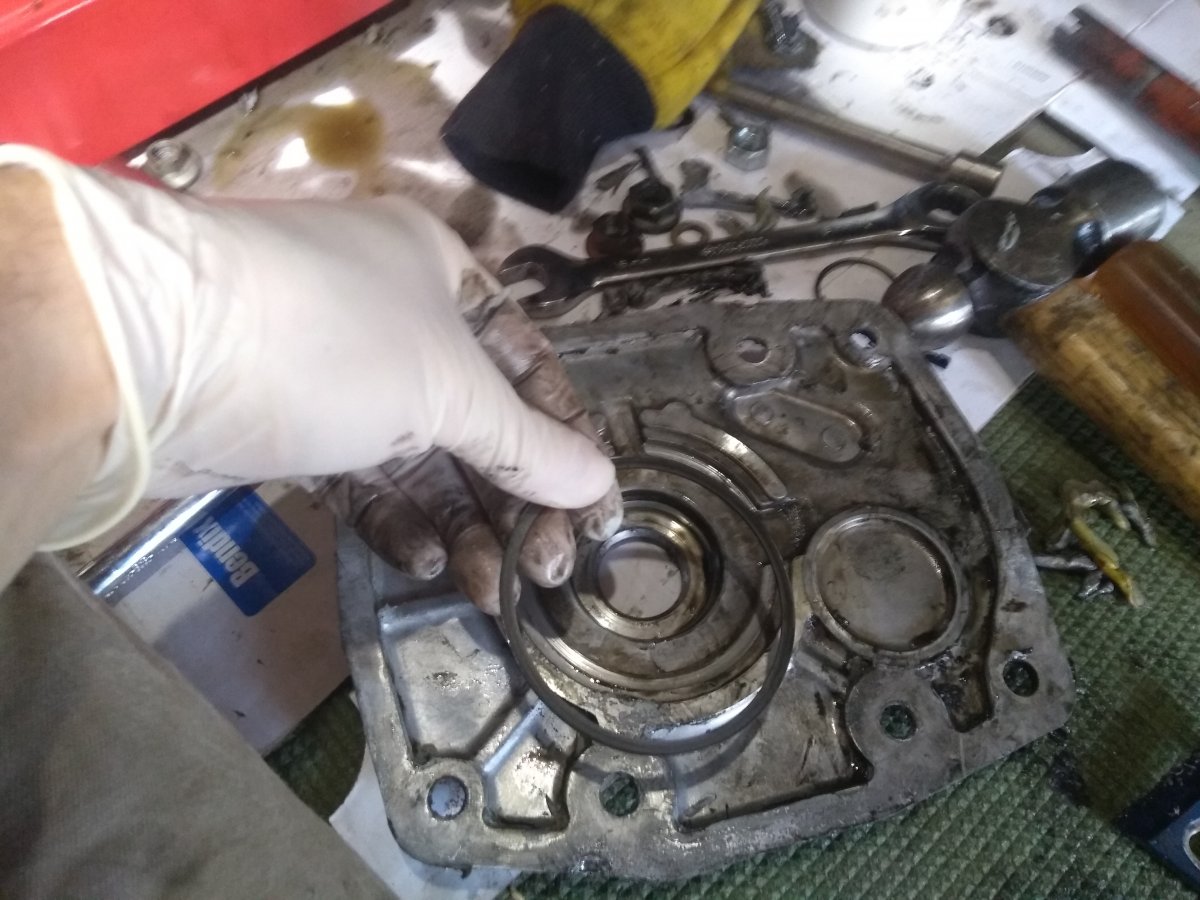

If anyone is following this thread in order to learn how to do this, be careful as there is a spacer ring that goes on the plate and could easily get lost:
35615

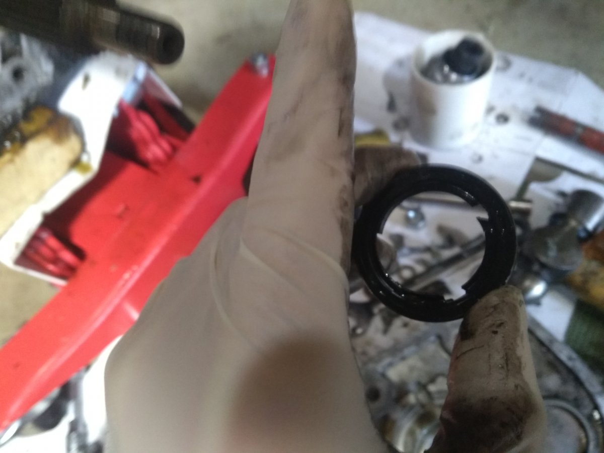

I think its safe to say that the old seal is the problem, it crumbled when I took it out:
