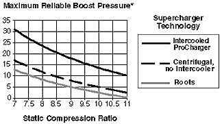

I hope they have a lower compression ratio than the 9.4 you are currently running. Superchargers don't like higher ratios as they make their own. Detonation and pre-ignition is not your friend. 8:1, is good, certainly not more than 8.5.
There is more than one way to skin a cat. Joe Morgan made 400hp on a mostly stock 2.3 using stock injectors (35lb), but he ran two Ford truck fuel pumps. He used nitrous to launch the Pinto.:)shady
compression ratio was thought about for a while, while rob on RPS is running 333whp at 10psi through his stock internals at 9.7:1...with no detonation...and basa was running 9.0:1 and he said it slowed the truck down a great amount...i ffeel that 9.4 will be perfectly fine
as long as you can tune it higher compression isnt a bad thing unless your running huge amounts of boost. Mild boost 9-9.5 cr is good. with a 8 cr and low boost the power numbers would be lower than expected.
Operative words "as long as you can tune it." Higher compression gives a little more low end torque. He is running a positive desplacement blower, not a turbo, so spool-up is not a consideration, and the power should be there.
Lower crs' allow a slightly larger chamber, more space for a heavier mixture charge, plus, he may want to be able to run regular gas.:)shady
yes but unless he is pushing over 9psi on that blower a lower cr isnt necesary. There are a lot of motors that have a 10cr wit hpositive blower pushing 9lbs into them.
Here is a rule of thumb chart. :)shady
