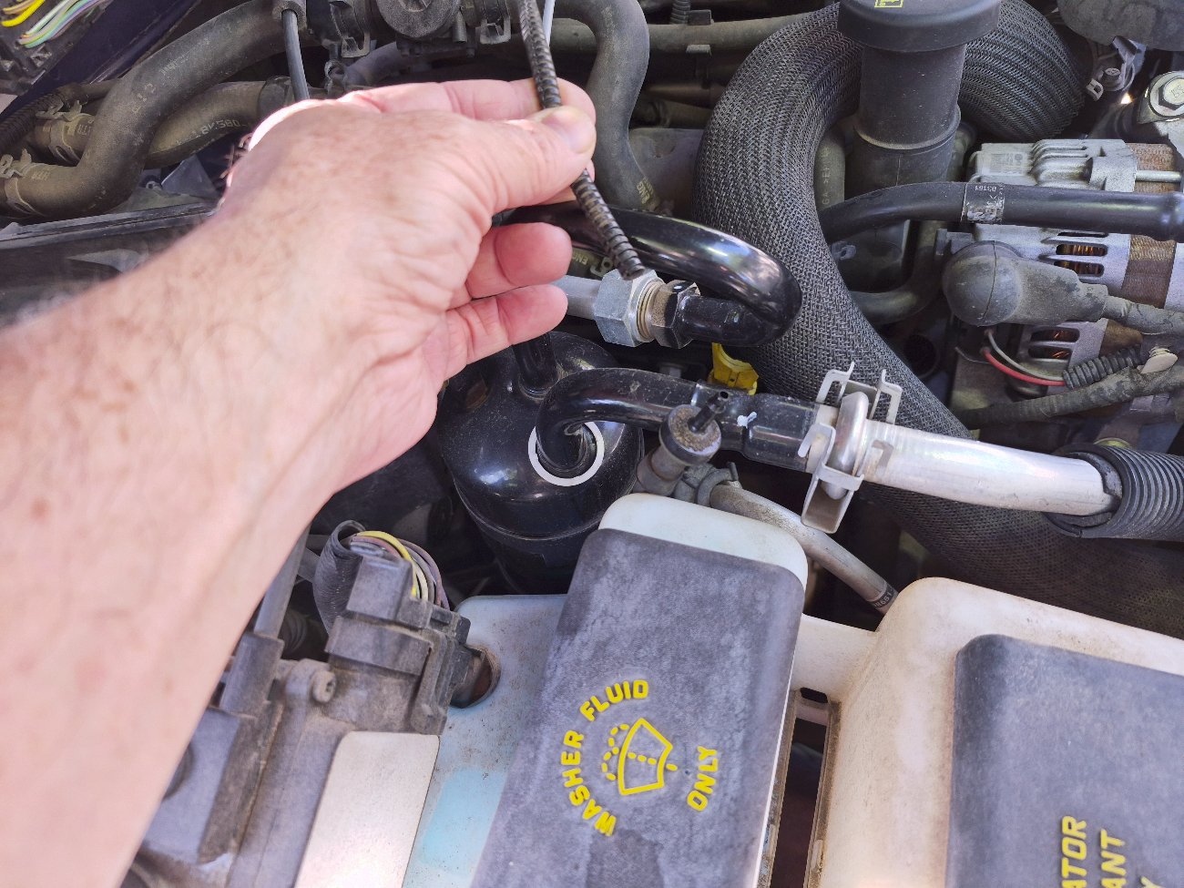

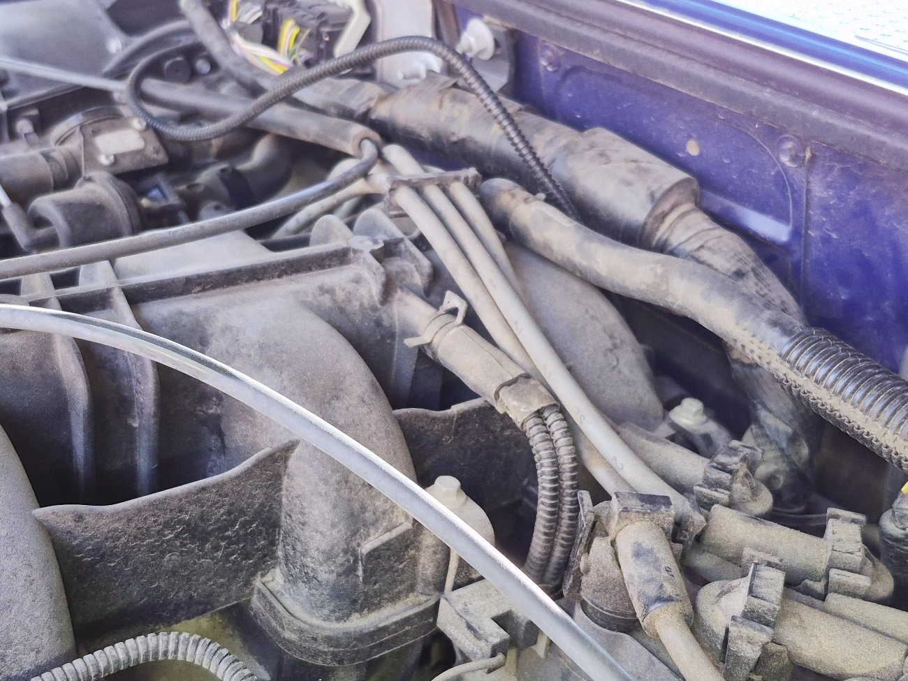

Tons of videos on YouTube though I have not found one that covers my 2011 precisely. The trick it to track down where vacuum line broke, most seem to be on passenger side of engine where it travels over exhaust manifold or right at the vacuum reservoir.
Saw a video where guy described the same issue I had with broken vacuum line crumbling. He had tracked down where it plugged into intake manifold near coil pack. Confirmed same on my truck.
Pics "Source_at_Manifold.jpg" shows line where it attaches to manifold. "Break_at_1way.jpg" shows where it broke at a 1-way valve on its way down to vac reservoir. Looks like it will be easy enough to replace just the broken line. Evidently another common location for breaks in the line running from vac reservoir into cab.
