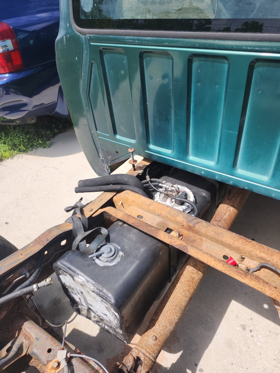

  • Independent Rear

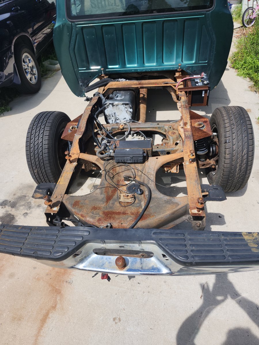

  • Independent Rear

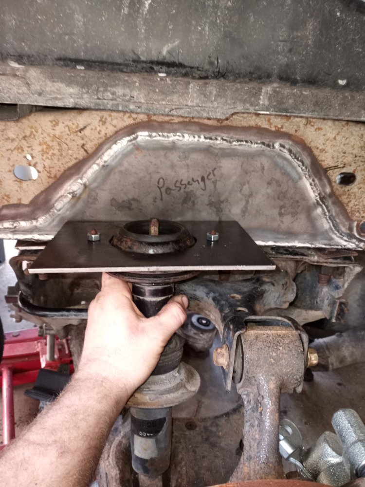

  • Independent Rear

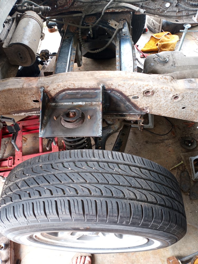

  • Independent Rear

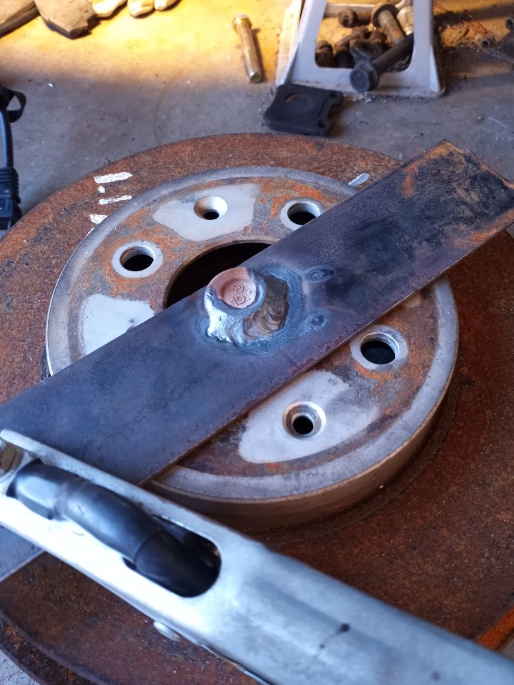

  • Independent Rear

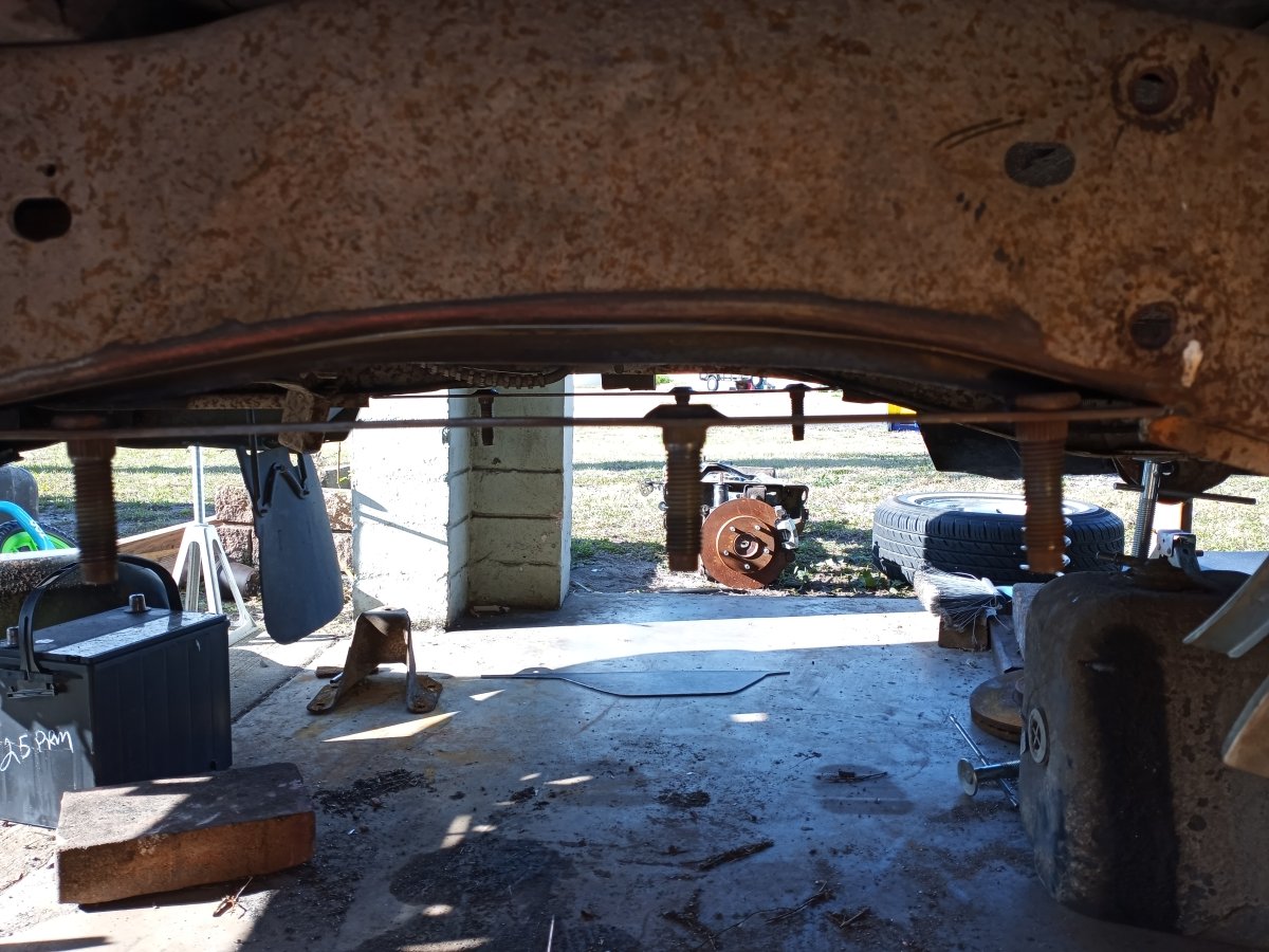

  • Independent Rear
